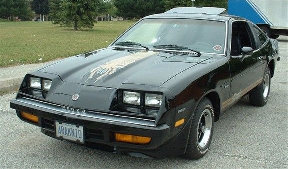

Me too... but the late 70's was this:
Not mine, don't have a pic. Mine was black tho; 262 V8 auto. Did some mods, had a lot of fun in my first car.

Originally Posted by Rob 02
Is that a V8 Monza?
Yep. Had 2 of them eventually. 2nd one I replaced the stock 305 with a 350LT1 4 bolt motor, cam... 4 speed (back then that meant manual ).
Edit; pic now included of 2nd V8 Monza.
