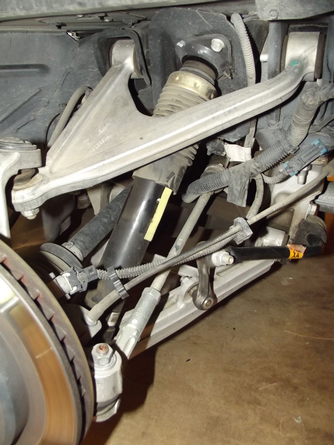

Jack up one front wheel and remove the tire.
Take a look at where the rubber shock boot meets the shock........is there a yellow strap poking out?
Like this ??

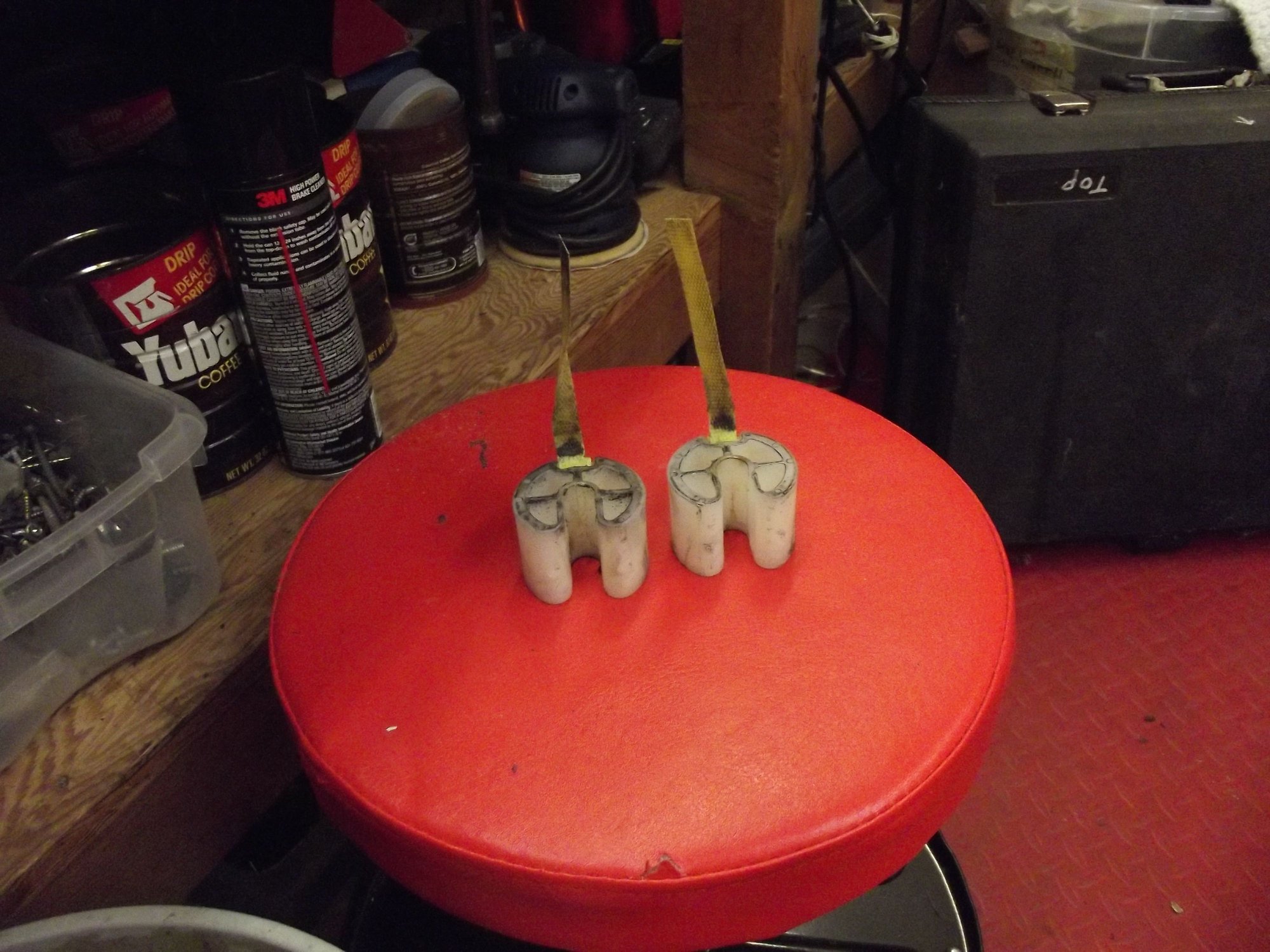

If so, push the rubber boot on the shock up as far as you can and pull on the tab and one of these will come out.
Repeat at every shock

You have to push up the dust boot to see the white spacer, but there should be a strap hanging down.

You won't be able to see the actual white spacer unless the shock's rubber boot is pushed up. But the yellow straps should be visible
While you have the shock's rubber boot pushed up also look for any signs of leaking shock fluid.

Hope it is the stuffers as it is an easy fix.
Bought my 03 last year. 24k miles 2 previous owners.
Drove her back from SoCal to Oregon and wondered why it rode so rough. When I got home I posted up on CF and was told about the "Shock Stuffers"........I went right out and checked and all four stuffers were still installed
After removal, all was well When I posted back on CF many replied that the same thing had happened to them as well. Must have been a lot of dealerships that didn't read the delivery instructions from Chevy.
