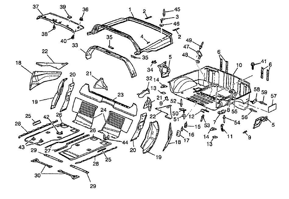

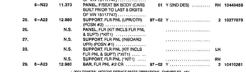

not seeing a part number for it.... #26
but i did find this - GM Part 89023043 -Drivers Side. GM Part 89023042 - Passenger Side

Looking at the photos, the floor pan shin has been breached exposing the Balsa Core of the panel. In the photo with the steel brace going across the panel, that brace has the studs that bolt the seat to the floor.
The brace appears slightly bent and will require at a minimum of some hammer and dolly re-work.
The floor panel is bonded (glued) to the structure using high strength adhesive and to remove this panel, it is possible for the "average garage Mech.
You will need a heat gun and some strong blade putty knifes, (heat the bonded area a pry with the putty knifes.
The Corvette Collision repair manual with details can be found at this link for FREE. http://www.genuinegmparts.com/for-pr...repair-manuals
There are floor pans available from many corvette "recyclers" and on a major e-actions site.
