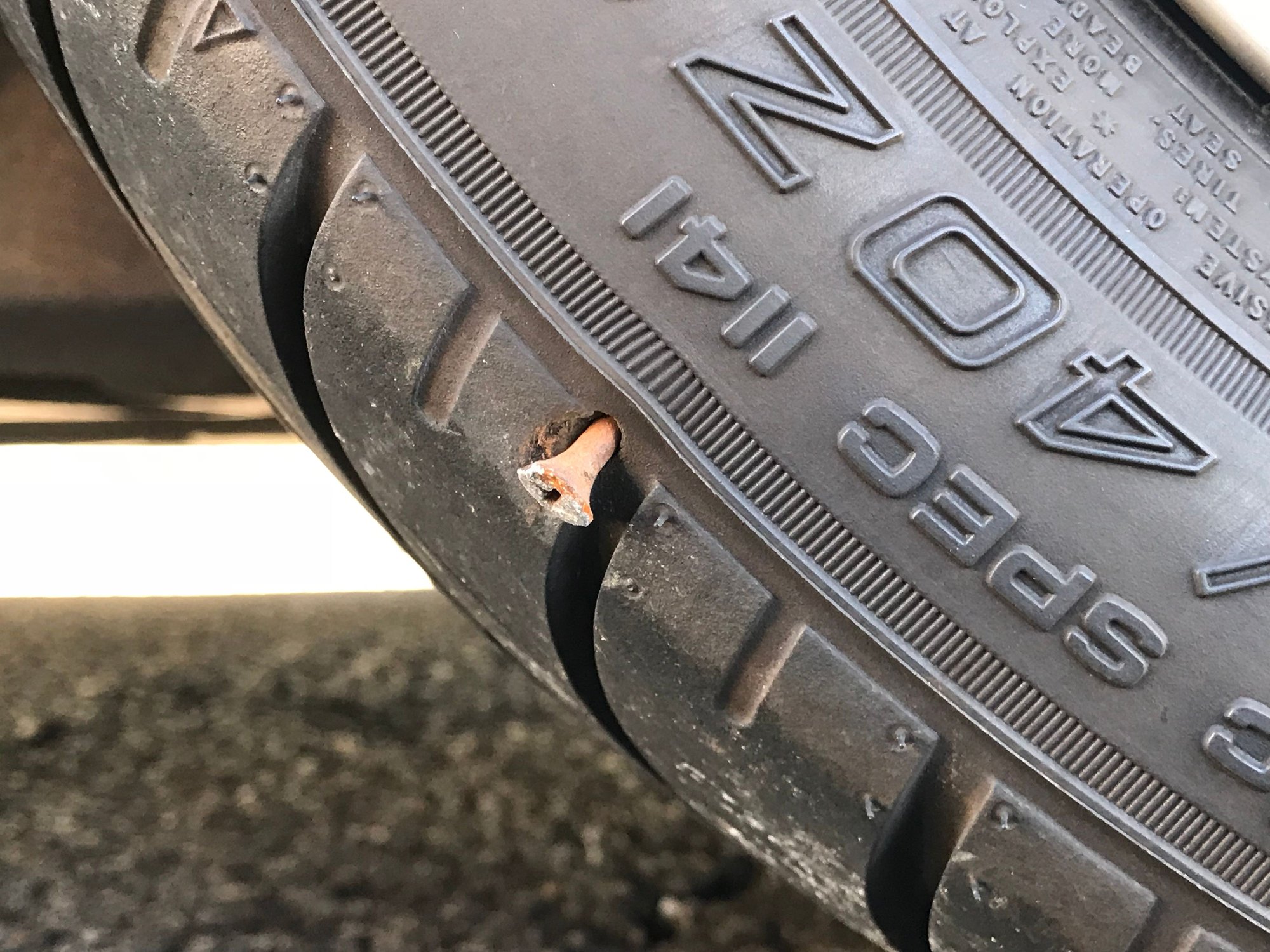

The rubber is good, all around, damn near new. And the rear tires are even newer because I caught a drywall screw in the sidewall!
Goodyear Eagle EMT's are damn expensive! I bet they only had 6K on them. The guy at the tire shop wanted to know why I was replacing the tire (he didn't realize there was a screw in the sidewall).

[QUOTE=DCrooke;1596480164]Udders were drained and cleared when I replaced the wiper motor assembly. Gas filter is a good thought. Thanks.
Did you check date codes on any tires still on the car when you bought it? It doesn't matter if the tread is new if a tire is 5 year old or older, they still need to be replaced for safety reasons.
