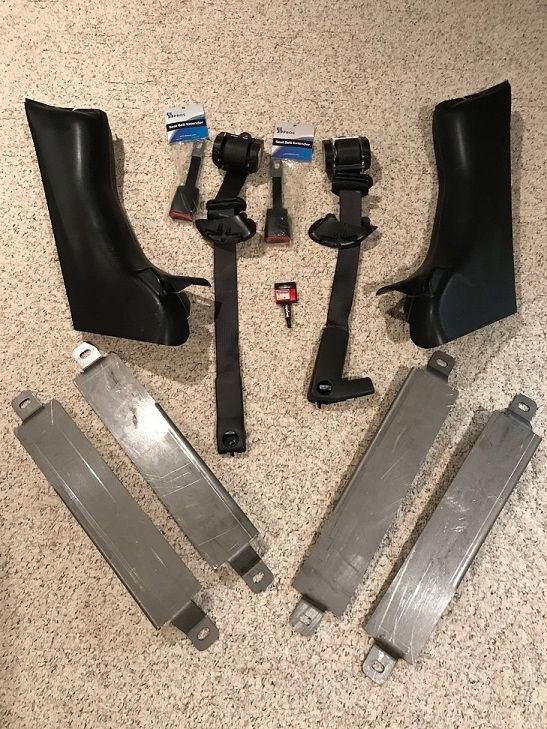

Pieces for the New Seat project have been arriving.
- Marrad Ultra Low C5 Seat mounting brackets, Undrilled and unpainted, Passenger & Driver, $300
- Passenger and Drivers side Seat belt cover trim, $80 for the set
- C6 seat belts, Pass & Driver, $90
- C6 Rigid Seat belt extender/ receptical $32 for the set
- Ultra rare T47 Torx bit, $8
Hmmm, I feel like I'm still missing something.

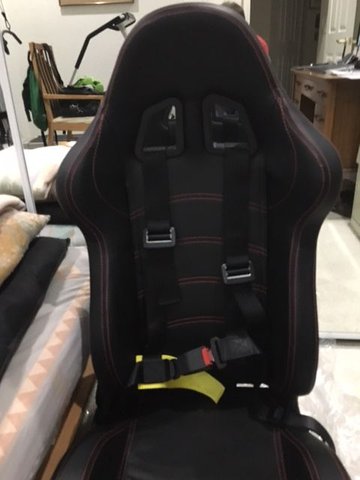

Originally Posted by runner140*
I installed a set of racing seats.....five hours per seat. The seats came with sliders and mounting hardware. Went thru a new electric drill and many parts. The new seat belts were also something else. BUT, the finished product...great.
Any Pics!

Originally Posted by Bossdog
Any Pics!
Nice looking seat!
