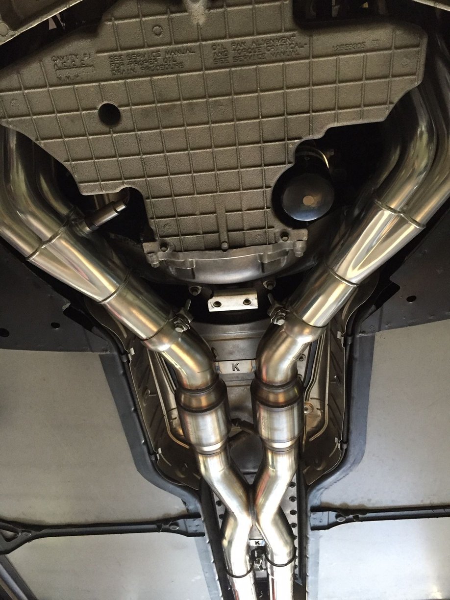

I chose Kooks for fit and ease of installation. I have absolutely no clearance issues with Kooks and the installation was relatively easy, using a lift and having the proper tools. The Kooks headers slipped right into place from underneath without having to remove the starter or lift the engine or undo the steering shaft. Mine are ceramic coated shiny silver. Ceramic coating is essential for keeping the under hood temperature cooler and for a nicer appearance.

Nice looking headers there, Mike.

Thanks Jack.
You cn see how well they fit and with minimal effort.

Mikes setup is pretty awesome in that post
