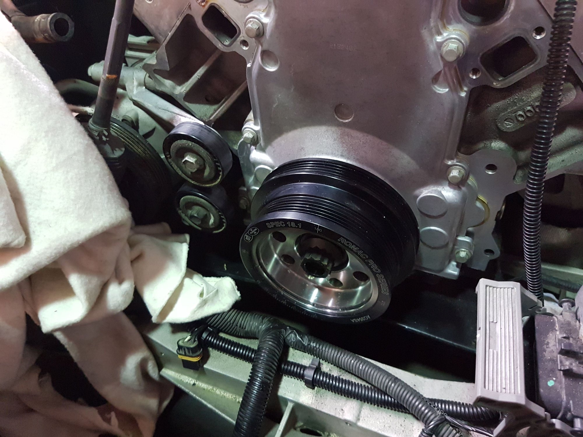

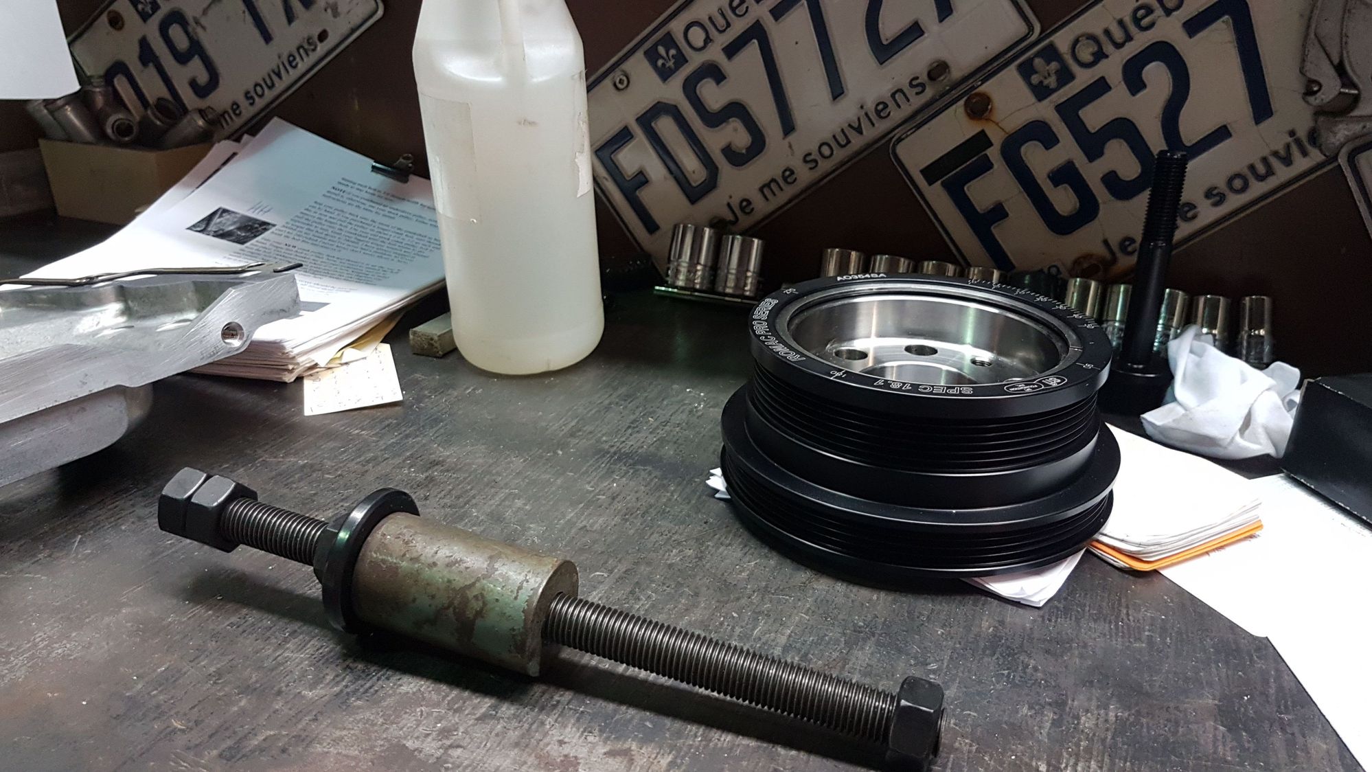

installed
the tool i made to install balancer
To balancer
