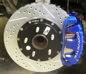

I bought the Duplicolor brush applied kit. Also bought a ceramic clear coat rattle can. After I remove the paint from the lettering, I will go over the calipers with the clear coat. Also, planing to paint the unpainted caliper mounting bracket. I say one example where a guy painted his. I liked it and chose to try it on my car.
Here is the example I referenced. I am doing mine in red:
