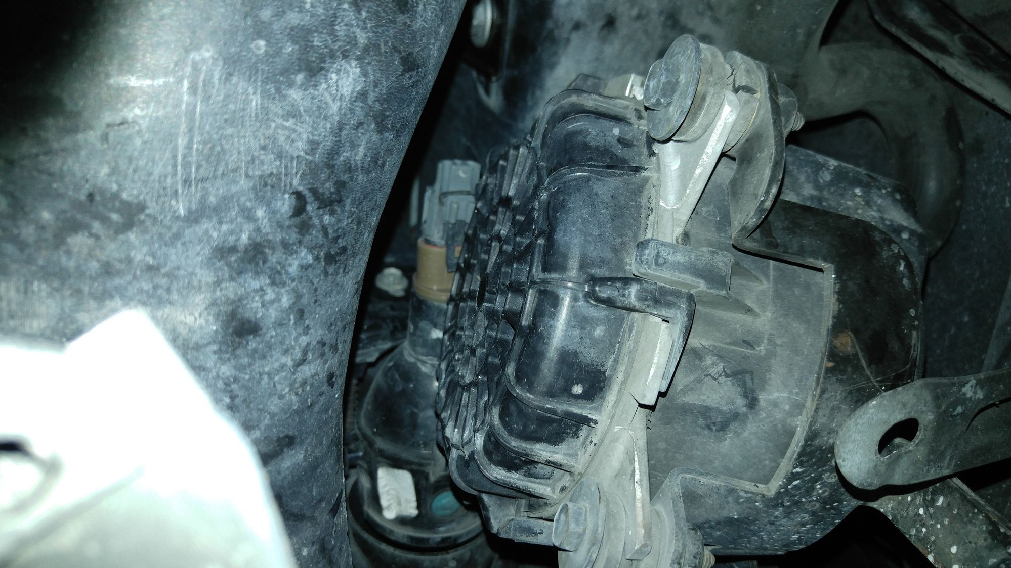

Old Feb 23, 2018 | 12:03 PM
mickfree's Avatar
mickfree
Joined: Dec 2013
Posts: 63
Default picture of black box

That the air injection pump.
ok cool I assume emissions related?
Old Feb 23, 2018 | 09:55 PM
Mike98SilVert's Avatar
Mike98SilVert
Active Streak: 90 Days
Joined: Sep 2002
Posts: 29,881
Likes: 4,537
From: Bonita Springs, Florida
Yes it's emissions related. It's a pump that injects fresh air into the exhaust stream to help to burn any unburned and partially burned fuel in the exhaust to reduce tailpipe emissions. Also referred to as a smog pump or secondary air pump.

Interestingly, that is the air pump of which I mentioned. In my own car I was having problems with the system setting codes so I had the computer tuned to delete it and removed all the components. My car still passes New Jersey inspection.
