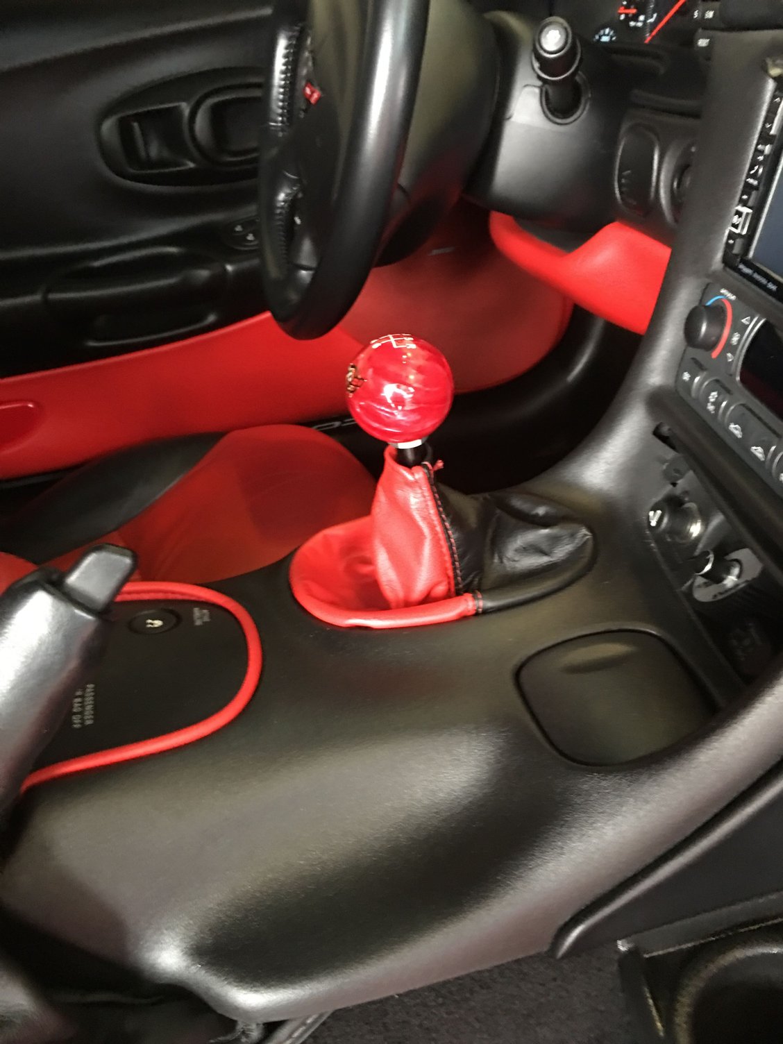

I know this may seem a bit trivial but I am trying to figure out a way for the shift boot to stay up and always in contact with the shift **** instead of drooping down like to does, exposing the lock nut and part of the stick as shown in this picture. Any ideas? An adhesive of some sort?

Zip tie it to the shaft. Don't glue it.
Pull/pop the bottom off the console. lift it up to turn it inside out while on the shifter and zip tie it where you like it at.

My solution was to run to the hardware store and buy a 9/16" inner diameter shaft collar. They come with a set screw in them. Slide the collar on to the shifter, install the boot inside out and upside down, then put on your shifter ****. Then push the boot up against the ****, and push the collar up to sandwich the boot against the ****. Tighten down the set screw on the collar and you are done.

My finished assembly. B&M Ripper shifter, C5R Delrin ****, Redline Goods 1" shorter boot, 9/16" ID shaft collar keeping the boot up...
