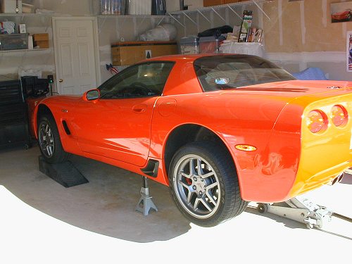

Use the K&N and dont worry about it. Get some UPF44s in advance next time. Speaking of oil changes....guess what tomorrows project is :D :cheers:

Hey kh24,
Where was MY Vette when you took that picture of it?? :lol: :lol:
