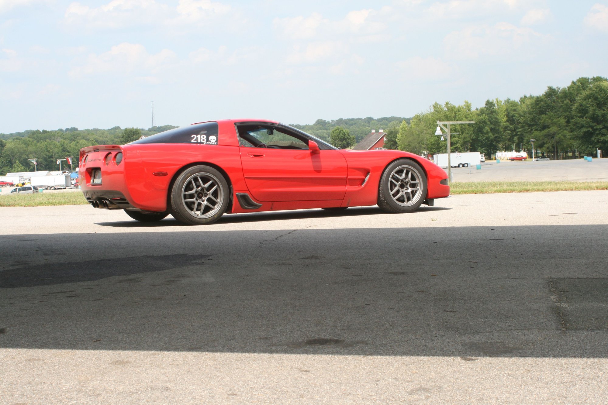

Hi guys!
I was wondering if any of you had the SLP Rear Spoiler installed on your Corvette! If so, please post some pictures!
Also, did you guys only install the spoiler with Double Sided Tape? Did any of you BOLT it on? How well has it been holding up for you?
Pictures below of the Spoiler I am referring to...This car in particular is not mine, just showing it for reference lol
Thank you!!

Yup, I have it. I think this is the one you're looking for anyway. I have mine installed with double sided tape. Been on for quite a few years now. Little tip for the install if you get one, leave it in the sun for a couple hours before so it's more forgiving and pliable. I love the look it gives the car.

A couple of things you should be aware of... I've got the spoiler installed with the 3M tape only, for about 9 years with no problems. You cannot bolt it on; there's no flange that you could attach it to the car. (and no need) The spoiler is amazingly flimsy when you get it out of the box, but don't be alarmed; it's very sturdy when installed. Be careful when installing; the fluid that you need for the tape to bond will is very runny, so if you're not careful, it will leave a permanent paint run. It dries quickly, too. When I installed mine, it didn't come with the fluid, but they may do things differently now. Have a buddy help you just to keep it square, and don't forget to test fit it dry to get the feel of placement. These things look great, IMO.

This 3M Primer 94 doubles the adhesion.
It's like a clear solvent and clean to work with, doesn't get on your fingers.
This can is 20.00 but it's available in small tubes
Here's my SLP
