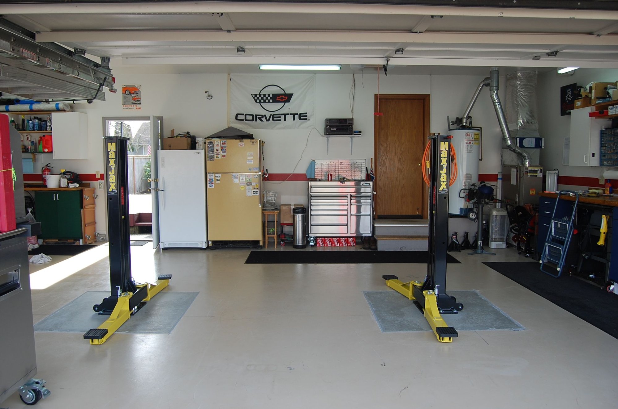

I have the lift that shows on the link the OP provided. It's called a MaxJax. While it's considered "portable" it does require being bolted to a concrete floor. The floor must be at least 4" thick with no cracks in the area where the bottom plates bolt to the floor.
Each post gets 5 wedge anchors (all provided in the kit) that require drilling into the floor and the anchors are installed in the holes. Bolts then attach the posts to the floor.
Overall, it's pretty easy to set up. The instructions are clearly written and they even suggest spacing dimensions to use for installing the posts. The only other thing needed is the fluid for the unit. You can use hydraulic fluid like AW32 or auto trans fluid. The hoses come with a pair of quick disconnet fitting so the pump unit can be moved around or stored away when not in use. The pump is a 110v unit.
It easily picks up either my C4 or C5 raising the car to the top position in about 30 seconds.

I got the lift when it was on sale at Costco. $1999 delivered to my driveway.
The only extra cost was having to replace two sections of the garage floor (the light gray sections in the pic). When I drilled a test hole, I found that the pad was only 2.5" thick and the specs required a minimum of 4". I had a company come out and they cut out two 4'x4' sections of the slab, dug down 12" and poured new concrete. It was a 5000psi mix with rebar connecting the old floor to the new base.
The lift included 3-1/2" wedge anchors, but I wound up using 7" epoxy anchors with the new pour. These anchors were much stronger than the wedge anchors.
