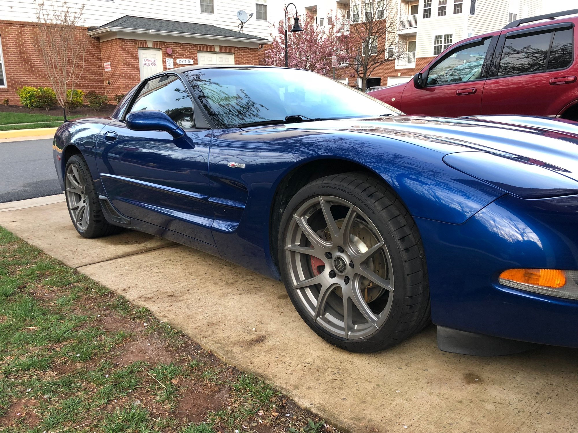

Put these on a couple months ago. Dont have a great picture though. I think fronts are 19x9.5 rears 19x11

They do seem to stick out just a tad, but not enough that its really obvious.
Fronts are 275/30/19
Rears are 305/30/19

Sorry for the big pics. Had a second to run down to the garage for a second a took these. Not great pics but you can see how much they stick out

Thats not bad really.

Nope. If I went with 265 tires on the front I think they would tuck in a little bit more in there. But I think they are right about perfect how they are.
Now I need to lower the car some so its not so much of a 4x4

New pic I took today

Wheels look sharp - I'm considering 19s all around for my C5 as well. Question for you - the fender gap looks larger than stock but I would have thought the larger overall diameter vs stock front 17s (and very close on rear 18s) wouldn't have been as noticeable. Do you have anything else adjusted that affects the ride height?
Or (for the group) is it the red Z06 pictured above lowered?

The red one is lowered or appears to be. My car is stock height
