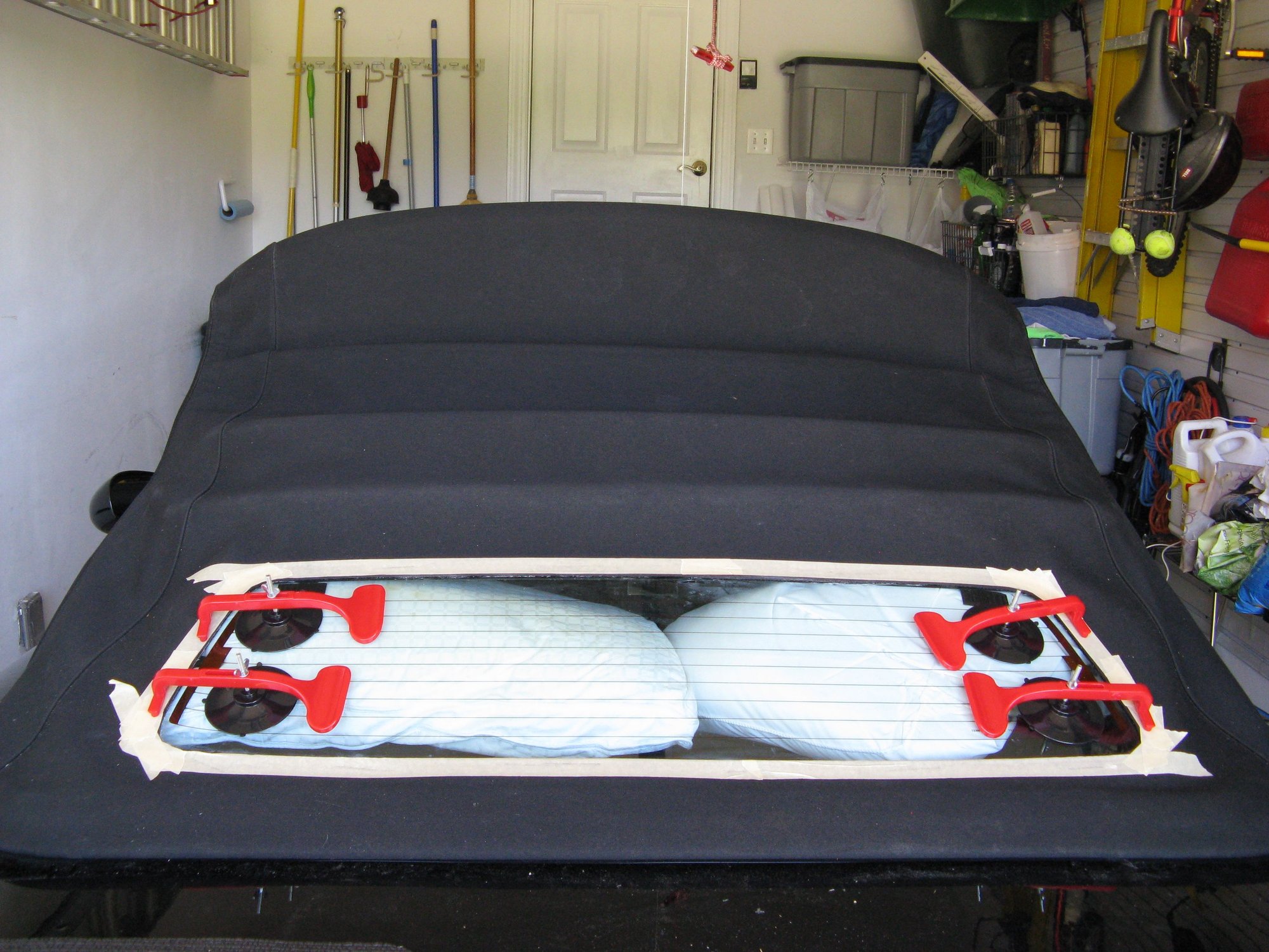

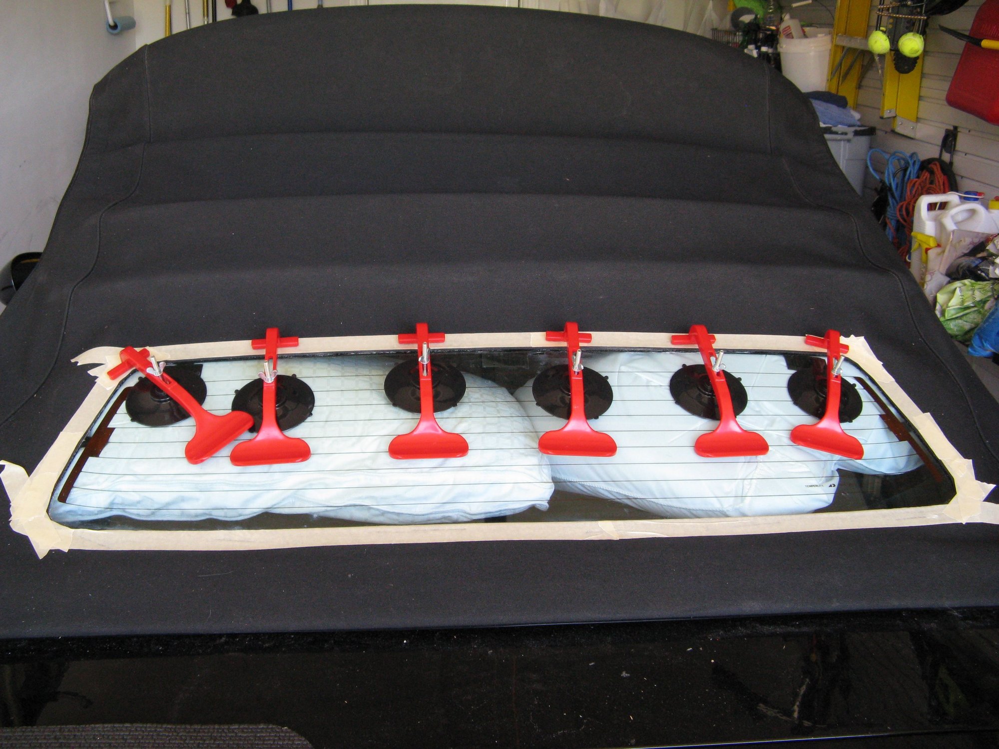

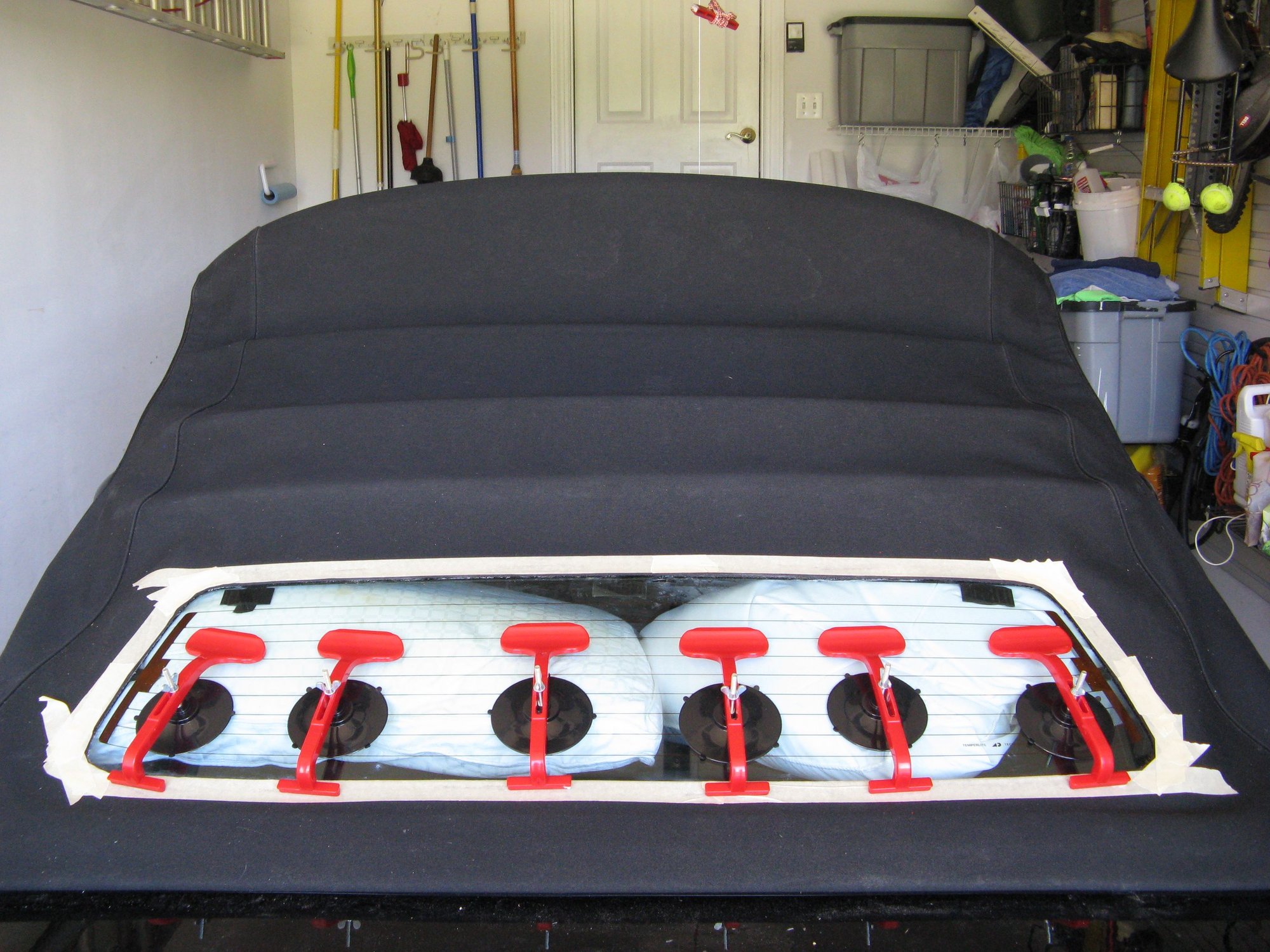

Except for the strap that held the window from falling, mine was completed detached from the top. I glued the window using this procedure. Has been holding great since late summer 2017.

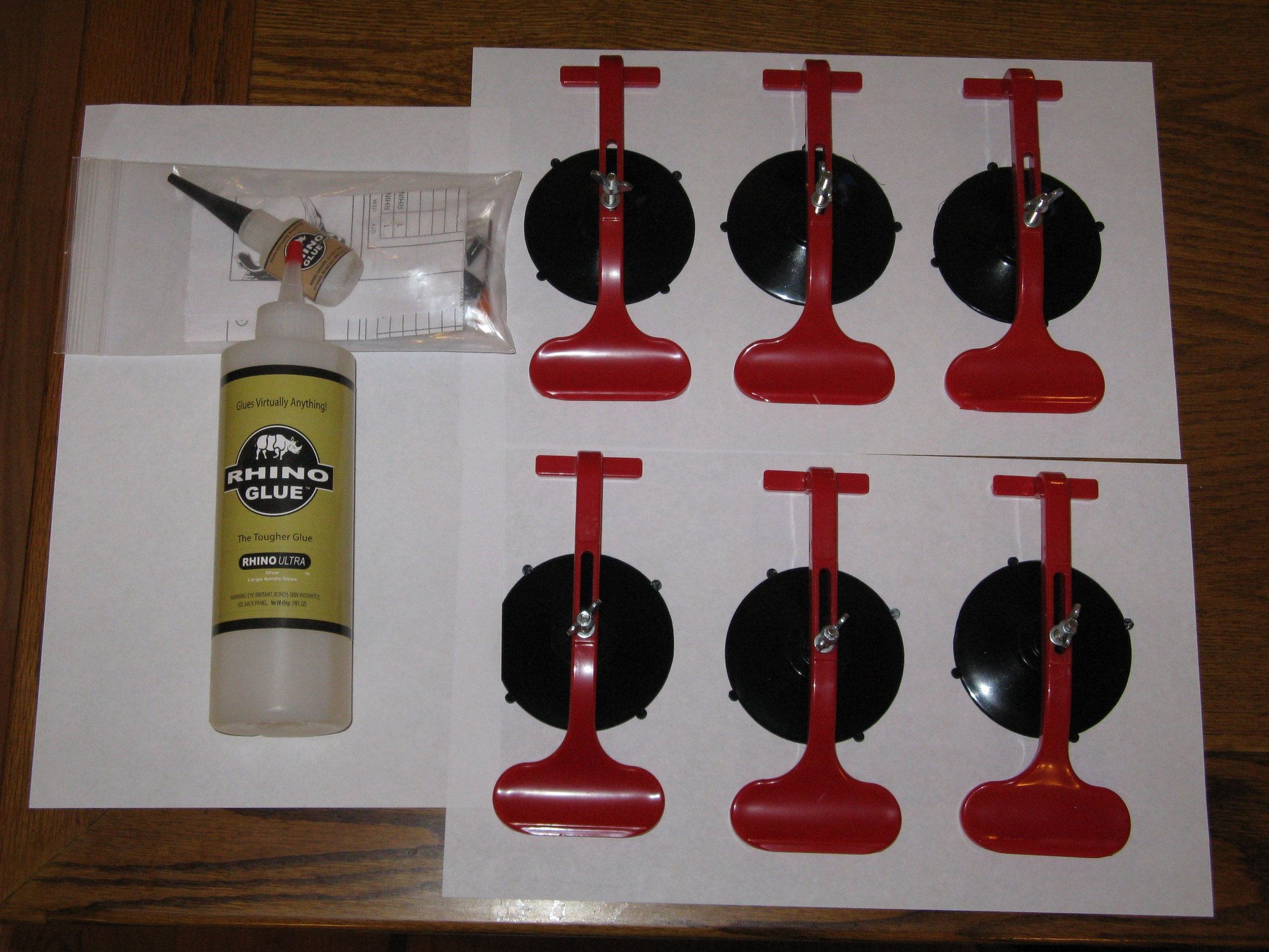

Bought Rhino Ultra Glue and “Universal Vacuum Clamps” (six in a box) on the Internet.

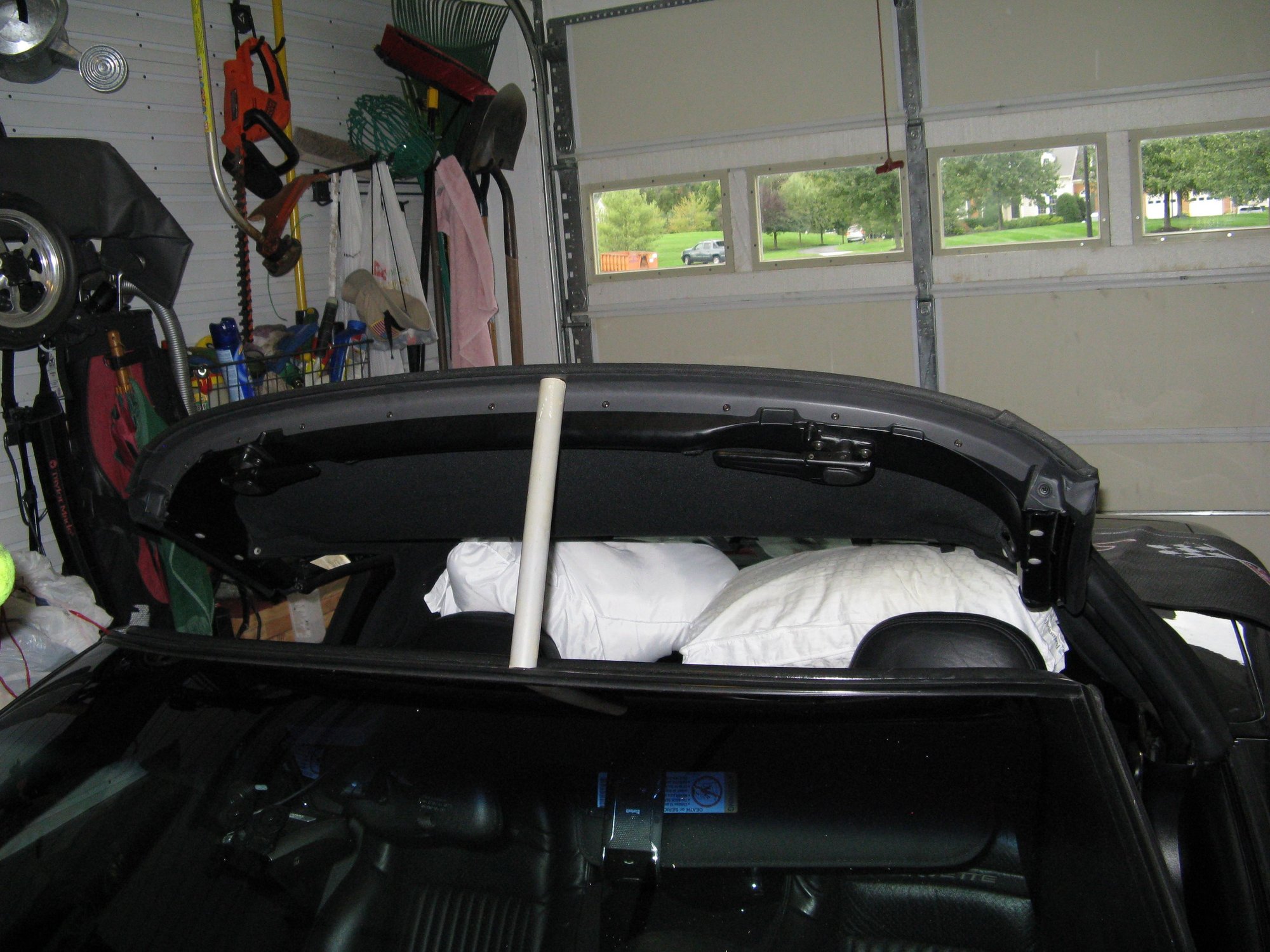

Unlatched the top to loosen the fabric. Supported the top with a piece of PVC piping. Stuffed pillows against the window from the inside.
Removed the old glue stuff from the glass using a glass scraper. Cleaned the fabric and glass with rubbing alcohol and glue remover. Masked the outside fabric as a protection against any glue run off. Glued glass top first using all 6 clamps. Clamps stayed on for 12 hours for each application.
The two sides were done next.
Last was the glass bottom.
