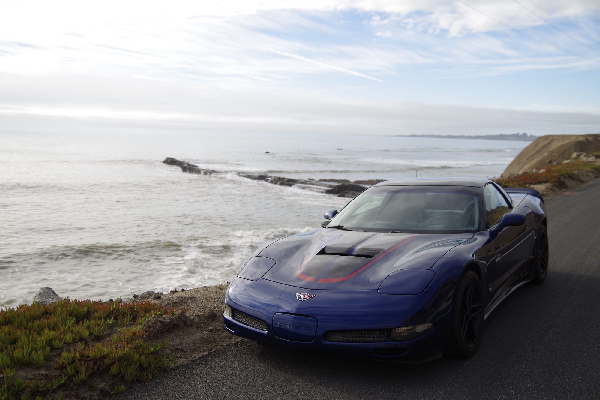

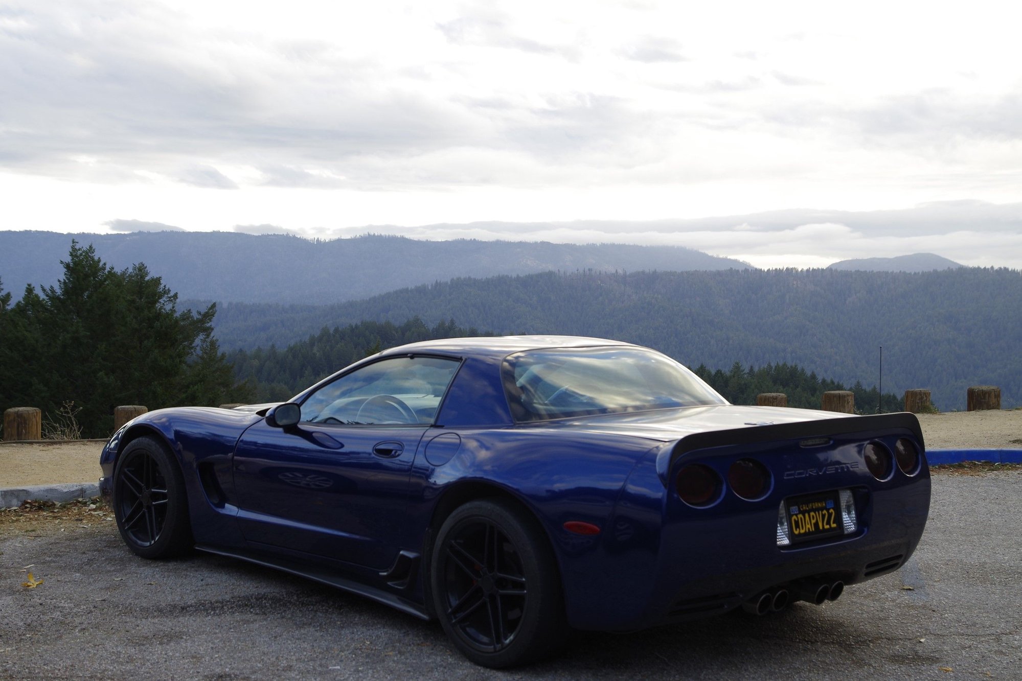

I'm so used to them I always forget it's modified.
