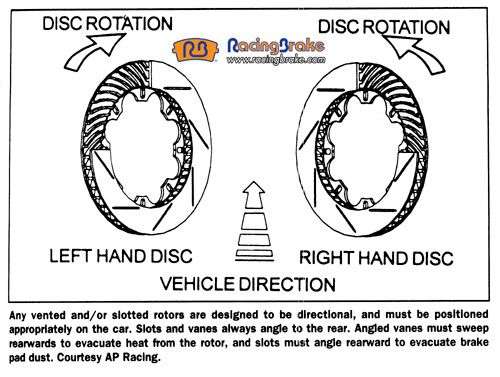

And you're right. If the vanes are directional, there should be a left rotor and a right rotor:
