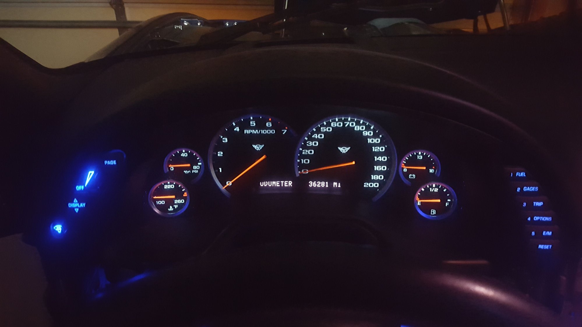

Hi,
I have the LEDs in mine. They are brighter than the stock bulbs but are dimmable.

Old May 5, 2018 | 09:46 PM
Posts: 368,383
Likes: 24,790
Originally Posted by knewblewkorvette
The LEDs in your car look great.
