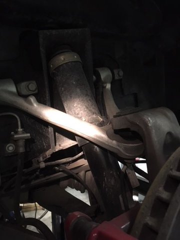

While I had my 2000 base coupe on a hoist for the first time, I thought I’d check to make sure the shock stuffers had been removed. My shocks don’t have an accordion type rubber boot that would lift out of the way, it’s more like a solid cover. Since the cover doesn’t seem to be removable I’m "assuming" there were never any shock stuffers in there in the first place. Or am I missing the boat somehow?

Only the cars that had magnetically adjustable shocks had the stuffers.

2003-2004 cars with the F55 option had the shock stuffers.

Thanks. It does have mag ride shocks, but being a 2000 I believe they’re the f45 shocks, not f55.
You are correct
