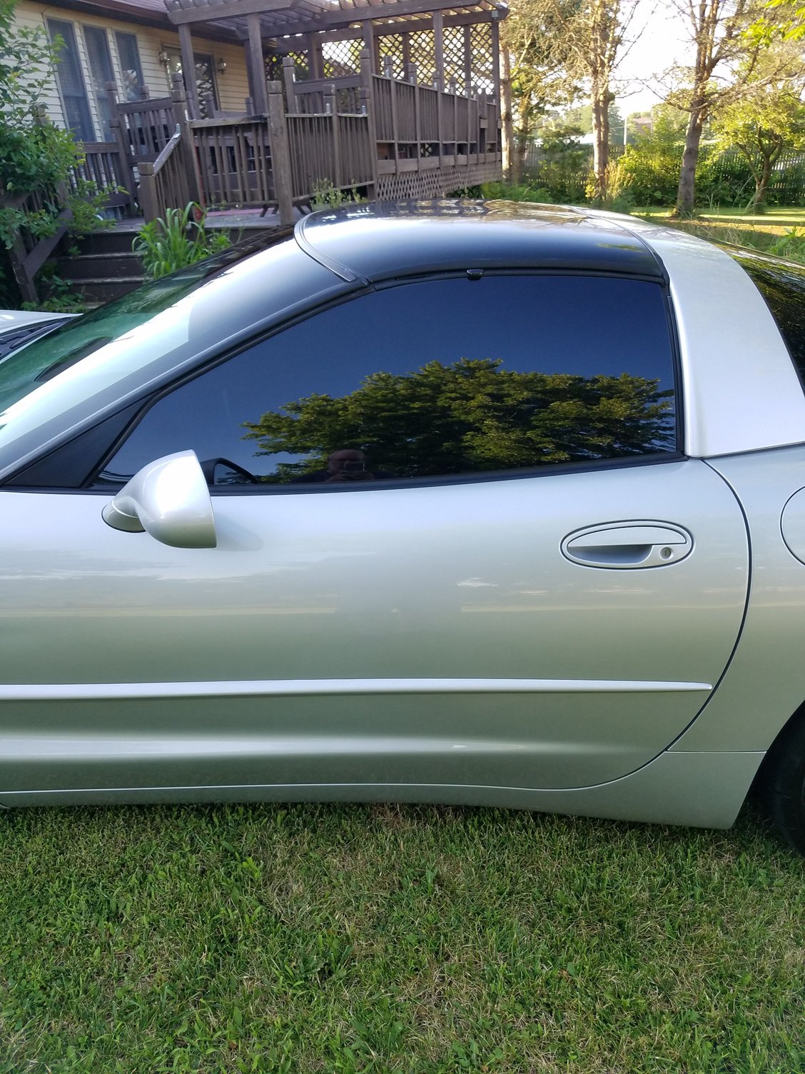

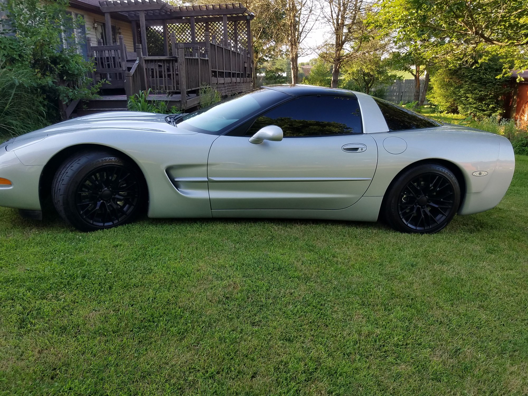

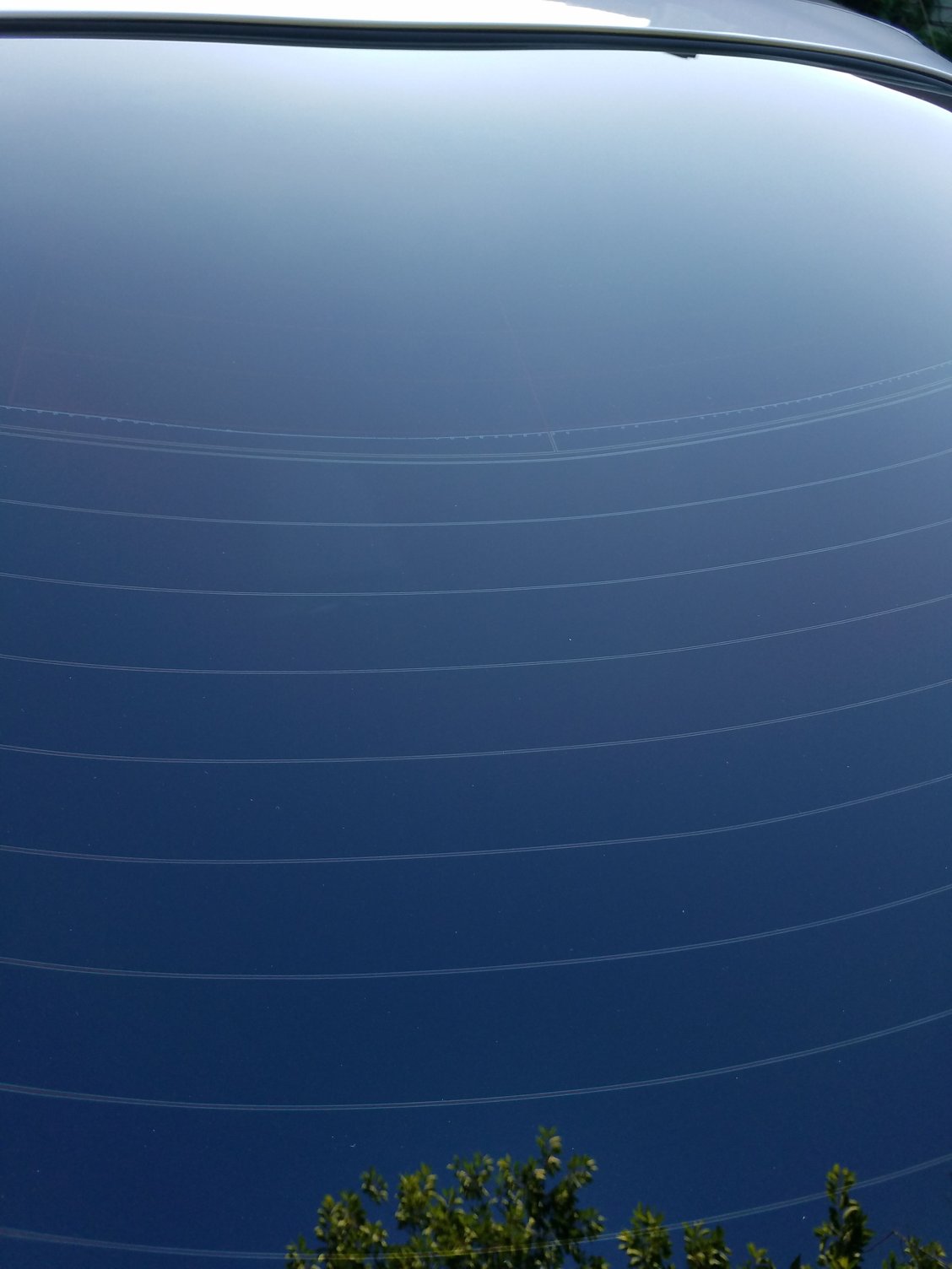

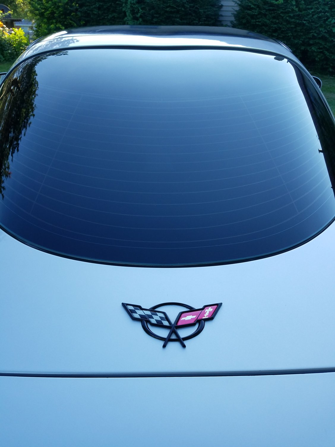

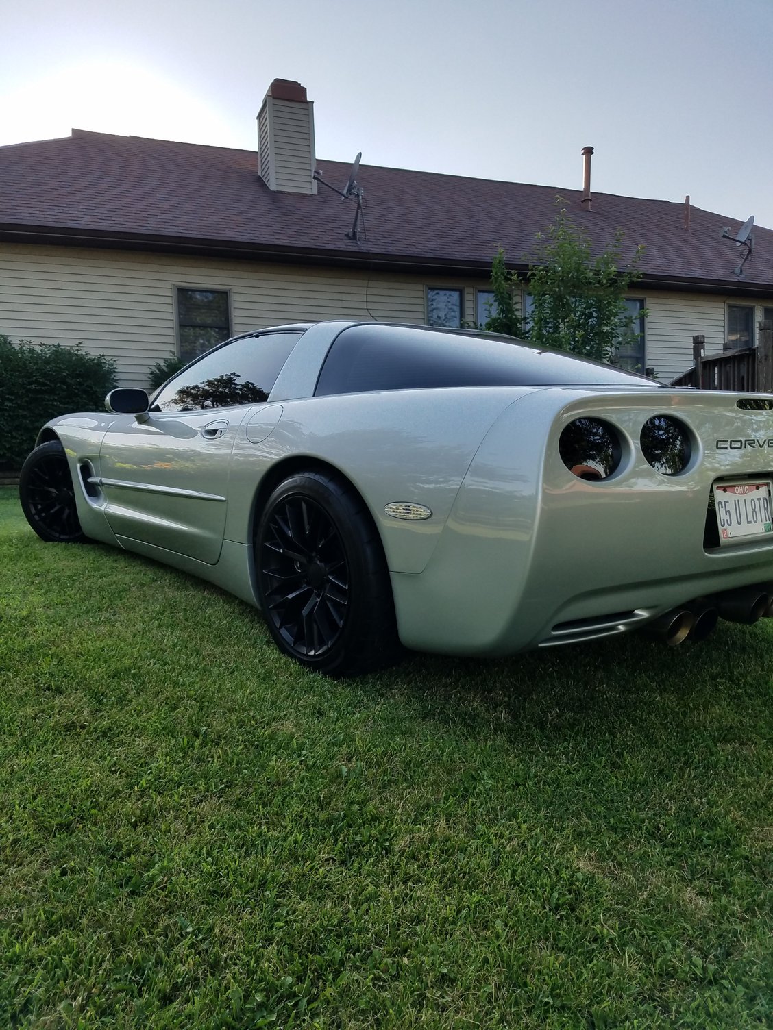

No. He applied the vinyl then went tint down from the vinyl
He took his time and it looks FANTASTIC
I went 5% on tint, You can see the difference between vinyl and tint but I think I made the right choice and it doesn't stick out like a sore thumb
The vinyl follows the contour of the dot matrix
I also did a visor on the front windshield in 5%
Nice and dark inside but I can see better than I thought it would be lol
