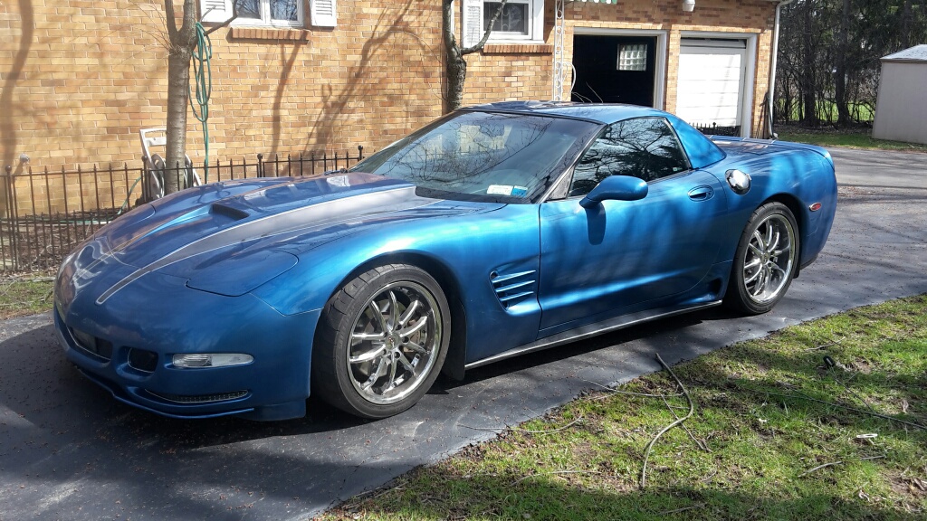

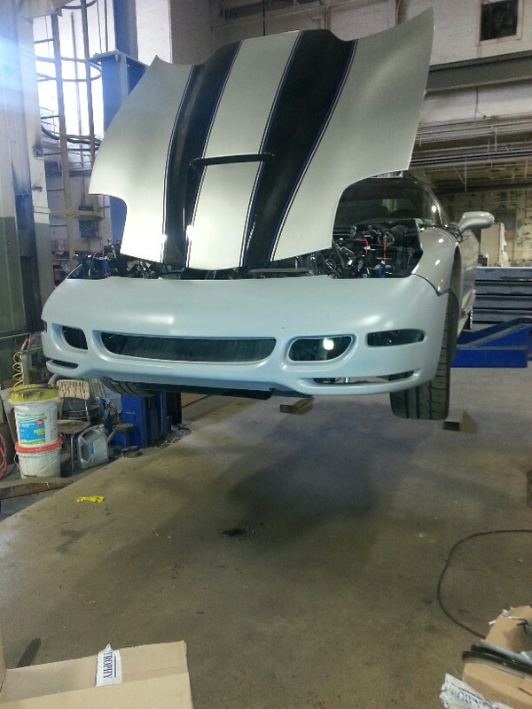

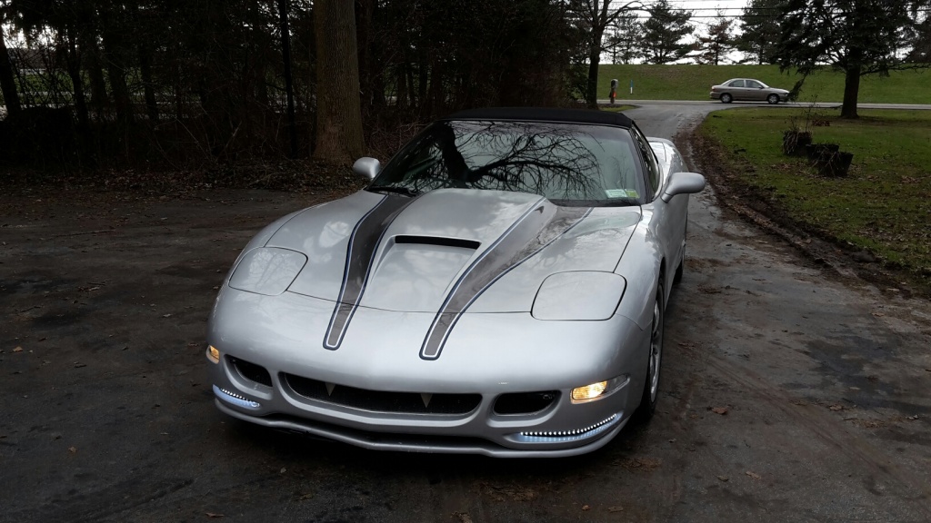

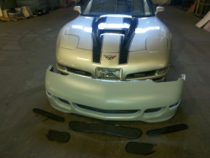

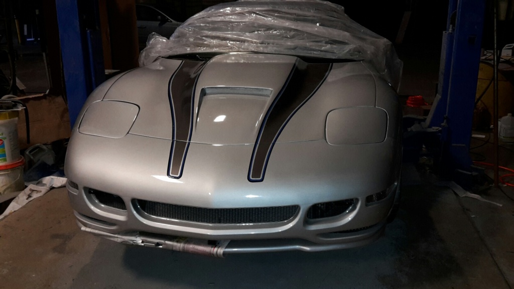

The Starcraft Urethane fits like OEM.
All the Duraflex fiberglass one's are a horror show.
I ground the foam down for a better fit

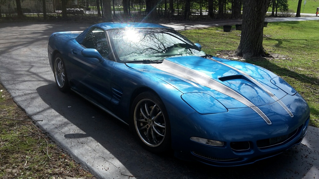

That is one good looking front end. The back is nice as well, just not quite as good.

The higher up plate and the bigger lip makes the back end look taller and narrower like a ducktail IMO

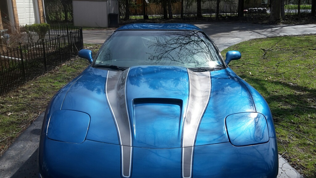

That looks FANTASTIC! I am putting a PD supercharger on my 03. The improved air flow to the intercooler would be a huge benefit and I do not like the look of a hole in the License plate filler. Does the Aero of the car get affected by the new front? I am also IN LOVE with the hood. Can you elaborate on it? Who makes it? Use stock hinge / latch? How much higher is it?
Really sweet look you got going!

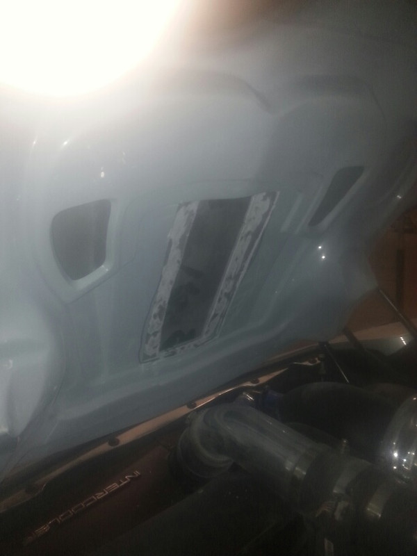

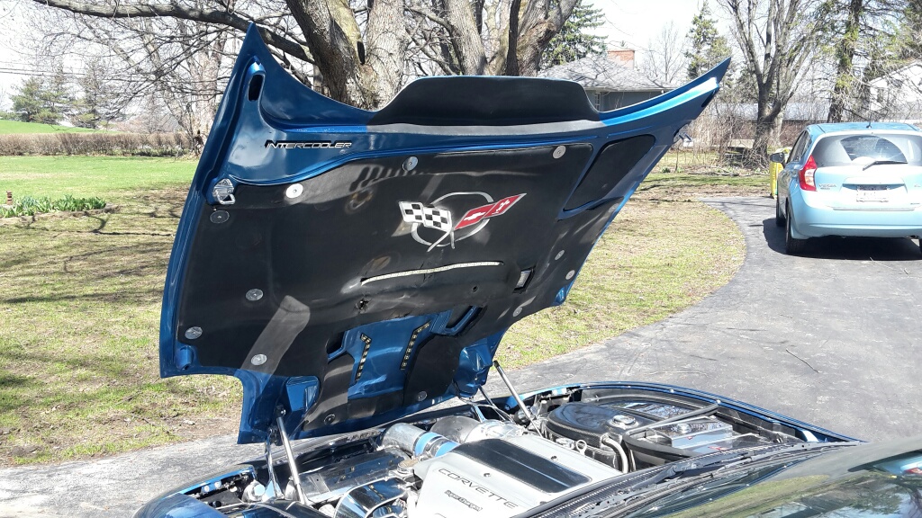

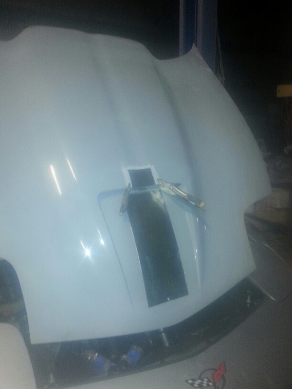

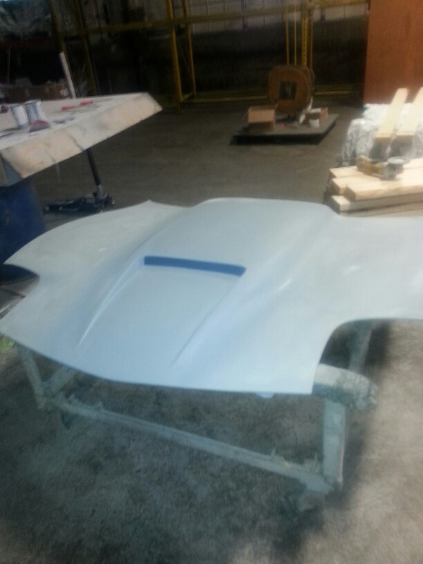

It's an RK Sport hood
https://www.ebay.com/itm/Chevy-Corve...dvHi:rk:2:pf:0

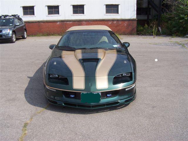

I modified to look like an SS Camaro.
I fileted the sides to give it a tighter fit.
I have stock chromed hinges
Fits good but sticks up a bit on the passenger rear side
Driver side is better
I wanted more room for my SC pipe so I got rid of the cameltoe before the scoop
and filled it up with bondo on the rest of it.
The scoop for the intercooler comes out past the bottom
