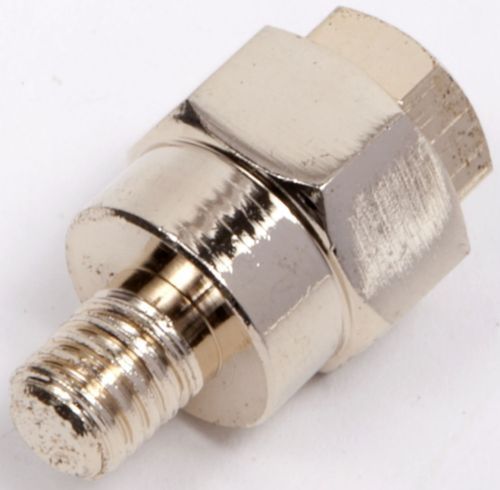

I use these sidepost replacement bolts that are available at my local O'Reilly's.
https://www.oreillyauto.com/detail/b/super-start-4986/battery-accessories-16452/battery-accessories-16508/battery-terminal---universal-17657/393e97768e9a/super-start-battery-cable-bolt/01411/4742214
They use larger size wrenches to tighten down, and are great for attaching accessory wires for trickle chargers, stereo amp, etc. The smaller bolt on the end will come off without the need to disconnect the main terminal bolt from the battery. (Just be careful not to drop it. I've done that twice and never found them.)
You just have to be careful not to overtighten them, which is a lot easier to do with the larger wrenches. Remember, your screwing them into lead.

[QUOTE=lewislgZ06;1597825747]
I think I'll give this plan a try.

You can use a stud, and replace the side terminal bolt with a nut instead. The stud will go deeper into the battery to give you fresher and more threads, until it comes time to replace the battery again, at which point you can return it to oem if you so desire.
Bingo! - I think.
I bought the above positive terminal replacement bolt. It's a nice idea but the threads are too short.
The root of the problem was the original Delco battery that inconspicuously leaked (like 14 years ago). I had to replace the positive wire terminal with a Pep-Boys model. It's a little thicker I guess.
After realizing that the replacement bolt was still too short I went to my Pig Pile of Bolts ...and after much searching found a good length and the right thread size. I had to use a couple of washers to take up a little space but it secured nicely. (and there was much celebration) It's working well now.
