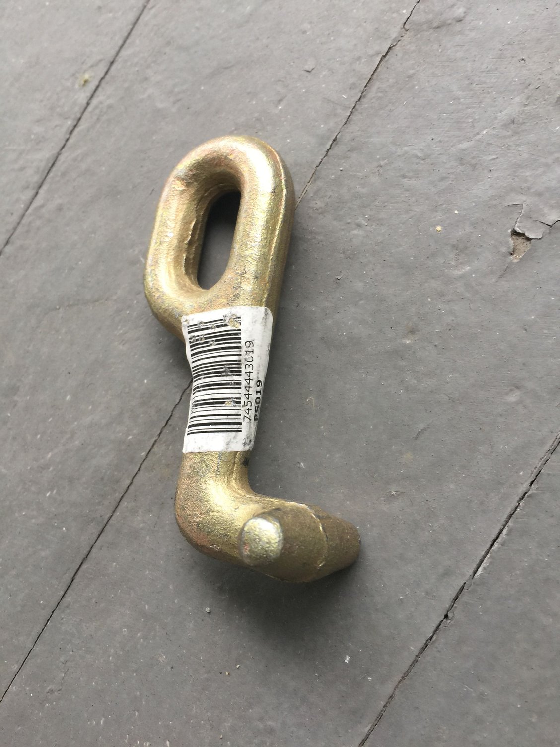

Originally Posted by cruzbox
where did you get the hooks from? Thanks
I bought them at Harbor Freight. I can take a photo if you need it.
Old Sep 3, 2018 | 07:15 AM
cruzbox's Avatar
cruzbox
Joined: Aug 2018
Posts: 128
Likes: 14
Default Harbor freight
A picture would be good and would you have a part number also?
Thanks cruzbox
Old Sep 10, 2018 | 12:13 PM
laurent_zo6's Avatar
laurent_zo6
Joined: Aug 2013
Posts: 2,491
Likes: 315
St. Jude Donor '15-'16-'17-'18-'19-'20-'21-'22
Thanks cruzbox
It's been too long since I bought them so no idea if the numbers on the item are still valid.

Default Thanks
Appreciate the pictures, thanks again.
