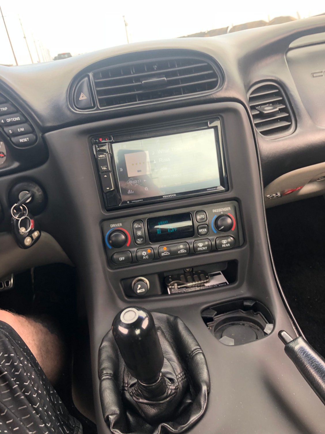

Bezel included under 500 shipped brand new full package with everything needed

its a kenwood head unit with all the modules needed to keep stock speakers, and add an amplifier if you wanted to. I am running new rockford speakers that i swapped out the rears and 3" but i left the 8" bose in there. Louder than stock by far, rear speakers are loud on their own now, clean crisp highs/mids I dont believe in lots of bass from door speakers it just causes distortion and blown speakers but if you wanted a sub you could add one. 6.5 or 8" is all i would opt for. (Ive had 25,000+ watt systems in my previous cars)

I ripped it all out and it was very expensive to build it up again with below parts and a Gladen 4channel amplifier and the Vettenuts 10” cornersub JL, something like 3000 usd i do not think it was worth the money after all but it sounds very good.
Vettenuts panel almost finished, looks like stock the panel and very good fit, 7” had to cut a little bit in it to clear the ooeration of door to stereo, HU is Kenwood touchscreen mirror link backkamera and so on
Gladen 3 way system with active filter, Metras speaker plate, door is insulated also behind the speakers.
