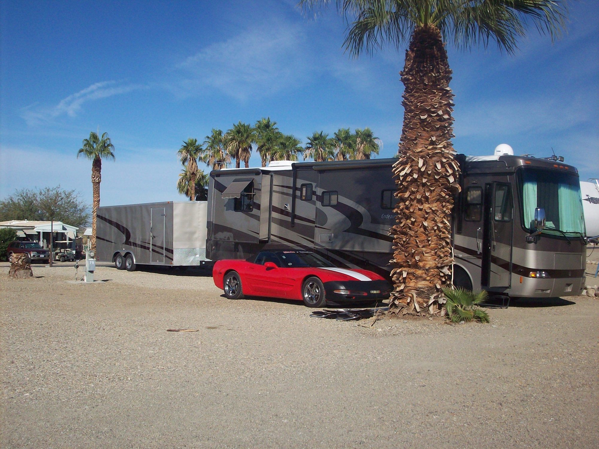

Does anyone have a trailer for their Vette? We travel some in our motorhome and would like to take ours with us. I know it would take a fairly dedicated trailer because of the low ground clearance. Any ideas on brands and cost?

I bought a Forest River 23' enclosed trailer for touring the country for over 3 years. It had leaf springs so it sat lower, no problem.
