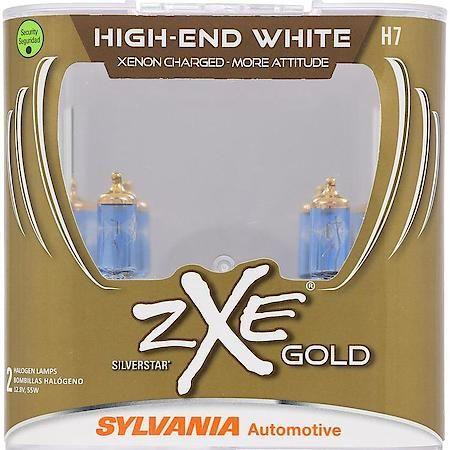

so I’m like the rest of the c5 owners who think the headlights suck looking at just changing the bulb any one ever try these

they will be whiter in color but as far as improved performance....no

Tinting always diminishes light output, so your light performance will be worse rather than better.
