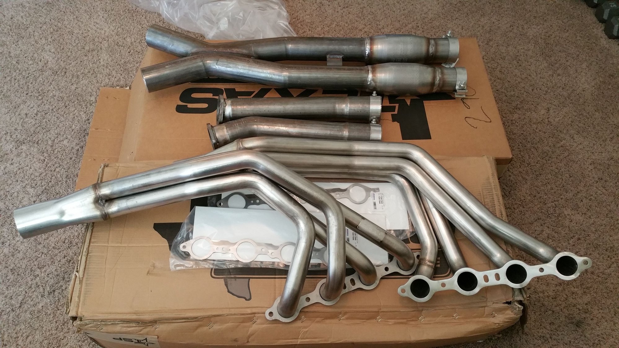

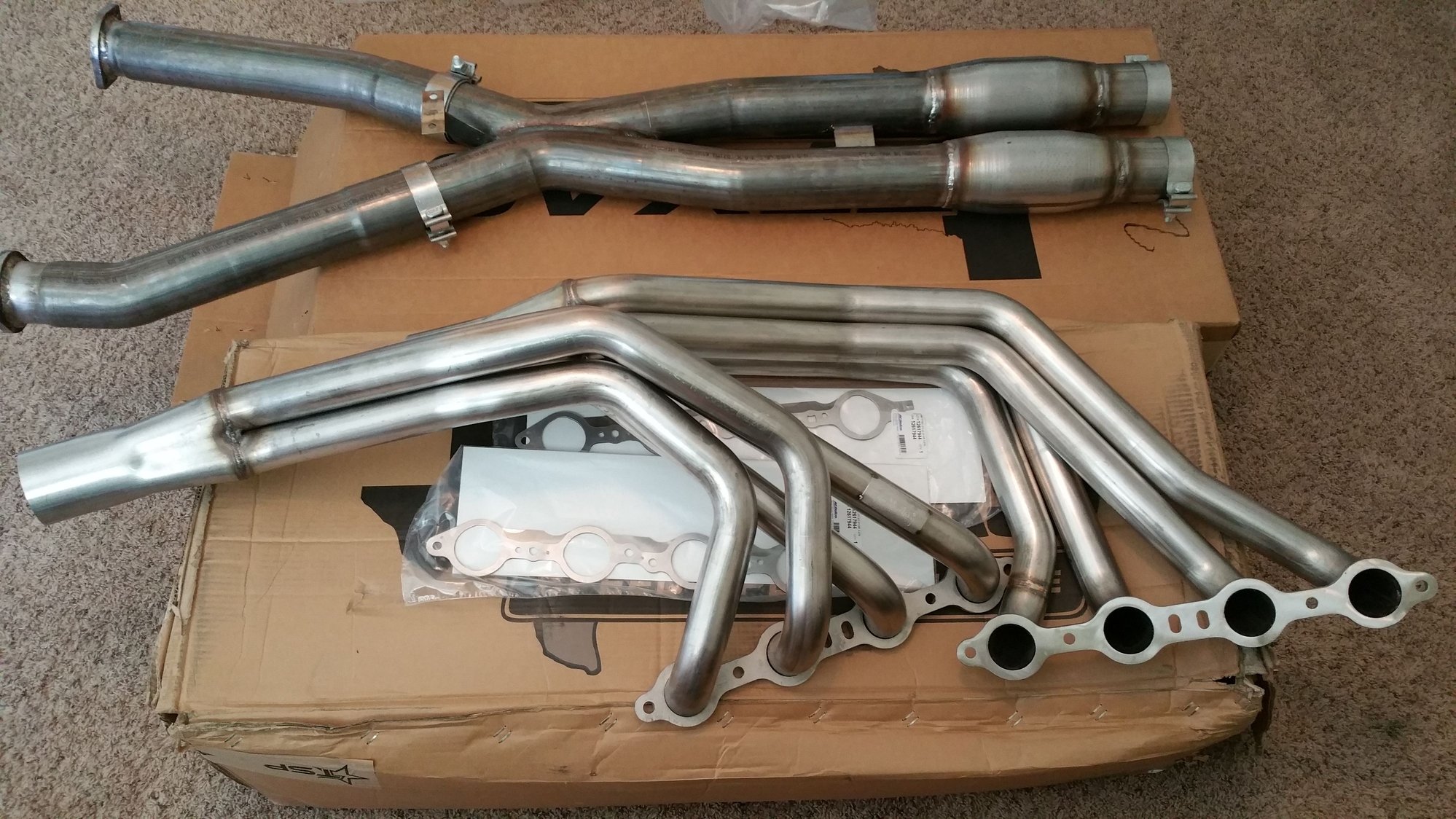

I had a set of Texas Speed headers on my 02 Z06. I know they were made in China but for the price I decide to try them. They were/are very well made for the most part. But they did have fitment problems. I could never get them adjusted so that they did not cause my stock Z06 catback to rub on the side when I made turns. Might have been that my car and the combination of those headers just did not go together good or I got a bad set. Others have had good luck with them.
I uninstalled them and sold them and put on a set of American Racing headers. Perfect fit. But I do kind of regret it.
With AR, you sure as hell pay out your **** for them. And you will be waiting at least 6 to 8 weeks for AR to get off their asses and make them. Realistically, there is no justifiable reason Kooks, AR, LG, etc. cost as much as they do; American or not. They are pipes with a minimal amount of welds to hold them together and a couple of flanges.
Honestly, if I did it over again, I probably would have returned the Texas Speed headers and gotten another set of the same.
Regardless of what you get, definitely get them ceramic coated. If you don't, you will cook the hell out of your wire harness especially on the passenger side of the engine.
Here are a few picture of the Texas Speed headers I had:

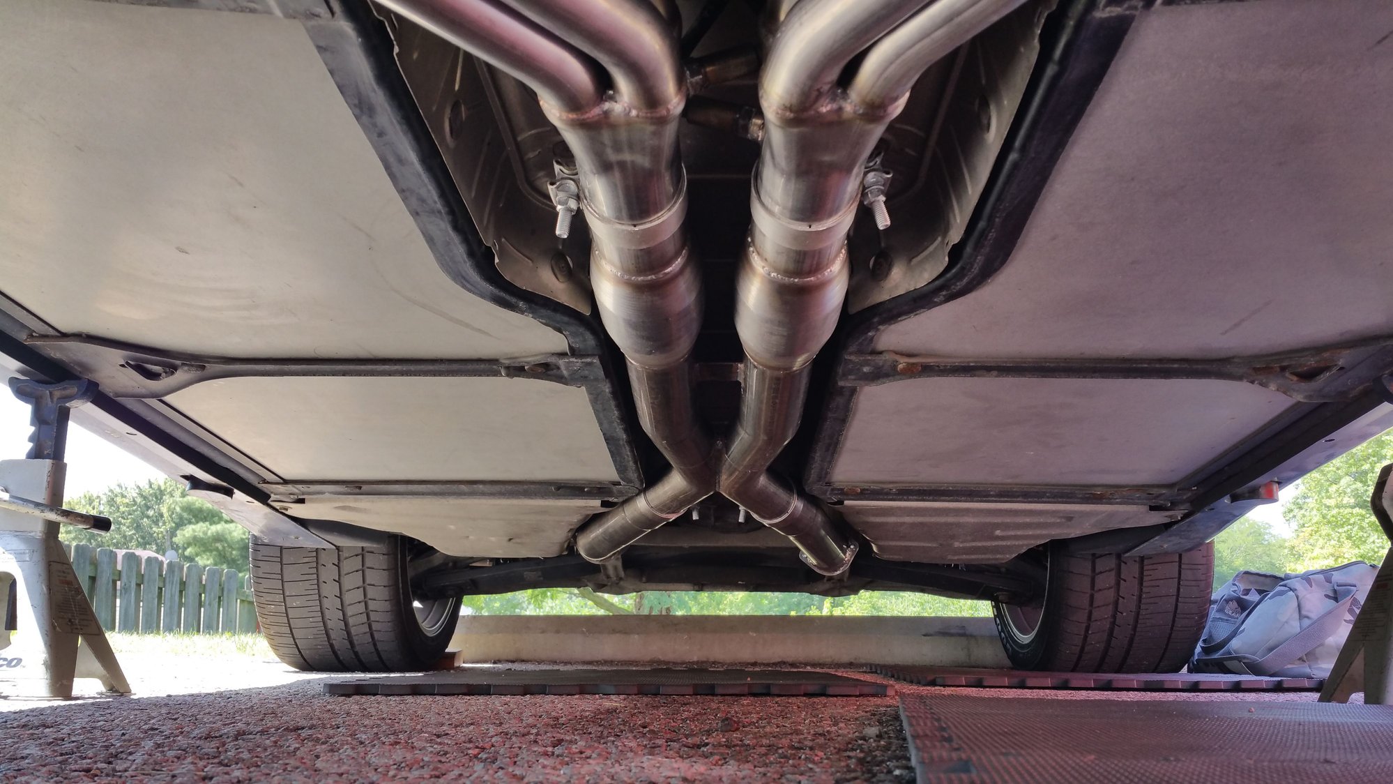

I went with Kooks and they were very easy to install. I chose the street version with the air tube connectors for the 1997-2000 model years and went with the optional ceramic ceramic coating. I chose Kooks for fit and ease of installation. I have absolutely no clearance issues with Kooks and the installation was relatively easy, using a lift and having the proper tools. The Kooks headers slipped right into place from underneath without having to remove the starter or lift the engine or undo the steering shaft and O2 sensor extensions are not necessary.
After Kooks built my headers they sent them to be ceramic coated before being shipped to me. Ceramic coating is essential for keeping the under hood temperature cooler and for a nicer appearance and keeps them looking nice as the headers age. I recommend installing heat protection for the spark plug wires, starter wires and the brake lines as well. Summit Racing sells their own heat protection products for the wires and lines which offers the best protection and price.
Every brand long tube header made for the C5 Corvette will produce about the same power and sound. The main difference is the quality, fit and ease of installation which is how I based my choice. What was most important to me was that they had to be made in the USA. These pictures speak for themselves.
