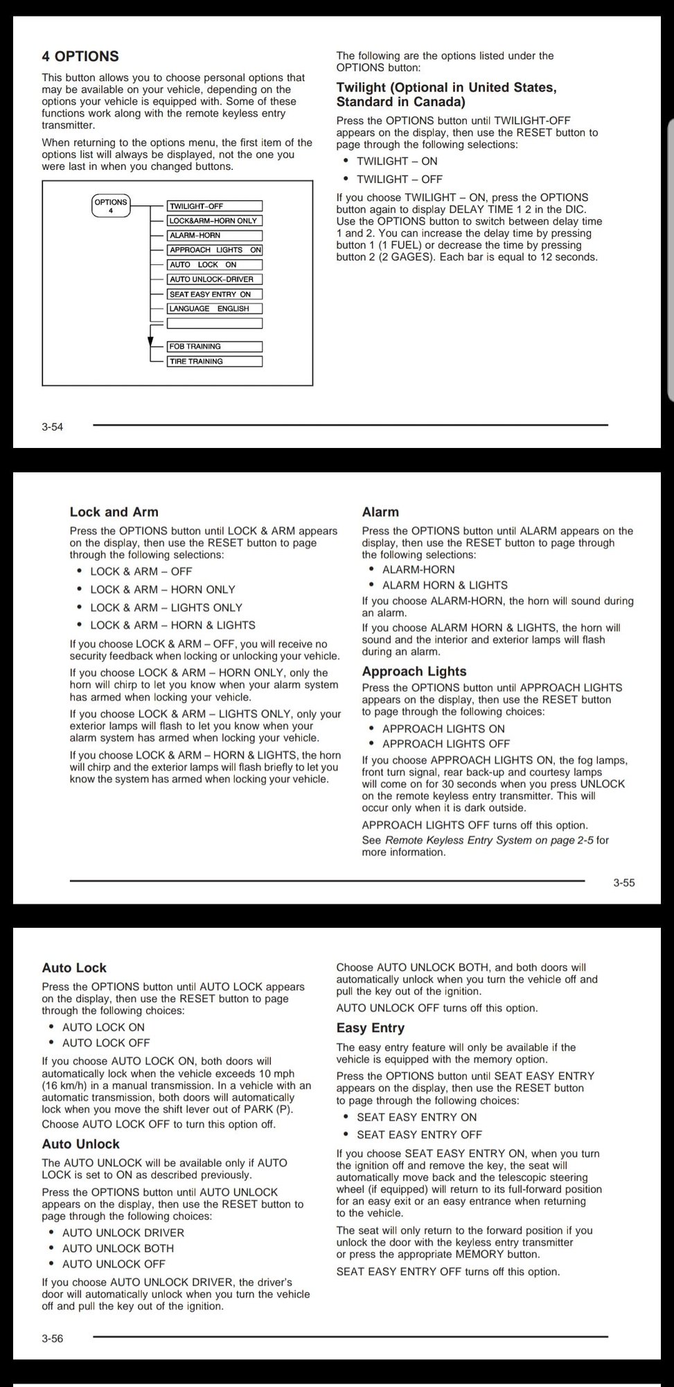

To silently arm or disarm you just have to pick your poison on the DIC. I can't recall exactly how, but it's a 30 second change. Check your owner's manual, download one, or look online.

A few pages from the manual on my cell:

I did check the manual under options and I see the procedure for making it silent arming so I have that info. Thanks for the valet mode info!!

[QUOTE=grantv;1598216393]A few pages from the manual on my cell:
Thanks...I found this in my manual but appreciate the assistance!!
