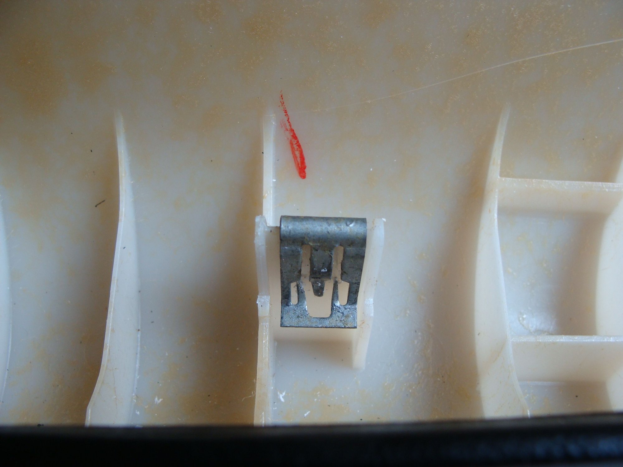

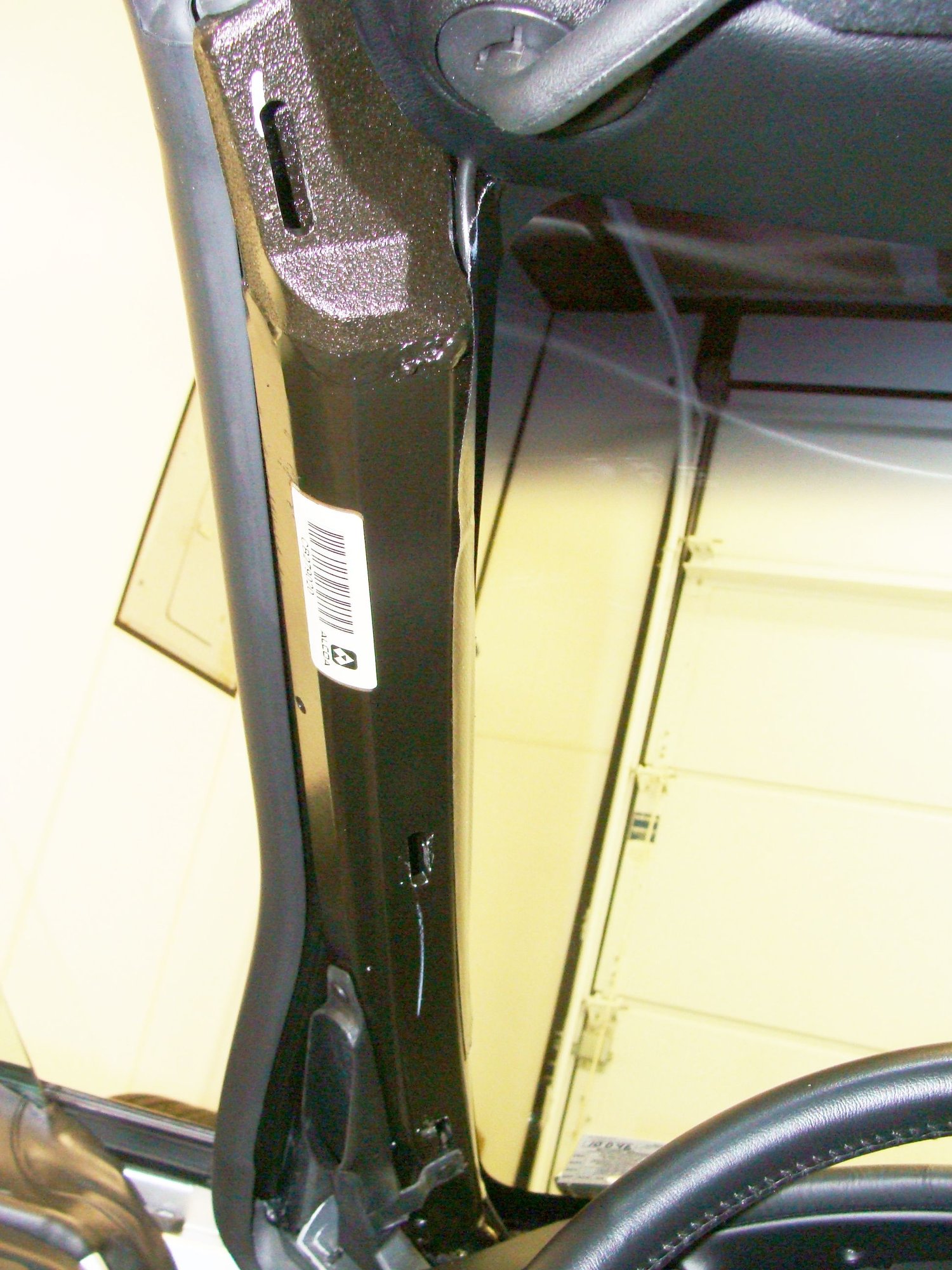

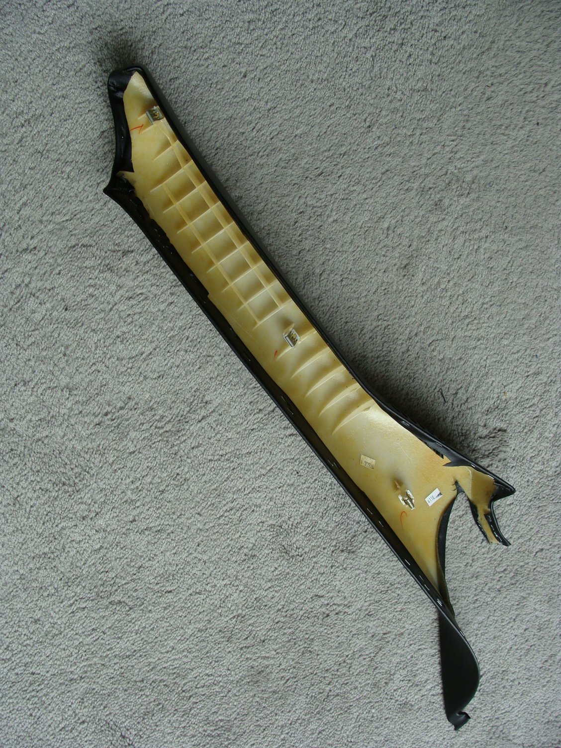

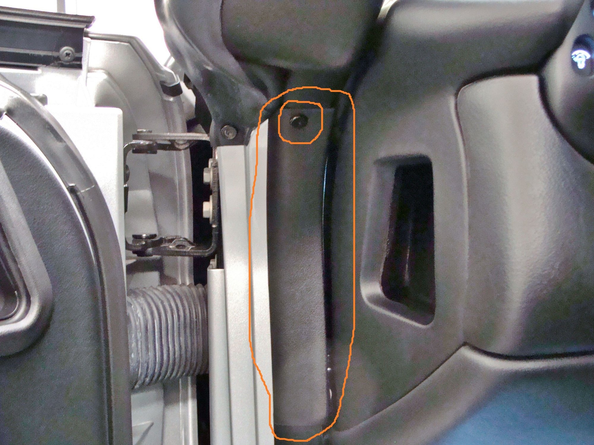

You need to remove the pin & trim piece pictured, the trim piece has one clip that's similar to the pillar trim clip as pictured, sit in the seat and grab the pillar trim at the top & pull it down & angled towards the inside of the car, there are 3 clips as pictured that snap into the A pillar, the pillar trim portion that goes next to the dash board & towards the windshield you just slide it back after releasing the 3 clips, you can also adjust the tightness of the clips if needed.
