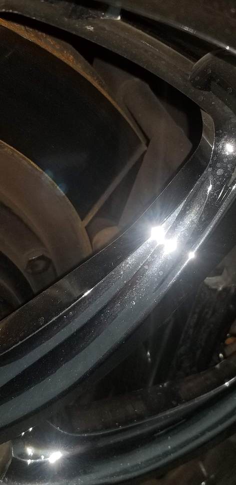

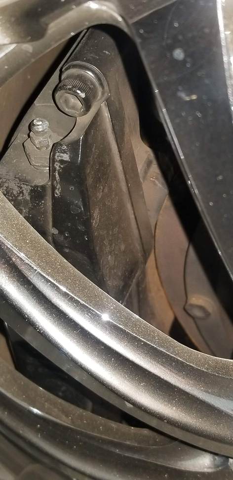

Just bought a modified C5 Z and I'm tracking down exactly what was done as details were sparse!
It has big brakes front and rear. Wilwood 14" rotors are evident but the 6 piston calipers don't look like wilwoods? Here are photos
Thank you

Older Wilwood BNSL6 parts
Billet SuperLite Six calipers that someone has home powdercoated. 7416 pads
I stock all the items for repair or replacement if you need something. Depending on the age is may prove a better option to simply replace it with today's better FNSL6 forged body part.
Thanks Todd that's excellent information
The finish is garbage so I'll be taking them apart for proper powder coating. Maybe you can pm me and suggest what parts would be wise to replace while I'm in there.
Cheers
Cheers
There is no full "rebuild kit" for them. Most parts are ala carte. Pistons (ea), seal kits (per caliper) bleeders (4pk) and the tension clips (ea) plus of course pads.
All of that can be found here: SERVICE PARTS
I may add that depending on the age of the caliper...if it has the stamped thin ss pistons inside you'd be advised to run the newer forged ss pistons which are more durable for track day use. However at $11ea (this nearly $100 per caliper with seal kits and bleeders...) you may want to consider a full replacement. Especially if you plan to strip and refinish them which will be not only costly but quite labor intensive. Let's just say I'm pretty sure we can "repeal and replace" for under $300ea
