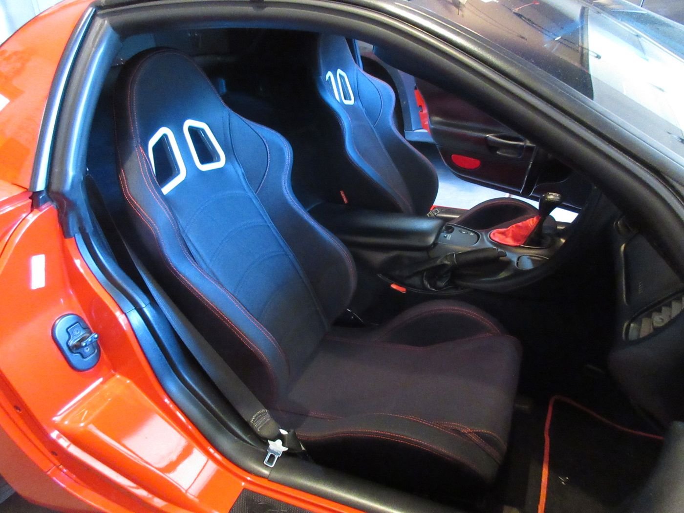

I have Cypher seats. They are very firm, but have good bolsters for support. Don't race my car, but should be good for performance driving. I like the feel. I'm guessing all aftermarket seats will be a very tight fit in the car. Mine were. I have all cloth seats, which I would think would be more comfortable for racing. There was a wide range of pricing from Cypher. Mine are budget priced. They are set up for racing belts.

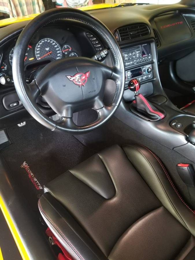

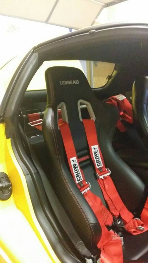

I have the Braum seats. They are not a comparison to stock seats. They are significantly better in every way but one...they are manual instead of power. Installation is not for the faint of heart. You will be cutting on your car if you want to retain the reclining feature. The pic below shows the outcome. 2nd pic is fitting the passenger side.

There's a wide variety of seats out there. When I bought my C5 the driver's seat was worn and torn in spots. It also rocked from a bracket issue. The Passenger seat was fine. I also don't like leather seats, so they needed to be replaced. I ordered a set off Ebay, but they were too wide. Fortunately I was able to send them back with shipping covered both directions. In the process I took precise measurements, especially at the bottom rear of where the seats fit. The C5 Corvettes are very narrow between the center console and the door sill. I ordered the Cipher CPA1016 seats. They were still slightly too wide. But I reversed the driver and passenger seats so the recliner adjustment was next to the center console. I removed the recliner adjustment cover and plastic handle cover from the adjuster. It all fit now with zero space left over. But I did not cut or alter anything on the car. This tight fit is the norm for C5s. So whatever seat you get, take measurements and get the narrowest seats you can. My seats were only $399 for the pair. The seat brackets are sold separately. The brackets were made specifically for the C5 and are not electric. Mine lock in solid with no play. The recliner handle is hidden and difficult to get to, but once you have it adjusted where you want it, you don't really use it.

I’m 6’0”, 210 lbs. the A-4 “normal” width that fits in the C5 were too small for me. I ordered and installed the Braum S8. They were OK but I didn’t think they were a step up from the stock seats. Definitely not for track use. I pulled them out and returned them. Know that almost any aftermarket seat will require the C6 seat belt swap. It’s A LOT of work to put an aftermarket seat in a C5. After installing the Corbeau FX1, I’d recommend just upgrading the stock seat with new foam and leather covers if needed
