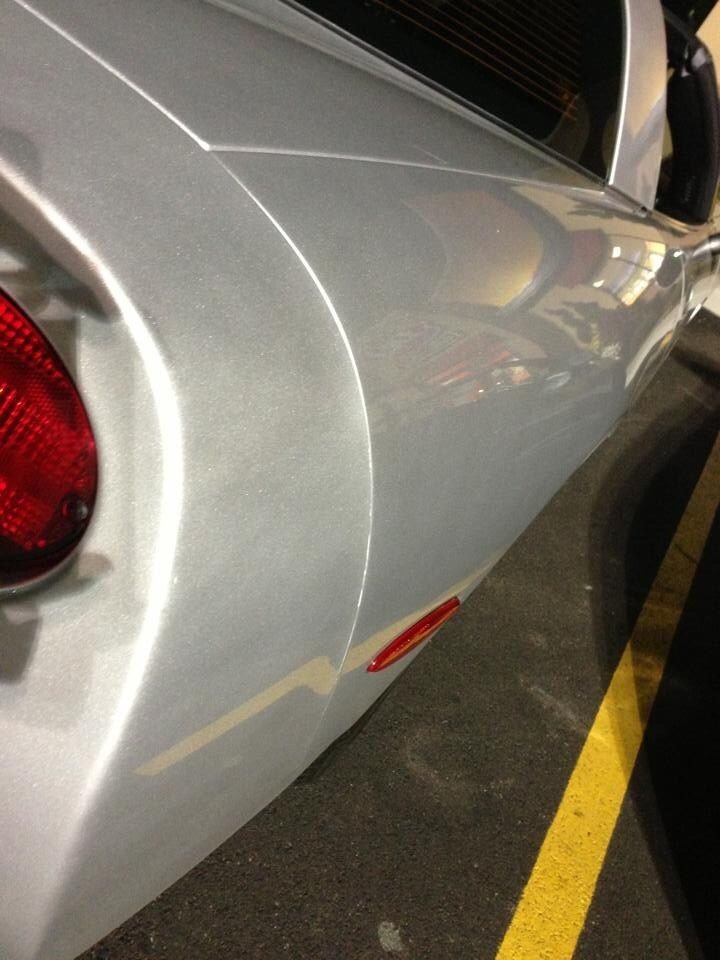

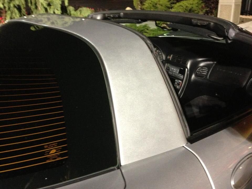

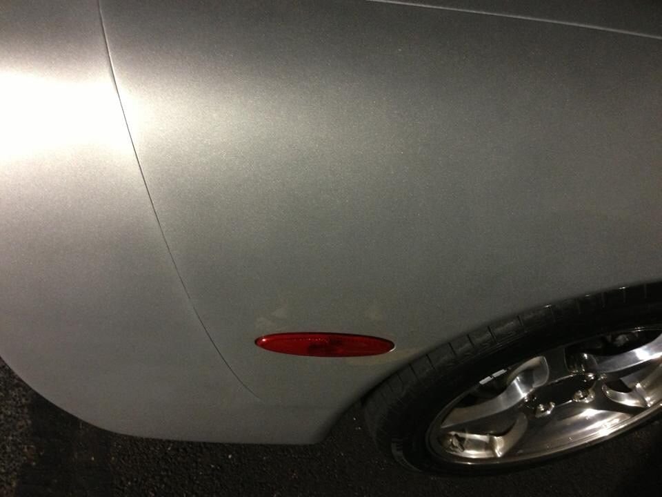

You’ll NEVER get the GM silver to match.
You can get the hue to match, but not the coverage.
if you blend it, it’ll likely drive you even more nuts because half the car will be painted improperly.
I also got quotes to properly blend in the $3500 range. It wouldn’t have fixed the problem. To fix GM silver to the point of being able to blend flawlessly; you need to repaint the ENTIRE car. Every-last-panel.
The mottling or blotch in the silver paint actually shows hints of primer in hard light. A repainted panel will show none of this. I have spent $1500 between two shops trying to get my rear quarters right. The second was all state of the art and does legit concours restoration work on pebble beach quality cars; all types of vintage and modern exotics.
They initially REFUSED to paint it because no matter what it wouldn’t be unnoticeable. They didn’t want their name tied to it and I promised the shop manager not to tell anyone who did the work to be able to get it done. Fortunately for me I knew him personally. They are FLAWLESS. The rest of the paint...eh.
Hard fluorescent type lighting shows it worst at an angle.
IMO take what you can get and try to be happy.
