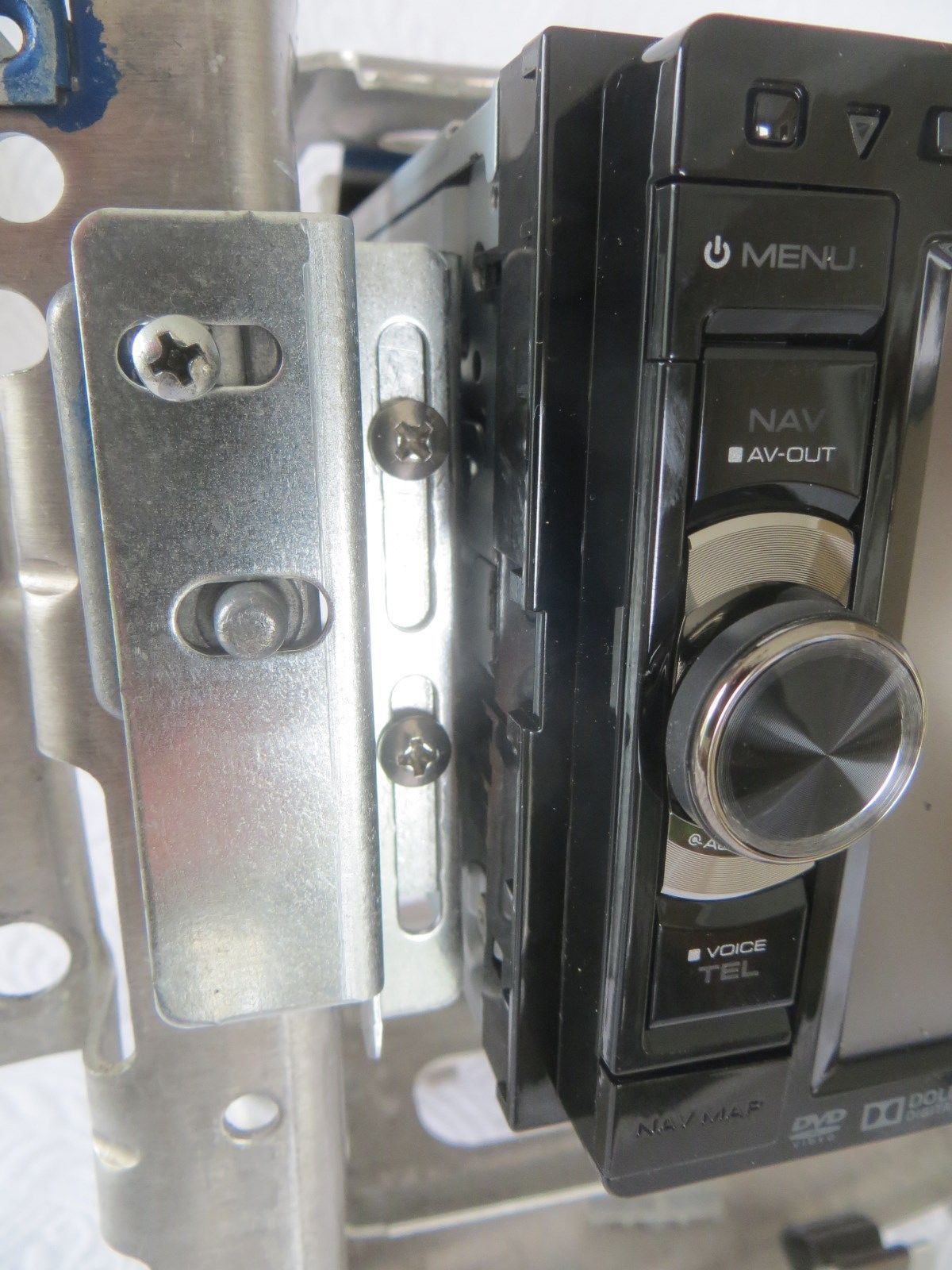

I installed a Kenwood HU a few years ago in the wife's C5 and ended up making my own brackets.
https://www.corvetteforum.com/forums...-overhaul.html

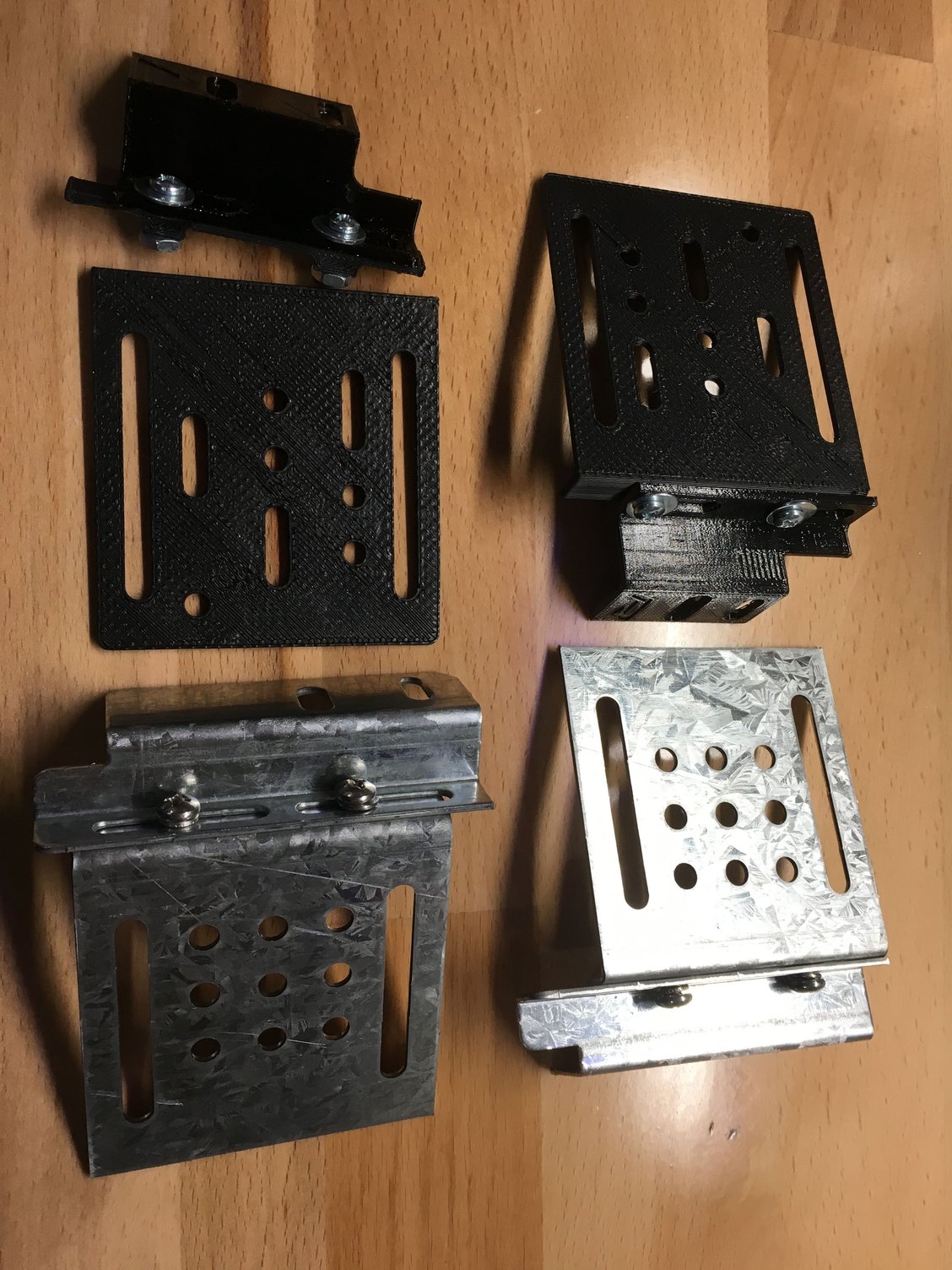

So I got my fleabay C5 Double Din brackets this weekend. Here they are compared to my broken plastic brackets from VetteNuts -
Similar, yet different. The metal ones won’t brake and they have good slots, but still need to be modified to fit a VetteNuts bezel.
when you mount the metal brackets to the car, they cover the holes where the OEM and VetteNuts bezel have guide posts going into the car, so you have to do some cutting. Then when you try to fit your HVAC below the headunit, your HVAC will hit the bracket and won’t fit into its holes, so you have to trim some more.
Outer brackets are the culprits for both issues.
So, it is quality- but this seller sure gets you with Corvette Tax, twice! Charges you $50 for the brackets, then charges you $12 to ship when he is in no hurry to ship and the package said he only paid $3.95 to ship.

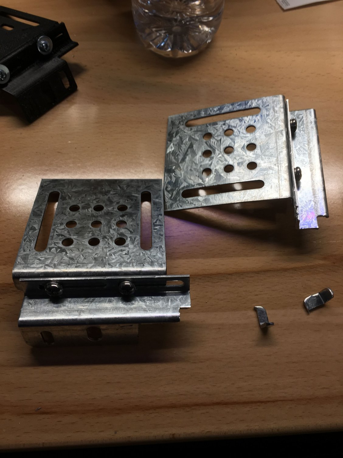

Photo of brackets after cuts and before bezel gets mounted.
To Brackets
