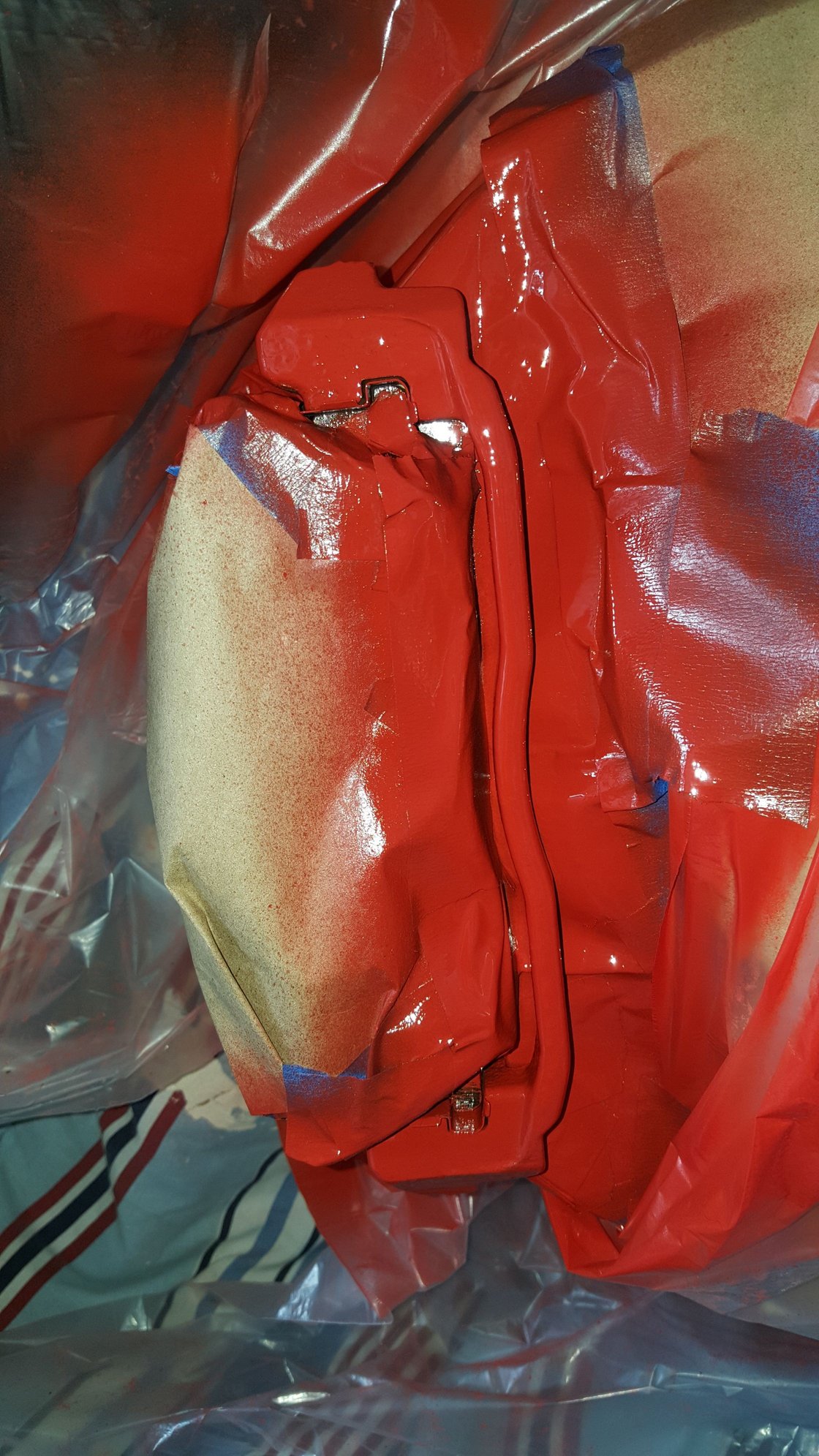

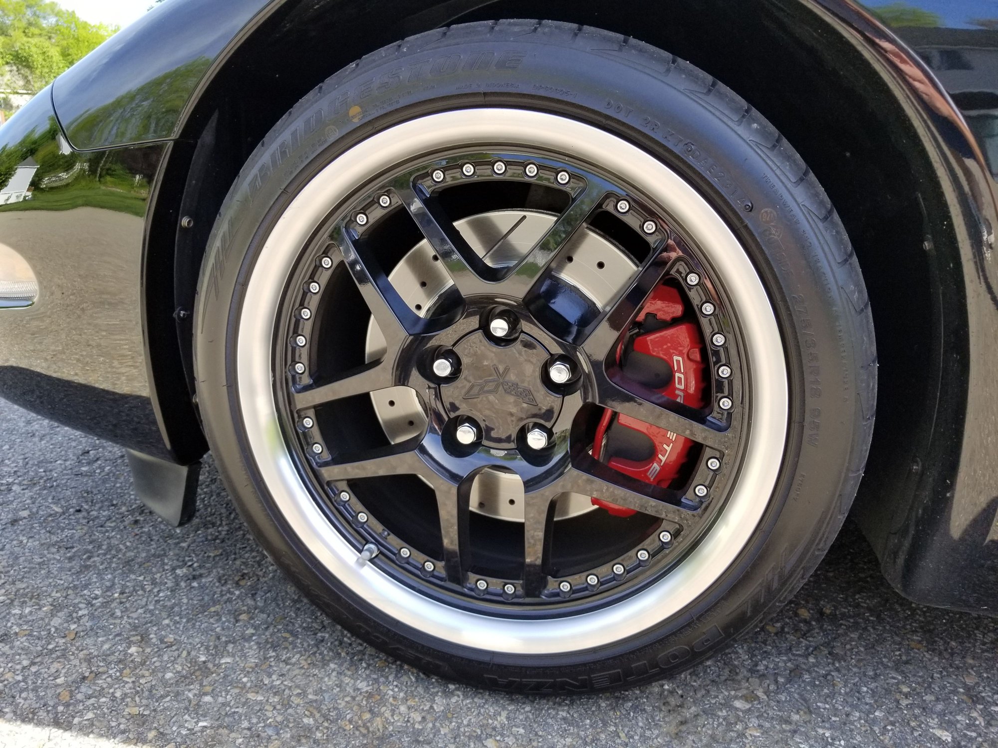

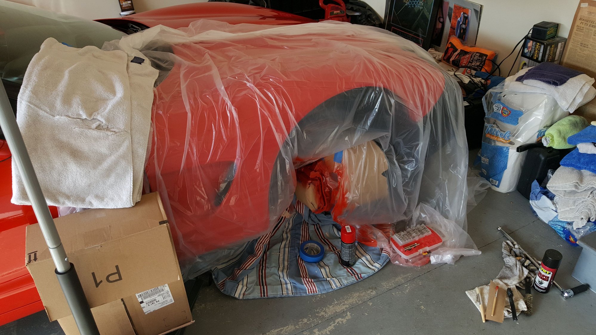

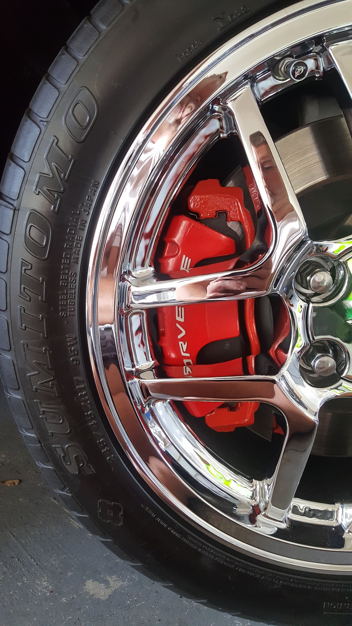

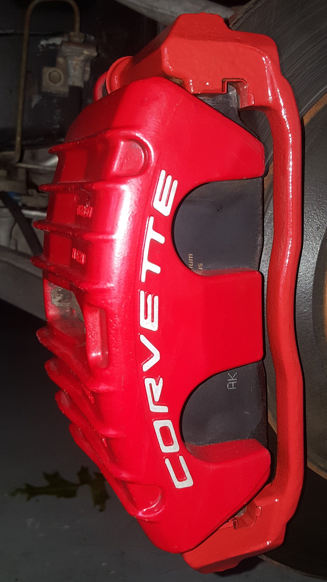

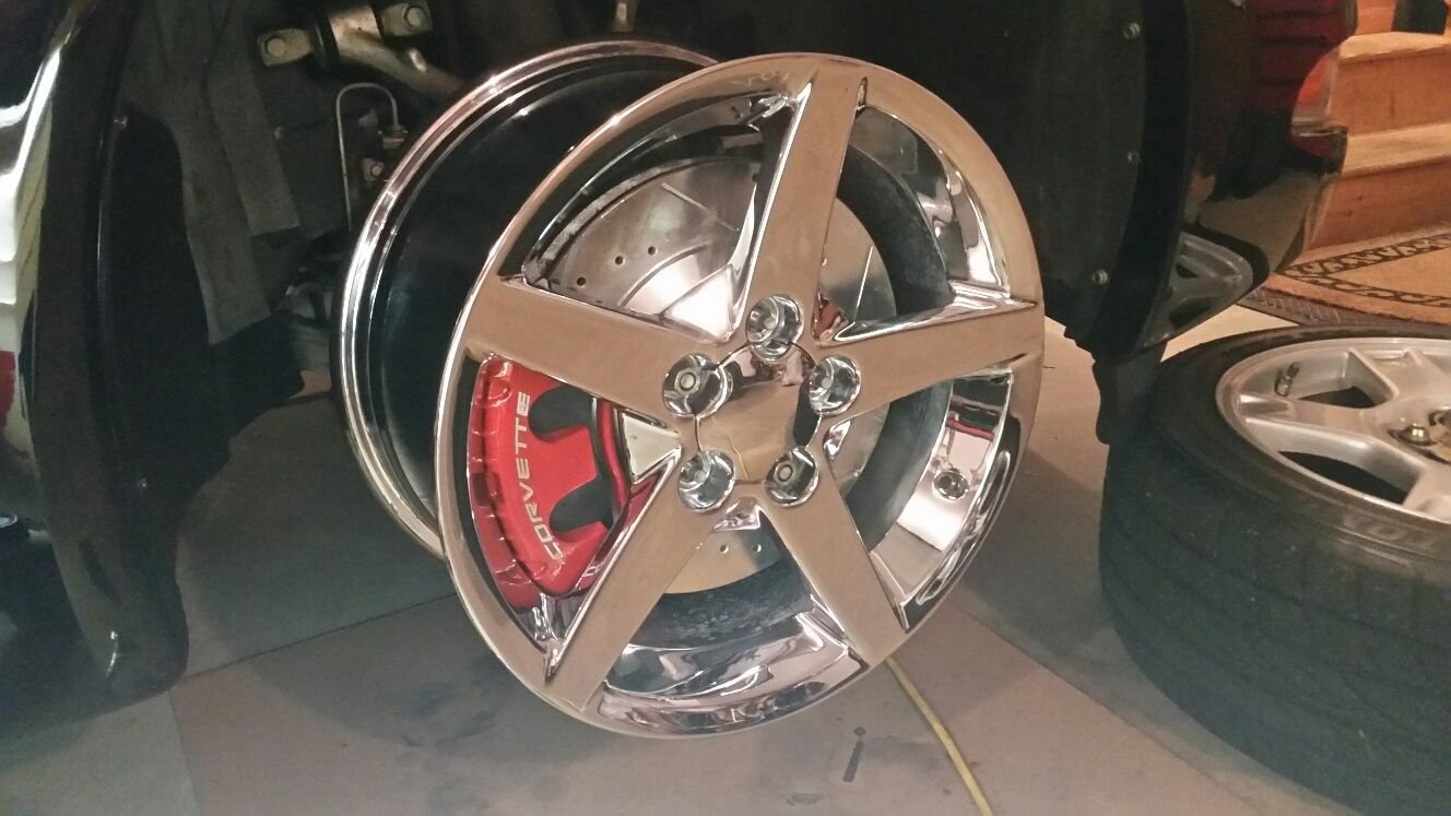

I painted (also in the not a fan of covers) last winter. I used a G2 kit as previously mentioned, however I wasn't that happy with the results. Granted, I didn't remove the calipers, and had them "hanging". Meaning, I replaced the pads and rotors and while the caliper was off the rotor, I painted them, but they were still connected to the brake lines. Anyway, after they dried, I then took a rattle can to them and was much happier. I just didn't like MY application using the G2 kit and didn't think I had good coverage. Using a rattle can, I was able to get into tighter area's. Once it was all dry, I used a block/sponge sander and cleaned the letters off. After all that, I hit them with a couple light coats of clear.
First pic was right after I was done (and seeing what it looked like with a set of chrome wheels). Second pic is a few months after, with a set of black wheels I ended up going with.

Really like the black rims. Who makes them?
I'm actually not sure. I bought them used from a local member. Only thing I know is they're C5Z replica's

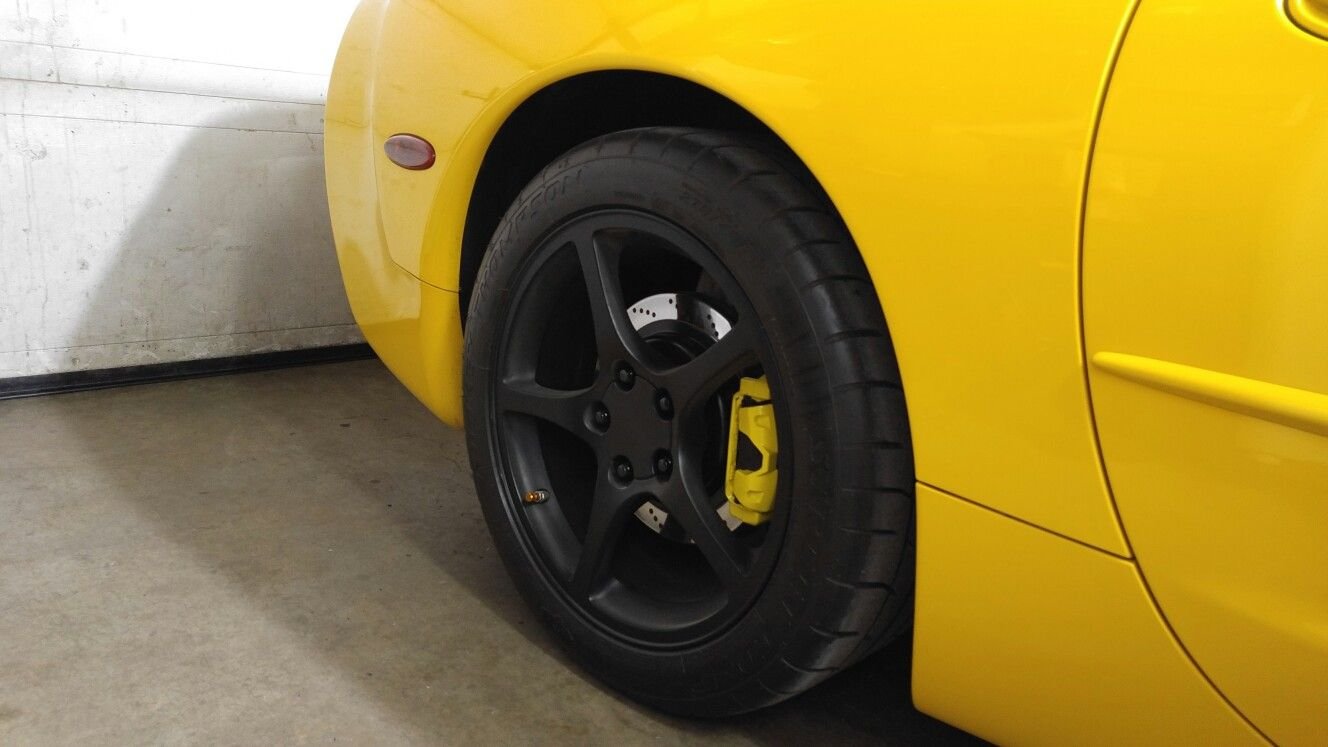

I agree. Painted them myself. I had them off for new steel braided brake lines and fluid replacement, so it wasn't that much more work. I also added some flat black rotor hub covers to complete the look. Besides, the covers look like.... well, covers. Really meh.

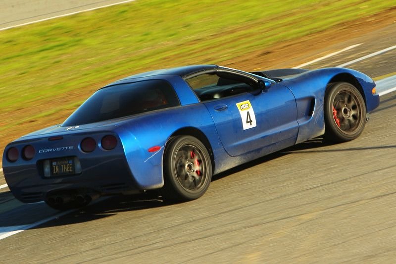

I am glad you decided not to get caliper covers.
FWIW, in opposition to the person above who said they do not like red calipers with an electron blue car, I would say that red-under-blue is a very good contrasting color scheme and works fine. Bright blue and bright red are opposites that play well together.
Mine is rather dirty from driving through a lot of dust, as you can see.
Honestly I much prefer black or silver (nickel-plated) calipers, I bought the red ones from a forum member due to a deal I could not pass up, but you can judge style for yourself.
(For reference, these are Aero6/4 calipers on a 14.25"/14.00" rotor setup from Wilwood.)

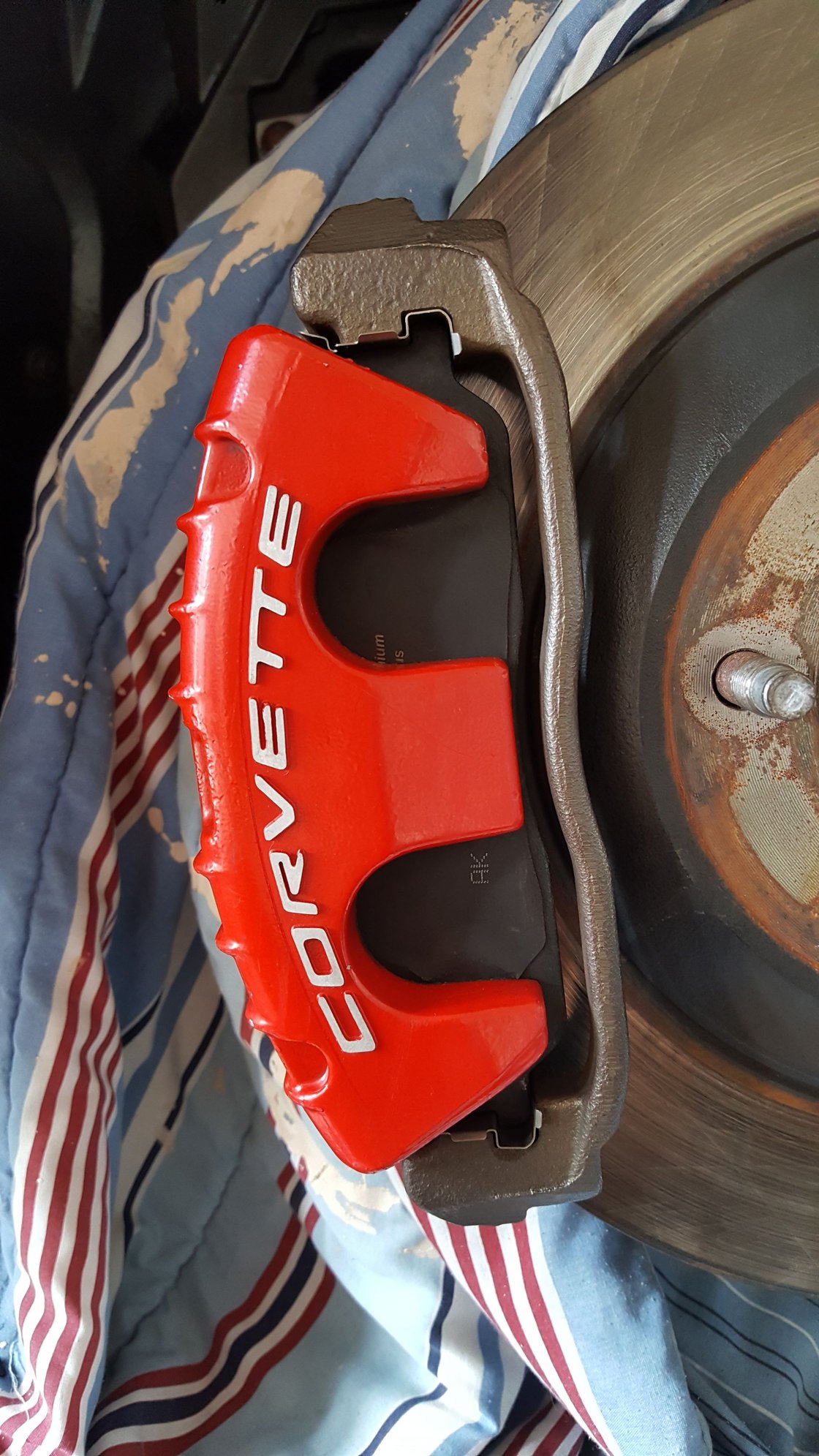

Take the time and paint them yourself. It took me 2 days to do all 4 (prep, painting and drying)...well worth it in the end... Paint on the bracket didnt match 100% but no one can tell with the wheel on:
