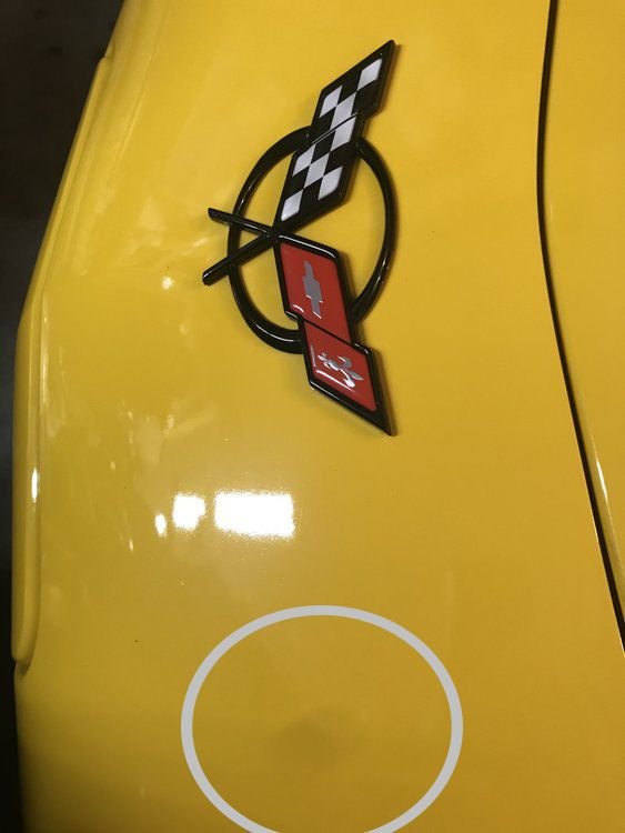

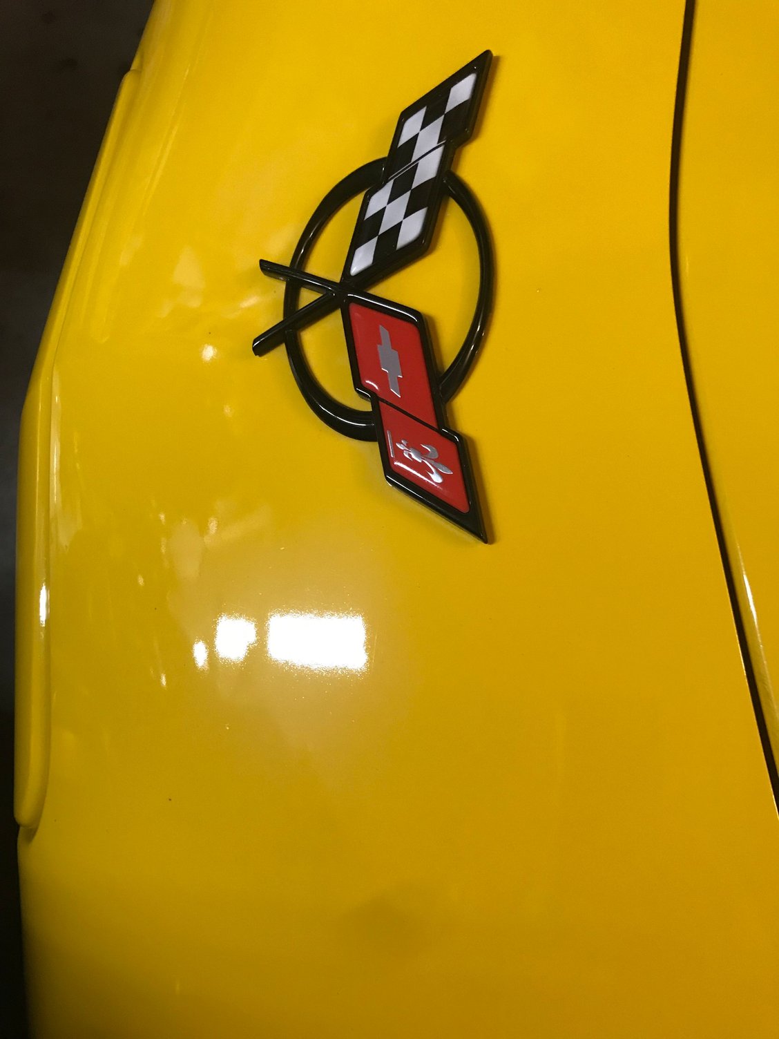

Thanks Bill. I suspect you may be right. There’s still a chance I’m not describing it correctly. I took several pictures and attached the best I was able to get, at least tonight. If you look in the area reflecting the light you can sort of see what I mean. Maybe excessive orange peel with a less glossy finish is a better way to describe it.

Hard to tell in the photos but I can make an educated guess.. MY is a hard color to match, however the phots look good to me. What I do see is very typical of many paint shops. Matching the color is one thing.. That's has become an almost non issue with computer controlled aftermarket paint match. This area looks to be a typical problem in the paint industry where the paint shop does not match the gain of the clear coat. A good eye for this can pick up a perfect paint match but a mismatch of the clearcoat grain. ( orange peel. ) without actually seeing it, it would be hard to give a good assessment, but cutting the clear coat to match the surrounding clar coat grain would be what a detailer can do.
I hope this helps you understand there is more to a paint repair than just the color match. Sometime the paint shop does a much better job of removing orange peel by hand at a local shop, than the factory does with the robots. delivering a factory paint job.

Taking a second look, I see a spot that is darker, see the center of the circle. that looks like some airborne contamination that got between the clear coat and the base coat, if that is what you are talking about , then you cant buff that out.. its below the clear coat. this could have happened when painted in a open area or a poorly down drafted booth.

Bill,
Unfortunately I believe that’s a reflection of my head which can’t be buffed out to look prettier. 😁

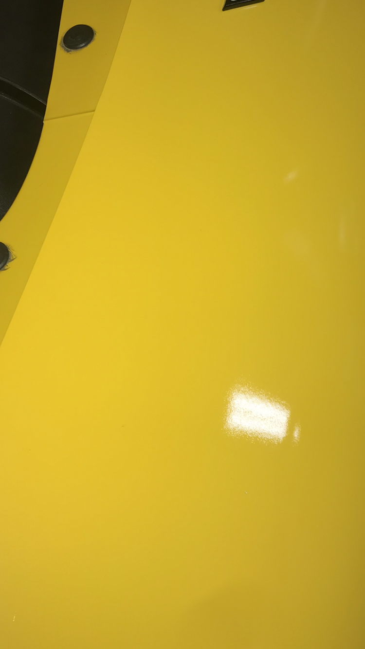

Here’s a wider angle shot under different lighting.

That paint match is too good IMO to be aftermarket. Maybe you just have some etching in the clear on certain panels?

FWIW I had a 2003 vert that had thin paint on the front bumper to where the hard corners showed the black plastic through the paint. You could only see it if looking very close and the rest of the bumper had normal gloss and proper color match. It was not a repaint (checked with paint gauge). Take some more pics out in the sun... based on that latest pic you got a perfect paint match which is exceedingly rare with that color.

Finally had some sun today, got a few pictures this AM. The paint match does seem good, it’s just the clear coat that seems off.

Your paint looks pretty damn good so i would just be thankful, ceramic coat it and move on your way.
