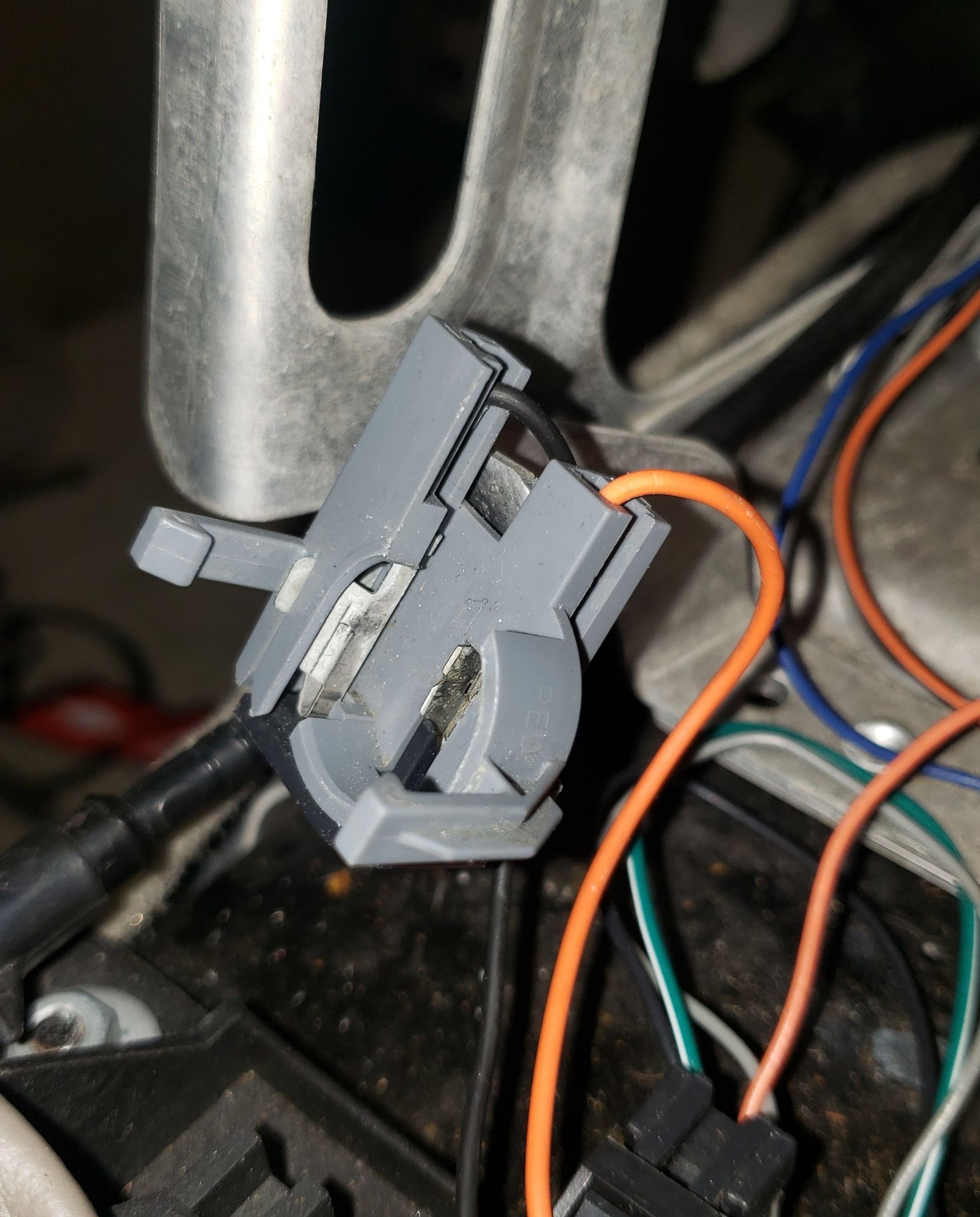

Here is what the plug looks like for the stock lighter socket.

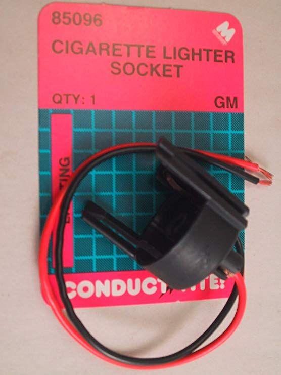

This is what is in there...it just did not look like the element / housing would connect properly...maybe it will. It does not look like the photo of the stock connector that was shared. Thank you for the input and advice!
Yep, the gray connector with the orange and black wires is the stock connector. You have to clip one side on and then try to keep it from spinning while you clip the other side. I pull passenger compartment fuse #7 when messing with the connector.
The black thing in post #3 looks like a piece of generic aftermarket junk.
