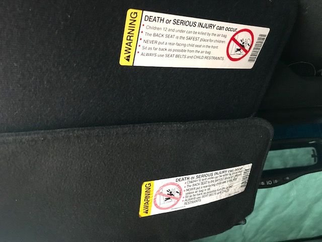

I had tolerated the original "floppy" visors on my '01 convertible for over a year (they were that way when I bought the car) and I finally got around to replacing them today. The driver's side visor would hit my hat every time I got into the car and would not flip up all the way up. The passenger side was even worse- the mirror had broken away from the visor, the inner card had separated from the hinge, the fabric had separated and it had the same "dog ear" of the driver's side visor- making it not only unsightly, but un-useable.
Before selecting the replacement visors I did quite a bit of research and discovered that there are several different versions out there, some better than others in terms of quality of: fit, construction, color and materials. These visors from various sources typically run $150 and up for a pair. I found a pair that were exactly as advertised sold by "buyavette_inc" on eBay for $149.95 (shipped).
These replacement visors were of very good quality (likely superior to the originals), a good color match and installed just like the old ones. The installation proved to be fairly straight forward, after watching a YouTube and finding a helpful schematic on this forum- it took me about a half an hour to replace both visors. Good as new (maybe even better than new)!
Just thought I would share in the event your car could use new visors.
Old visor, passenger side I had to build up the lid with a spacer so the light would turn off and put a clamp on the hinge as a stopgap :
New visors installed.
New visor from the driver's seat view
Old Feb 14, 2019 | 08:14 PM

You are very welcome and once you get this done, you will be very glad you did! It really spiffed up our car's interior, those old floppy visors were the only thing letting it down.
Yesterday evening we drove the Corvette and my wife was thrilled with "her" new visor. She really liked the led lighting too.

Can you tell me if these are the same color as the OEM black? Are these more of a dark gray ?

A picture can be worth a thousand words. So you can be the judge- but I would say they are black, and if anything, it looks like my old visors were faded to a shade lighter. The warning label is not an exact match, however. But that strikes me as a minor detail. PS- looks like my post may have caused a run on the seller's stock such that the seller has only 1 pair left. So if you are on the fence, you might want to make your decision soon!

They look really nice, I will order them tonight
