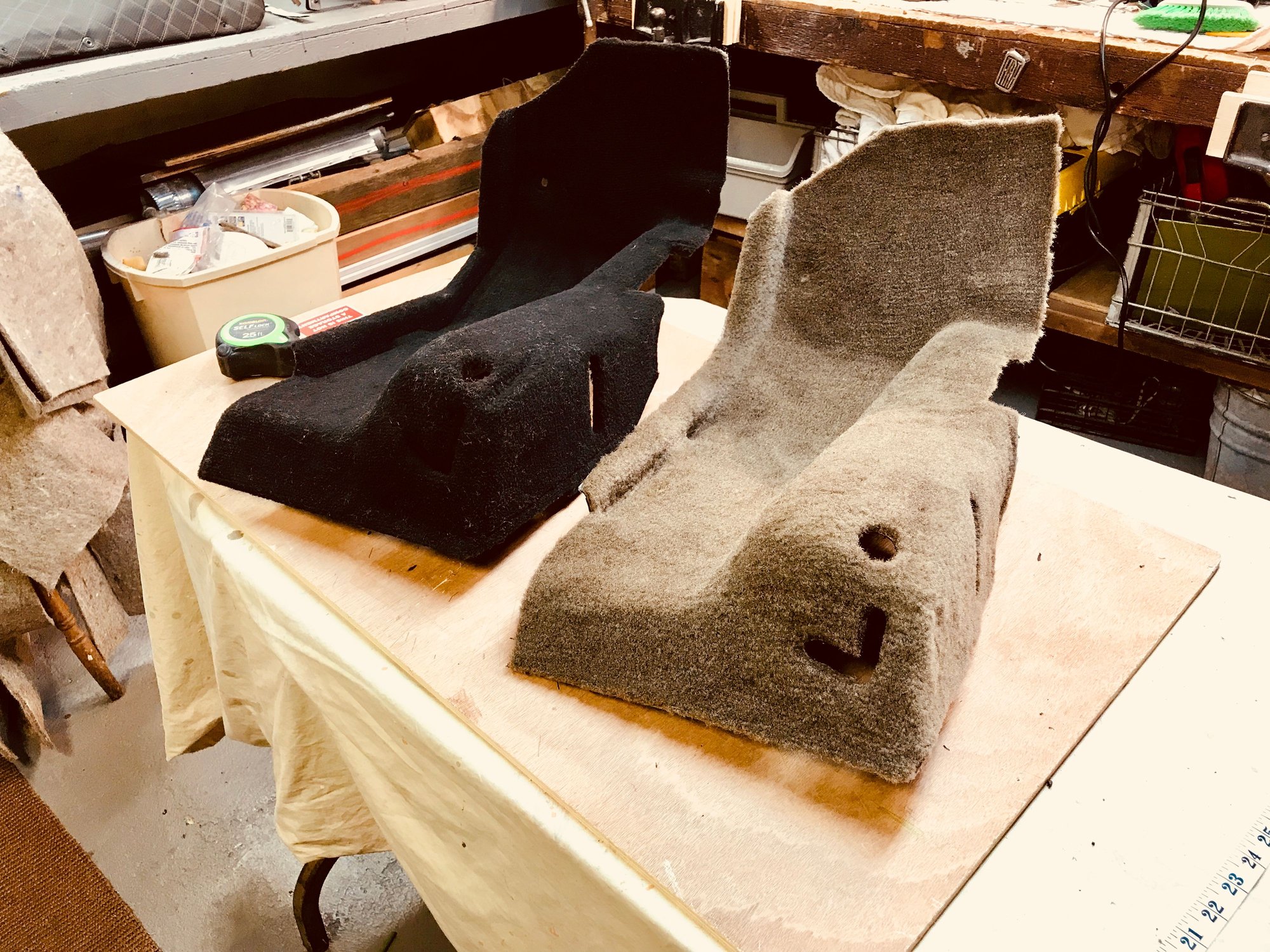

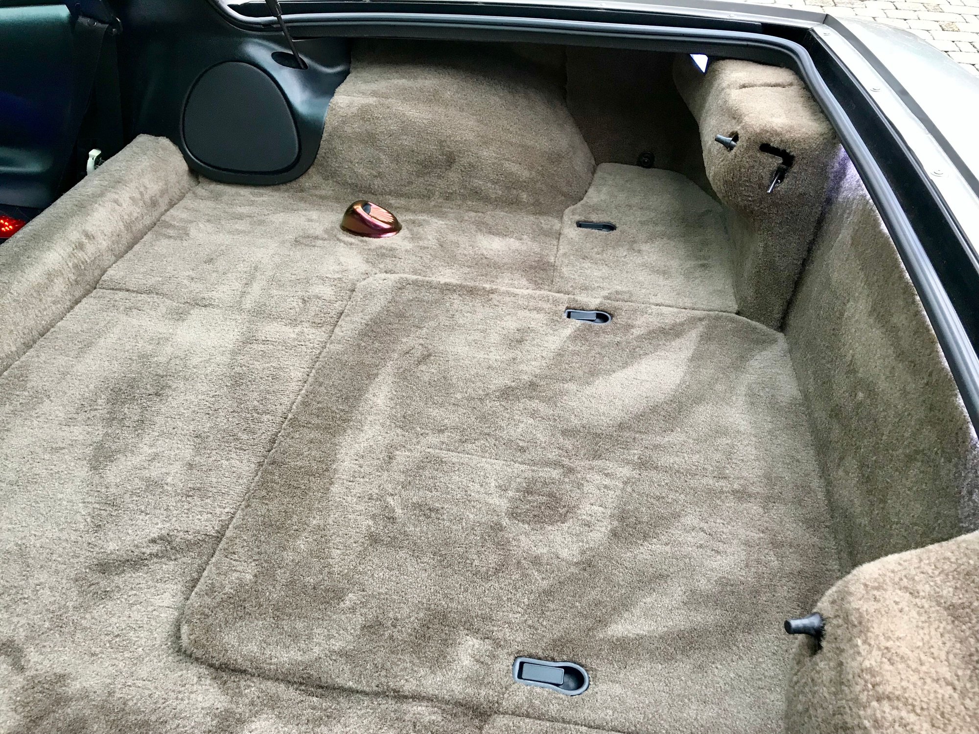

ACC carpets are sold by StockInteriors.com.
I changed the black carpets for one that goes with the pewter exterior. They offer about 23 colors. I did get the mass backing, which makes them stiffer and the backing does have a smell which takes it’s time fading. The fit is not exact. I used the original pieces to cut to fit, but one must take time to realize certain pieces, because they are not symmetrical. I used a variety of methods including clamping pieces together, using a laser level, and obsessive measurements. I got the standard cut pile and I’m very happy with the way it looks and wears.
The binding on the exposed areas is not as good as original but ends up being hidden. I also wouldn’t bother with the floor mats since the driver’s side is not long enough so it moves around.
The 3 tail light sections are fine, and fit well. The flat areas need a good contact cement so they stay in place and lay flat.
