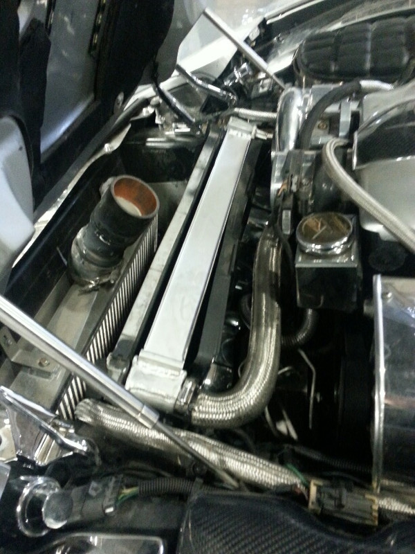

Someone messaged me yesterday about a radiator that I installed in my car a couple Saturdays ago. I was answering the message when my computer decided to act all F'd up and now I don't have that message anymore. So, to answer your question or if you'd like to send me another email I'll gladly answer all the questions you have on it. I have had the radiator installed over a week now and have zero issues with it and no leaks anywhere. I did have to bend a couple mounts for the condenser when I installed that but it was the only thing I had to do to make it work and it was super easy to bend them. As you can see it was shipped really well and had practically no fins bent over or messed up. All the welds looked great and had zero issues with them so far too. I love the way it actually runs cooler too. I installed a new AC system in at the same time and it works well with the new radiator also. Here are some pictures of the one I installed and I also got it from the auction site from ECP, so if this is a no-no to show this then please delete this thread for me.

Looks like a fine radiator.
Unfortunately, it's hard to see if it's really that good just from inspection. There's an entire thread about it, recently resurrected here: https://www.corvetteforum.com/forums...-radiator.html
I hope this radiator works for you and works for many many years, because apparently otherwise it's a pain in the behind to do anything about it.

I have had mine for about 3 years now with no issues. I have a 402 with a supercharger at about 650whp. Works great without any issues. I would buy it again.

Let us know if any issues pop up. I have read some reports about pinhole leaks at the welds. So if and when I decide to use mine I will have a rad shop do a pressure test before installing.

My ACS rad has been great for 5 years
no issues.
Just had to bend the outer tabs out to hang the shroud then bend them back.
Cutting the inner tabs off made it easy to fit.

I thought I was being pretty clear.
The rad has 2 tabs each about 3/4" apart in 4 corners to hang the shroud.
I cut the inner tabs off the ones pointing to the center.
The outer tabs that point to the fenders I bent out then slipped the shroud
in then bent them back and moved the shroud around to hang it.
The bottom ones I bent back on a lift.

the petcock they use is complete garbage btw

Agreed, it is junk and doesn't work for S#*T, I'm going to look for another one to put in it I think. I also had silicone hoses on the top & bottom and they didn't like to seal very well with the aluminium, so I got the regular rubber gates hoses and they seem to be working better. I'm going to be looking into better clamps for the hoses as well. I like the ones StrangelovesM6Vert has.

I installed an anode rod in place of the petcock, ECP(speed cooling) sells them also, I think it was $12 for two. So far all good with my ECP, installed 05/17.
