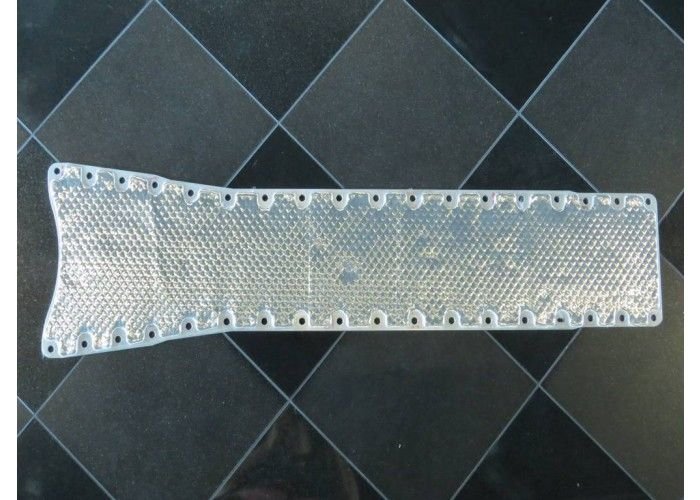

One thing that we recommend ALL headers customers buy is our Tunnel Plate w/ Thermal Shielding. This will eliminate chassis flex and alot of the heat through your center console.
http://www.tpsmotorsports.com/tps-mo...nel-plate.html
