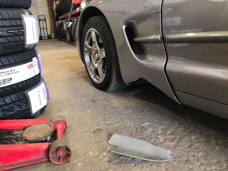

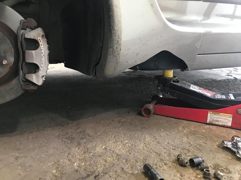

This poor individual from a C5 Group on Facebook posted this a couple of days ago. He went to Discount Tire and this happened. I NEVER attempt to lift my car without pucks installed.
OUCH!!! When I went in to Discount to have my tires installed, I called the manager out, installed the aluminum pucks while he watched, and made sure that he, and the installer knew to jack on the pucks ONLY. They opened the doors, hood and trunk while it was jacked up, not necessary on the C5's, but no harm doing it either. The $45 you pay for a set of the aluminum pucks are more than worth it.
