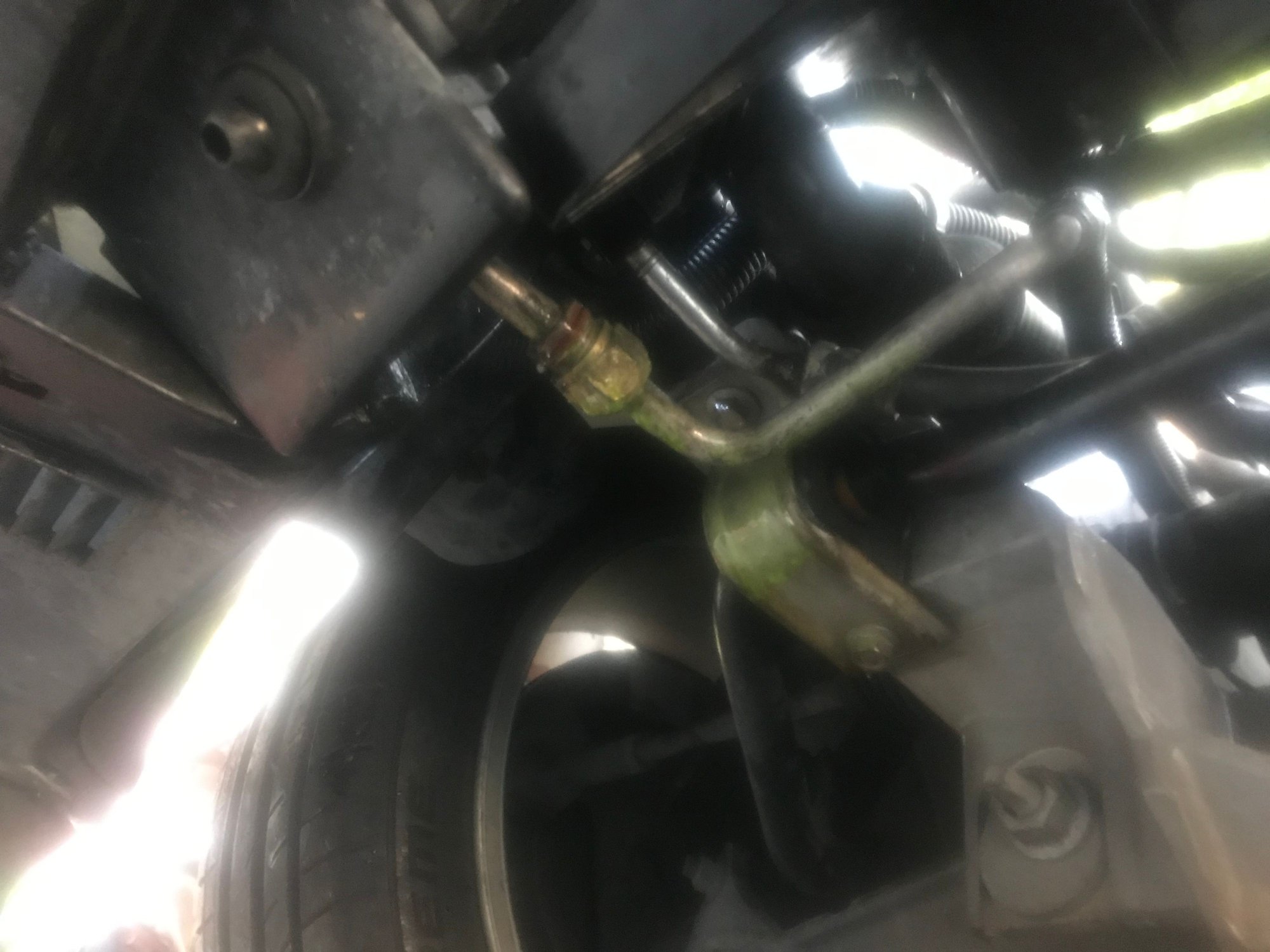

I’m workimg on the radiator and losen this bolt and a whole bunch of air starter to come out with green liquid

air conditioning line !!!!!!

that's the ac condenser not the radiator

That's the transmission cooling line connected to the radiator.. water and antifreeze.. Not the AC
never seen a transmission with PAG oil in it....
on the plus side OP, looks like your AC may have been serviced in the past because it's got PAG oil with leak detector in it
explain the rush of air ???????

Without the cheap shots, I'm man enough to re check the line below the radiator petcock knowing this is where the Trans cooling line is located.. but its a direct connection to the radiator. this is indeed a condenser line, I apologize to the op.. A quick look was a poor choice. fitting C on this LS radiator was my initial concern.. the green fluid could have been antifreeze and an air block, but there was no mention of any water. Its a ac line.

I don’t know too many transmission lines coming off the condenser.

Yikes, I hate when something like that happens. I hope you didn’t hang out under the car long after you popped that line to breath in all the 134a refrigerant that came out!
Draining the A/C system of refrigerant would not cause overheating. Something else isn’t quite right. My guess is you have air trapped somewhere in the cooling system.
