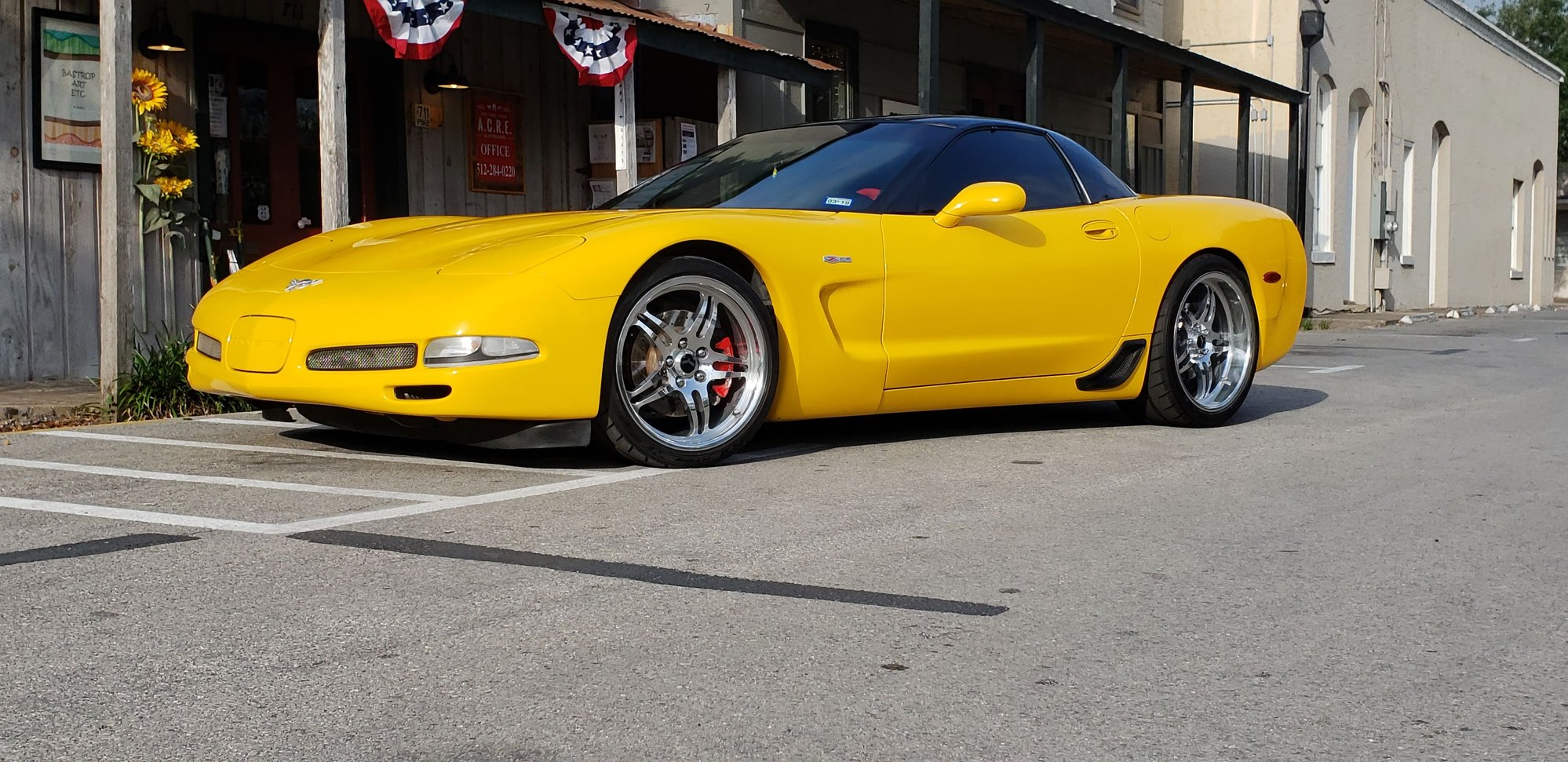

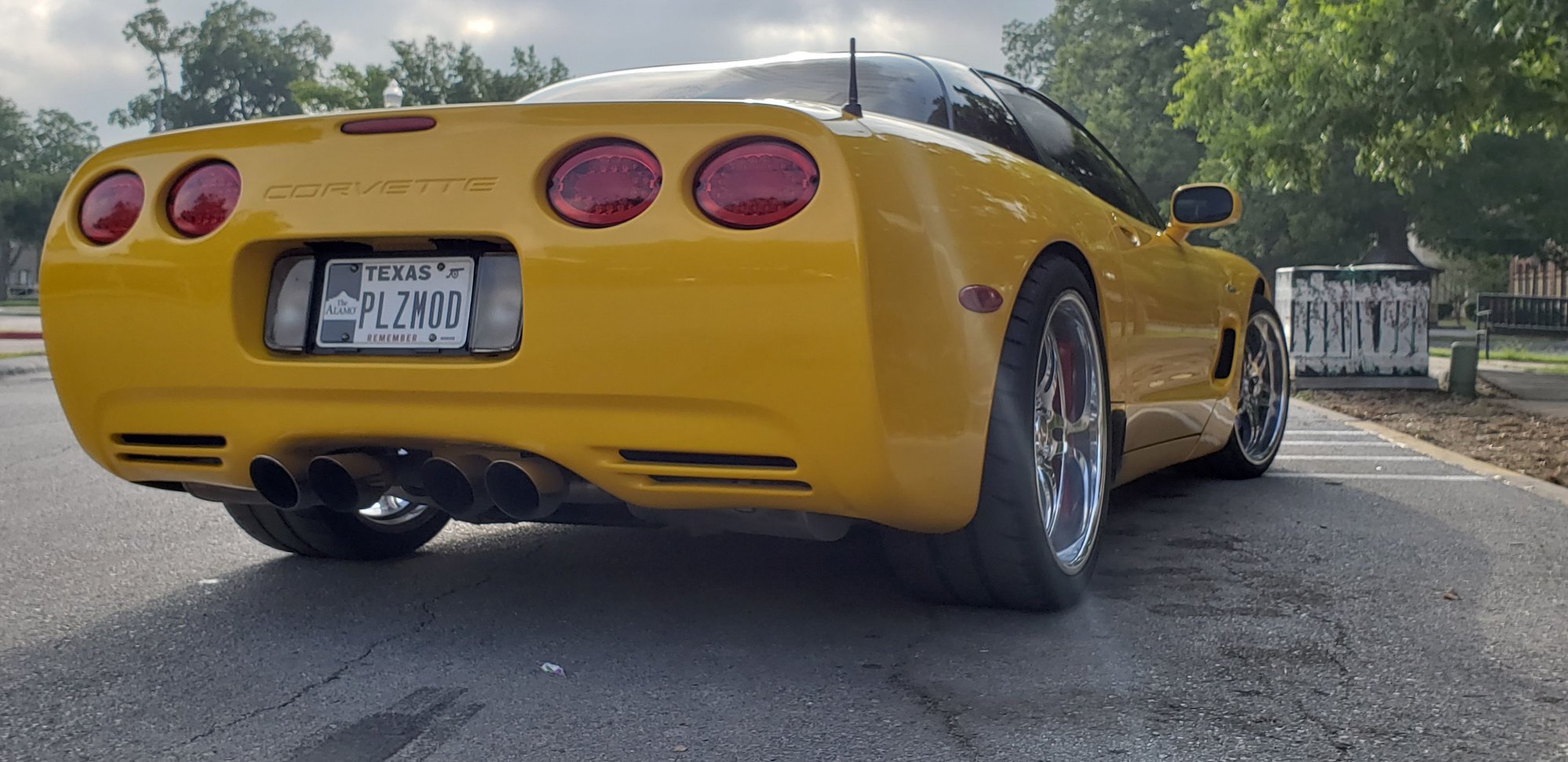

While some may hate a 19/20 set up on a Vette. I actually love mine.
front tires are 275/30/19 and rear tires in the picture are 305/30/20. I have since moved to a 315 rear tire set up.
The only issue going with larger wheels is the factory brakes look tiny in the back.

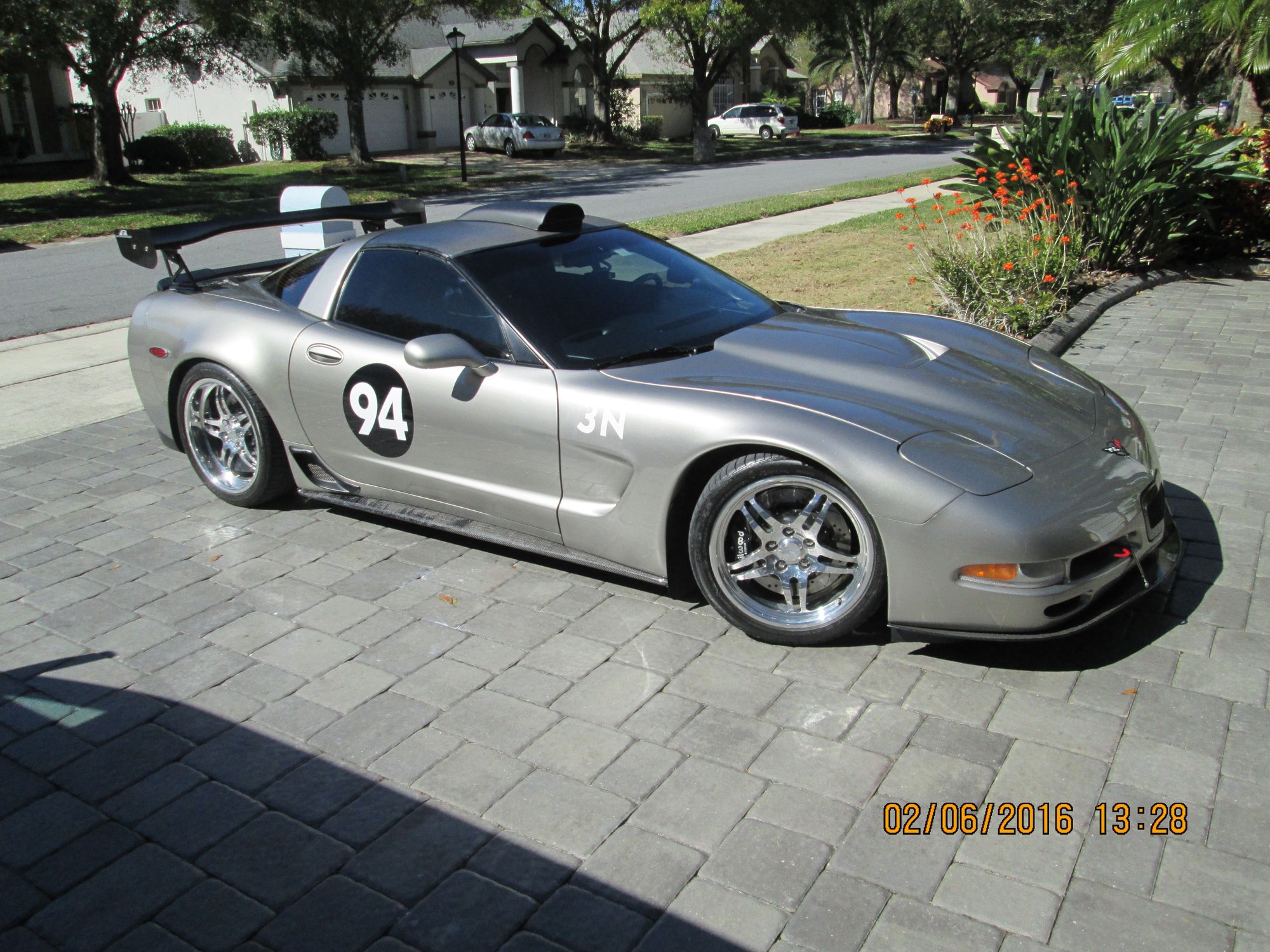

I should have made myself alittle clearer. I bought two sets of CCW 505's from john. The original set was for a stock C5 with stock brakes and rotors.
The second set I bought was also 505 A's ( Obviously I liked the style ). I bought them for the increased width, and to cover my 14 inch Eradispeed 2 piece rotors, and to accommodate my 2" wide flares.. IN both cases. I told John what I had, and He set the backspace and offset. Naturally they fit perfectly. I remember Toque telling everyone he had to shave his calipers to fit. I also posted that when John made mine, they fir correctly.. I dont know if Toque told John what backspace he wanted, but they should have fit.
