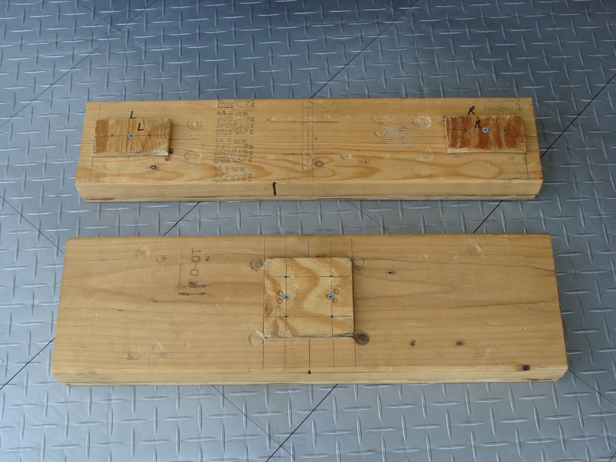

Hey does anybody know off hand how long should the front and rear lifting brace should be if I use a 2x6 or 2x8 ?? I have some oak boards to use with as 1/4 steel plate. just don't know how long to make them.

Mine are 24" long, I use for jacking only, I use wheel supports or the jacking pucks to hold car in the air.
