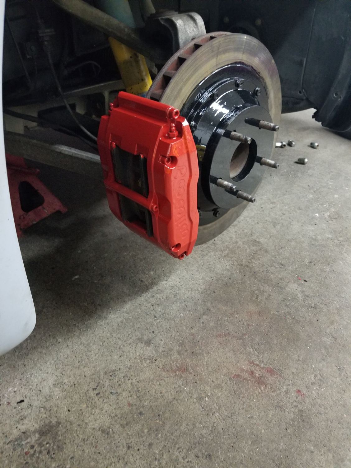

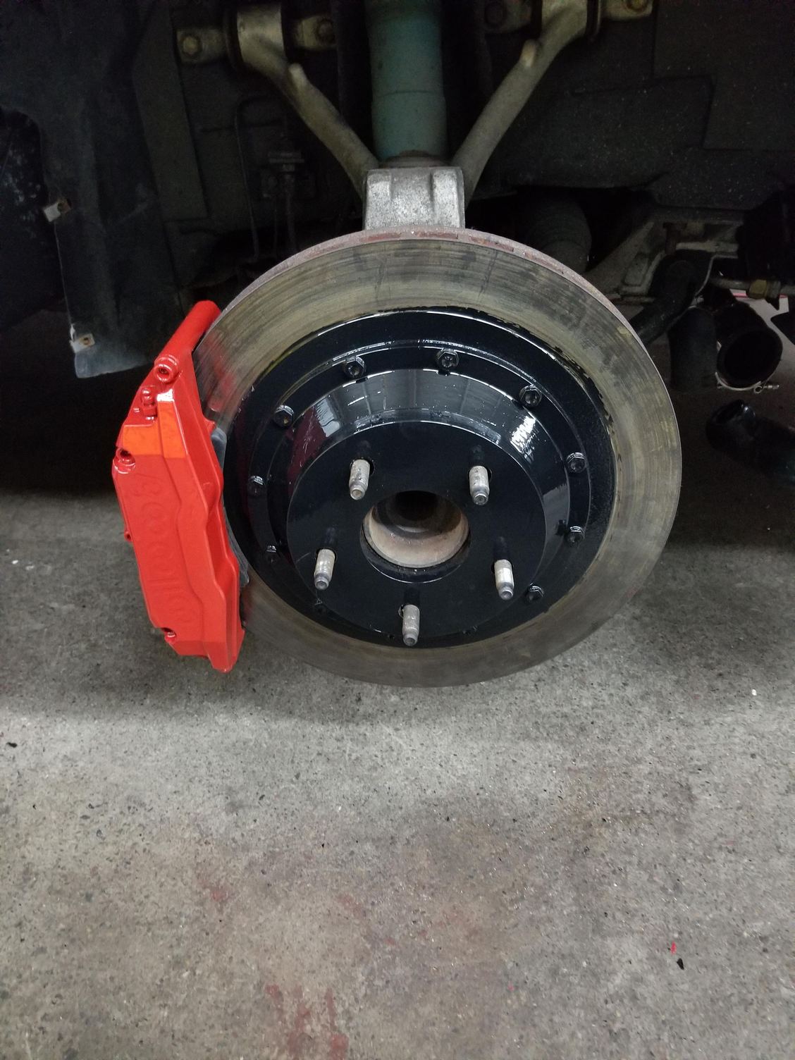

this is for my 99 c5 trying to see if i have the right offset. i do have the TPE front and rears fenders. i also have upgrade calipers,rotors and hats below is my measurement i made on my own. the biggest issue is going to be the hats on the rotors. front are 1 3/8 thick rears are 3/8 thick (i do have extended studs frt and rears) on the bottom of each pics (PDF file) and my hats thickness and below is the stock thickness.
front wheel offset +45
rears wheel offset +57
front brakes setup dont have a pic for the rears

they are on the PDF file on first thread. all the brake sizing
front rotors thick is 1 3/8 stock rotors hat is 19/64
rear rotors hats are 63/64 stocks are 1/4
ive been told i have wildwood calipers and pads and coleman rotors and unknown hats
i bought the vehicle with the brake upgrade. they are a c5 lug bolt pattern (i matched up a stock front and rear hub Assembly from the parts store) with extended studs
im looking to fit 19" wheels front 11" wide and rears 13" wide
i already purchased 285/30/19 tires up front.
they only wheels i have are aftermarket wheels. weld wheels and the front poked out. i have not tired to fit stock wheels on.

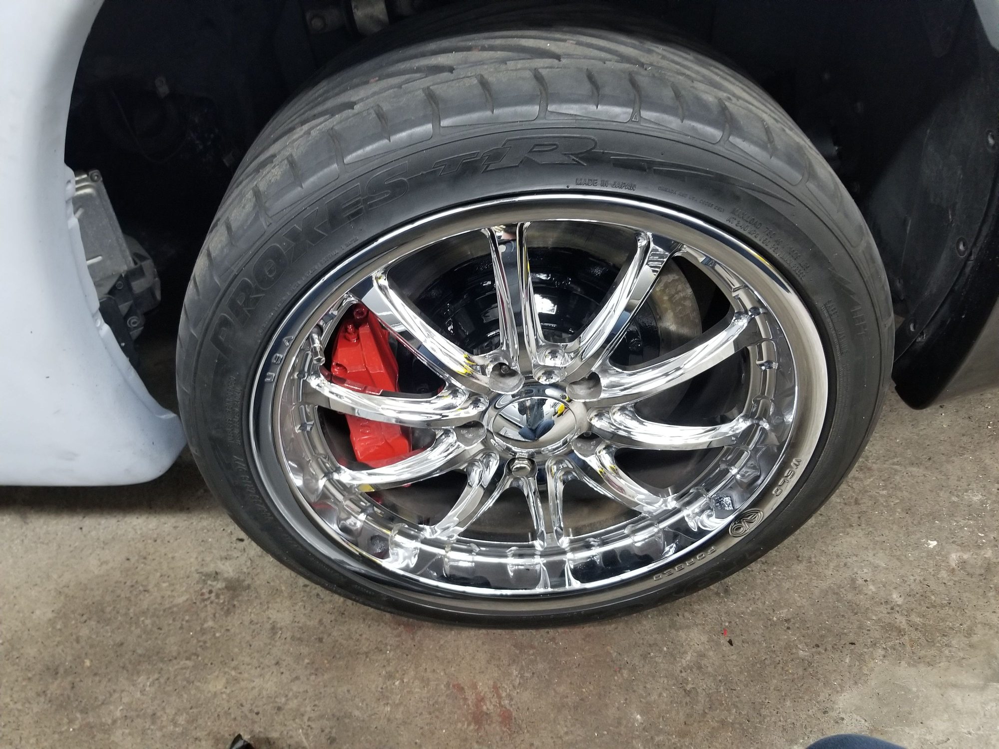

my back spacing is front 7 5/16" rears 8 3/8 these are weld wheels that are on my vehicle now.
my front wheels always poked out like a 1/2. i have 18" wheels idk about the width. also the fronts are very very close to hitting caliper and the spokes

Those calipers look like nothing I've ever seen and those hats, too. If it were my car, I would install brakes that I absolutely knew were for that car. It would greatly simplify things and probably cost you less, in the long run.
