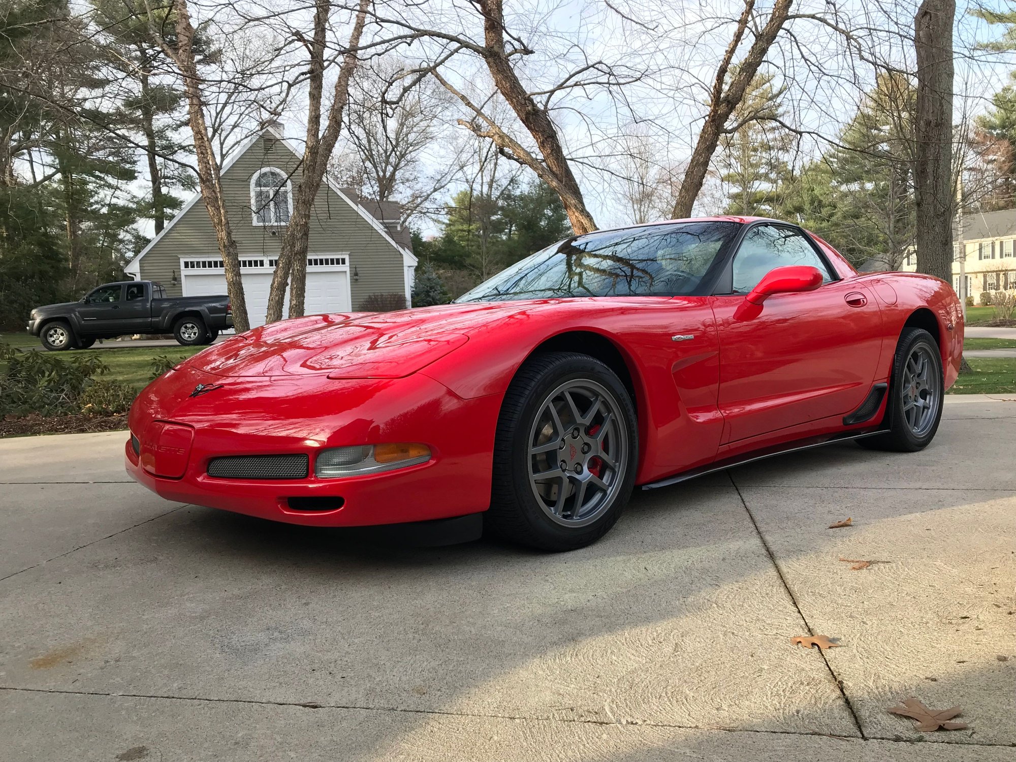

Next up......MALLETT 396 XMS wheels 18 all around... powder coated in glossy black. To be continued.

Did you have to modify them to make them fit on a c5?

No- C7 Carbon is the brand name- fit fine out of the box. Combination of rivets, screws and automotive tape.
The tape allows a single person to set the pieces then rivets and screws solidify the mounting.
Some people have relied on just tape as they are too squeamish to drill into the rocker but I chose the standard route per the manufacturer.

Looks great. Were they already painted? Are those wheels painted kind of a pewter color?

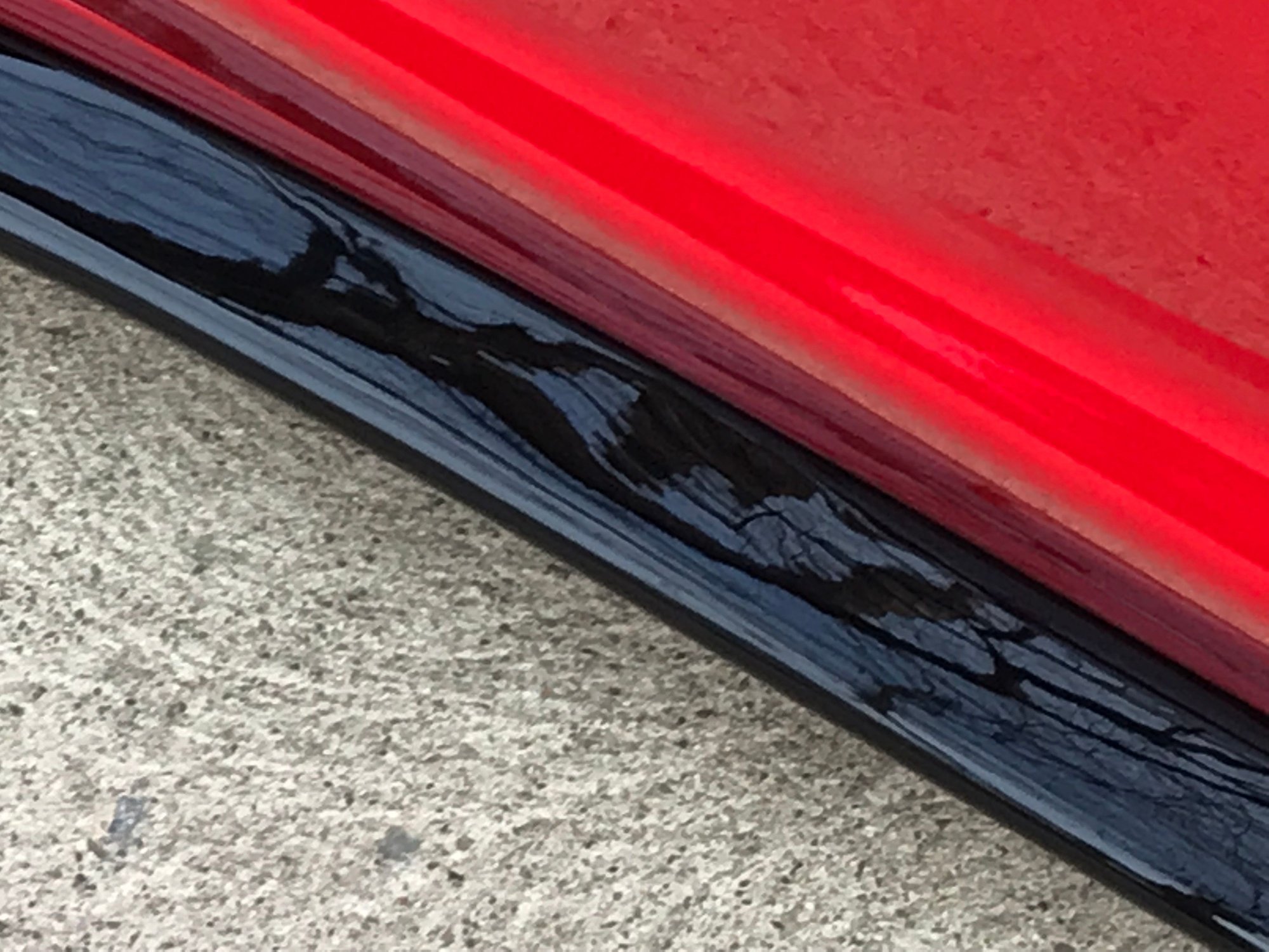

Yes. They were painted in glossy black- doesn’t look like there’s a clear on top to protect so I may get wrapped in protection film- may not depending on the price. They should be considered wear items like splitters and will suffer the effects of road debris. If they look damaged after a couple of years either wrap them or replace. With the mounting holes already drilled it should not be a big deal.
The wheels are the standard 2001 Alcoa cast factory painted in Argent Gray or Metallic Gray same as the other years with Speedlines. I have read they appear darker but I cannot comment- the pictures were taken near dusk so maybe that is the effect.

My Alcoa’s look darker because I don’t clean them as much as I should
sides look really nice

C7 Carbon shipped rivets for the job. They require drilling into the rocker an wheel opening. If I remember correctly there are like 12 per side. Make sure you have a great rivet tool that can handle the SS river- my HF cheapy didn’t cut it and I had to borrow a Snap-On from my brother. I used double sided tape to hold it in place and a couple of speed screws to make sure I was happy with the location. Then drill and rivet away. The first hole into my perfect Z was hard- after that there’s no looking back. Rivets are the way to go to ensure the best connection and safety. Best of luck- you will figure it out and it will be great. I did mine solo but a second set of hands would have made it easier.
