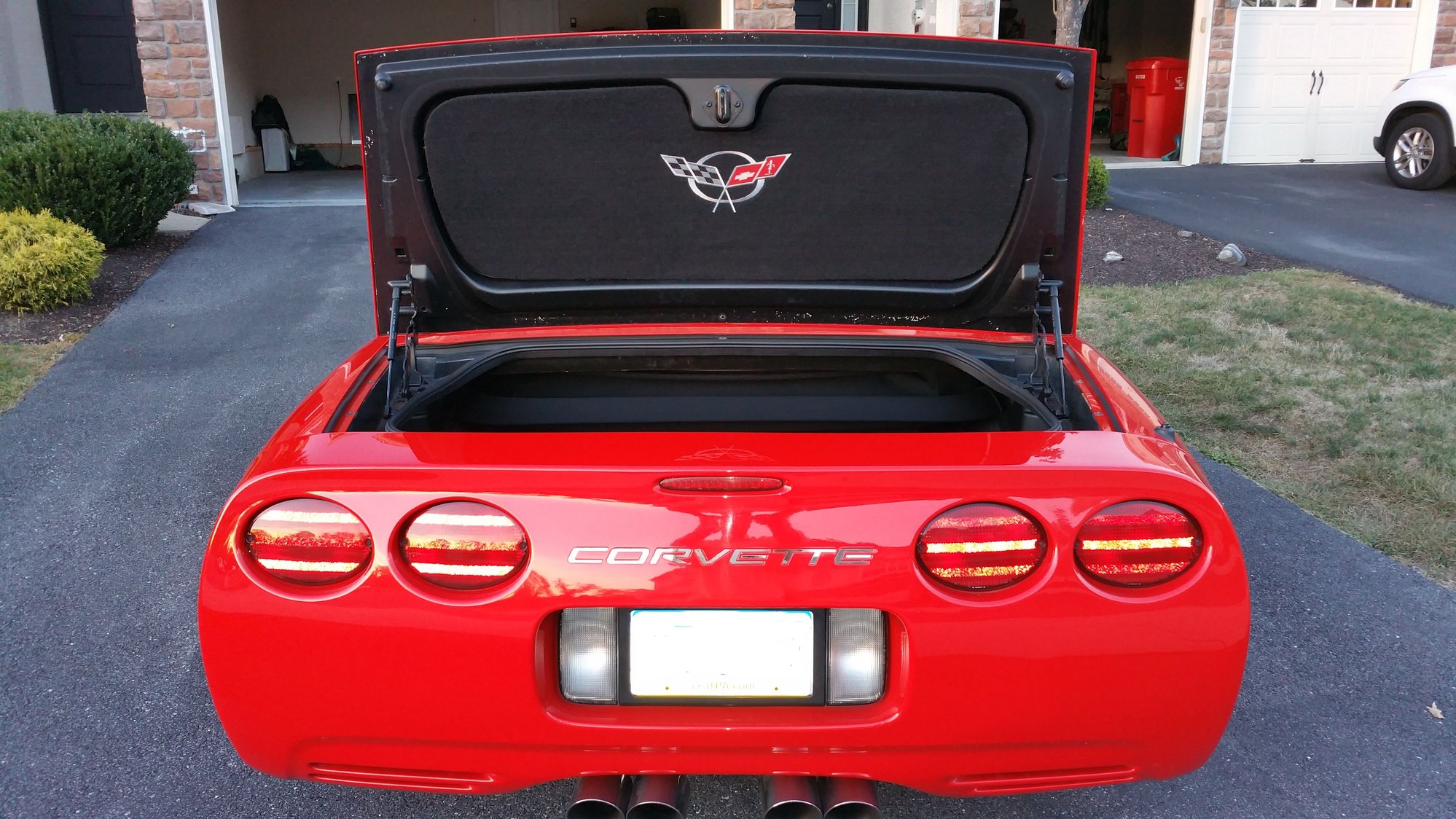

Here is my rear trunk liner... I bought heavy duty velcro with a 50lbs weight limit...when it gets that heavy duty, the adhesive is very strong and for the many years I owned the car, it never sagged or moved...and my car was only driven in the hot summer days...
I need to find some of that HD velcro because my liner is sagging in the middle, where its velcro has let go.
