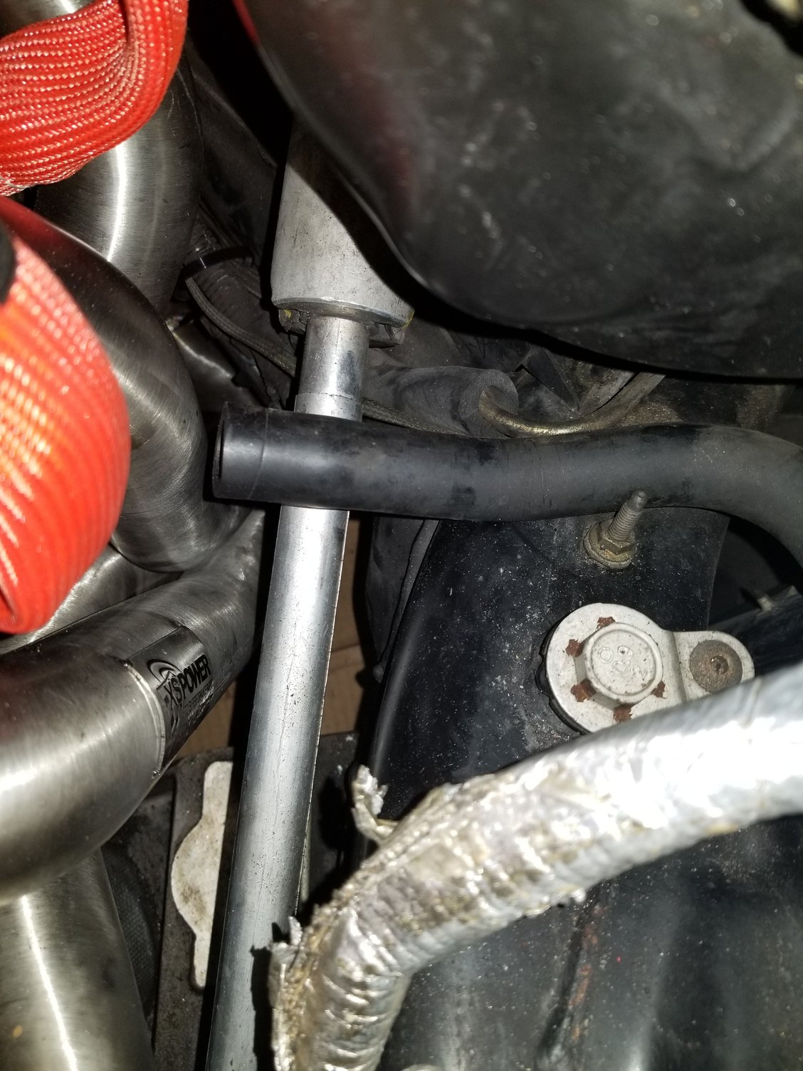

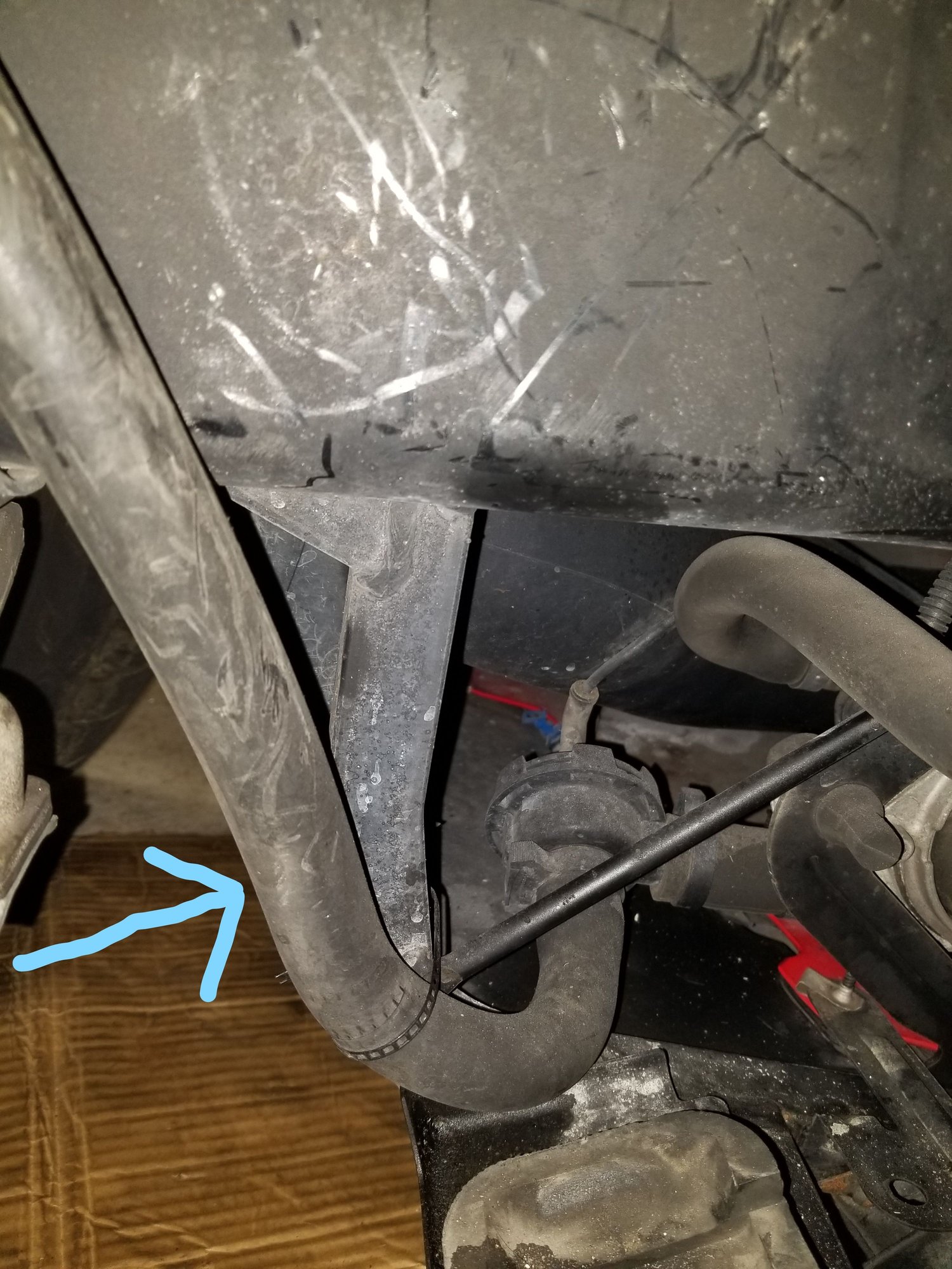

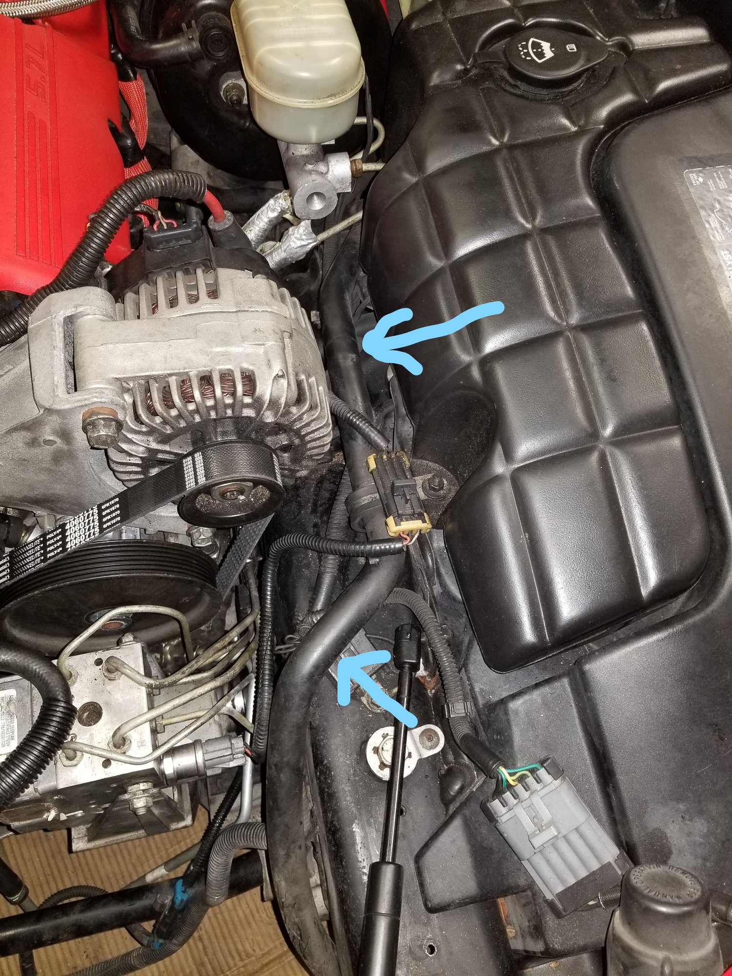

I've been working on a cam swap and was in the process of putting everything back together today when I came across this hose and cannot figure out where it goes. The open end is underneath the brake booster but I don't see a connector anywhere. The hose goes along the driver side of the car to the front but I'm not sure what it's for. Anyone know what it's supposed to connect to? I've looked all around the brake booster but don't see a connector.
Open end under brake booster
Front driver side

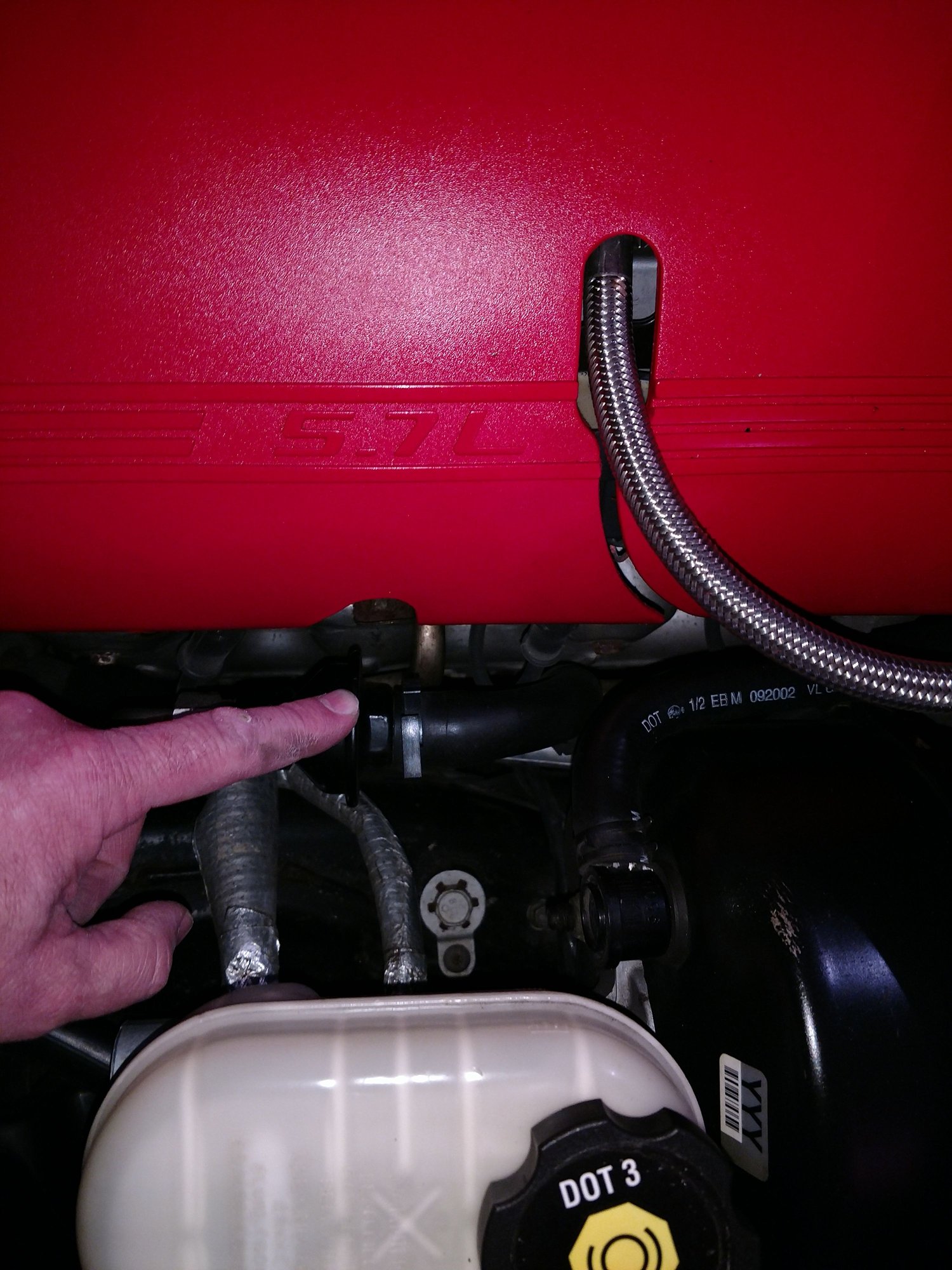

That tube is part of the AIR system. I've attached a picture of mine. If you follow the line I'm pointing to towards the firewall, there is a tee under the brake booster.

I'm not seeing the check valve in your picture. Could be someone deleted the AIR connection but didn't remove all of the plumbing or my eyes are too tired.

Looks like it goes to the air pump, so depending on the end it either goes to the exhaust manifold/header check valve, or the air intake post filter. If you got the race headers, they wont have a port for it.

Ok, I was thinking it may be part of the AIR system. It was removed by the previous owner and I guess I didn't see the hose until now. Thanks for the help.

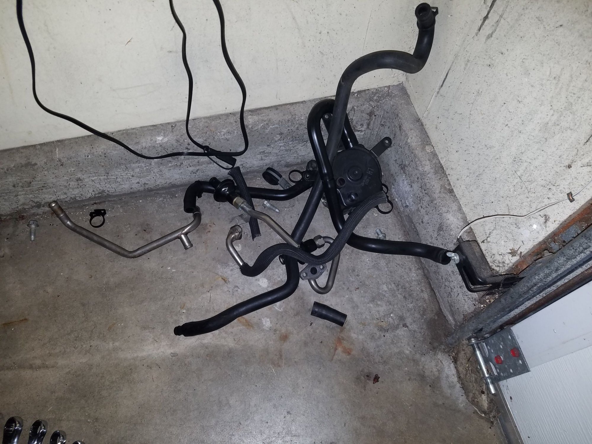

Thats what my air system looks like...a pile in a box.
