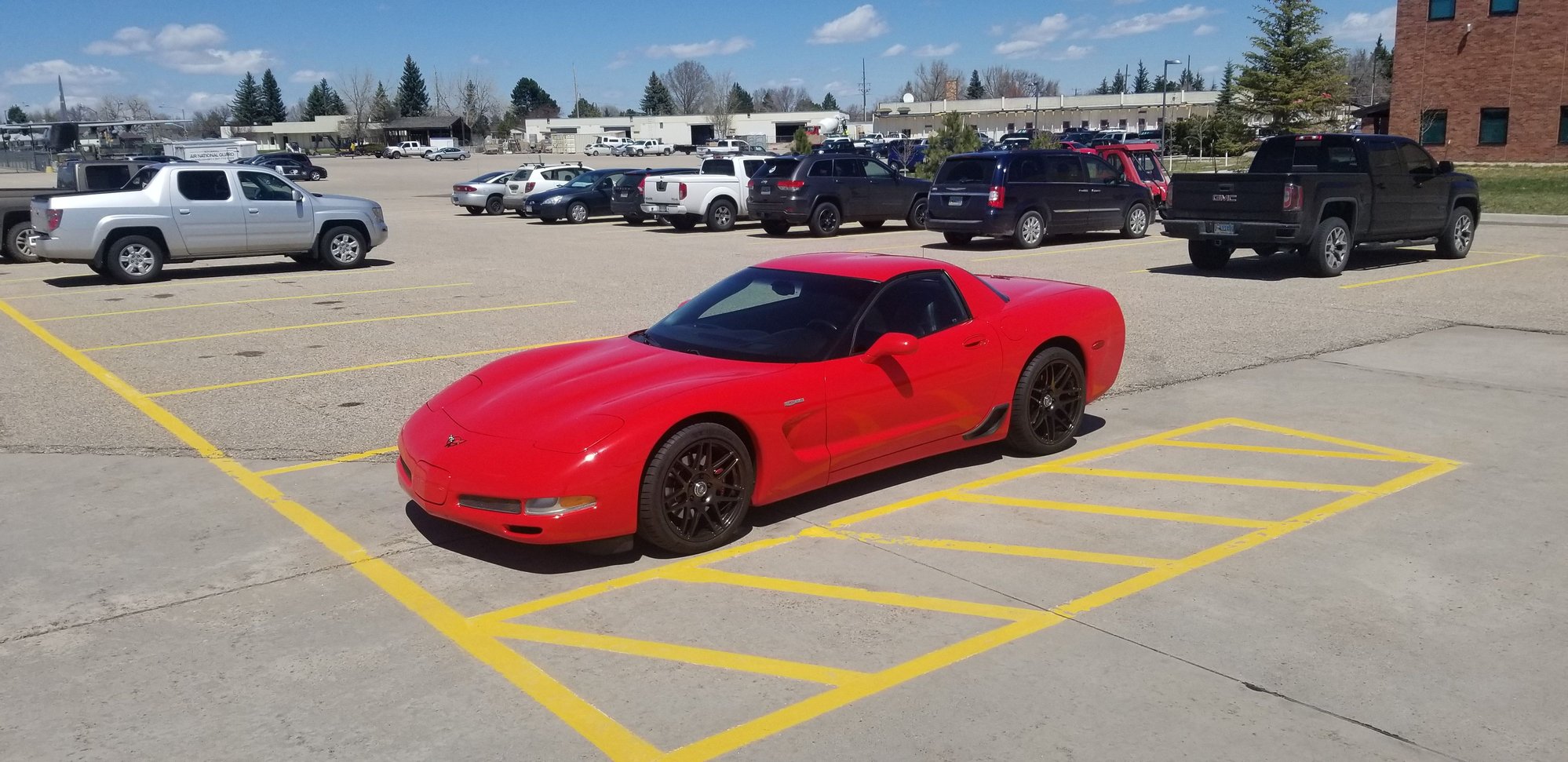

So, since I had no one to help, I cleaned up my engine and the intake really well, installed new knock sensors (GM) and harness, installed new FelPro intake gaskets, cleaned the ground on the back of the driver's side head, and closed up for the night. I'll post up tomorrow with results. In the meantime, enjoy a pic of the car I'm messing with.

Sweet car by the way!

Bummer dude, I was hoping to stay outta the bell for a while. Thanks for the compliments too!
