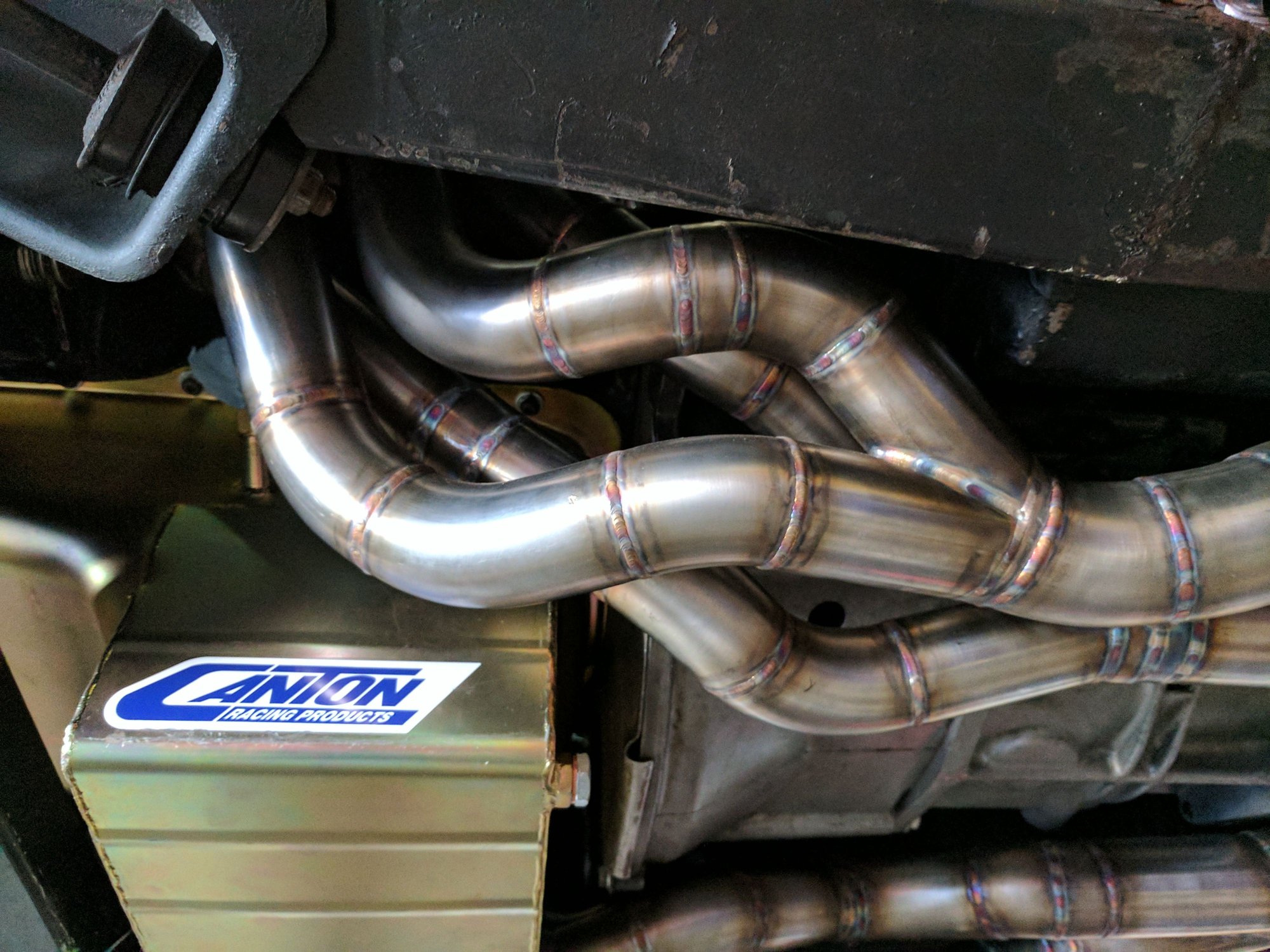

I had these custom built for my Datsun with a V8 swap, 4-2-1 + full exhaust with 3 resonators and a short muffler with pie cut tip... Paid around $2500 fab'd and installed.
$1500 for some mass manufactured headers? Thats nutty. They better friggin look as good or better than this!

Those are a work of art. Very impressive.
